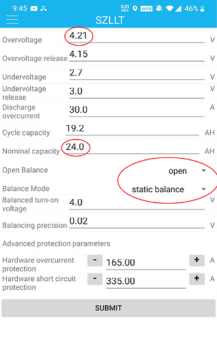

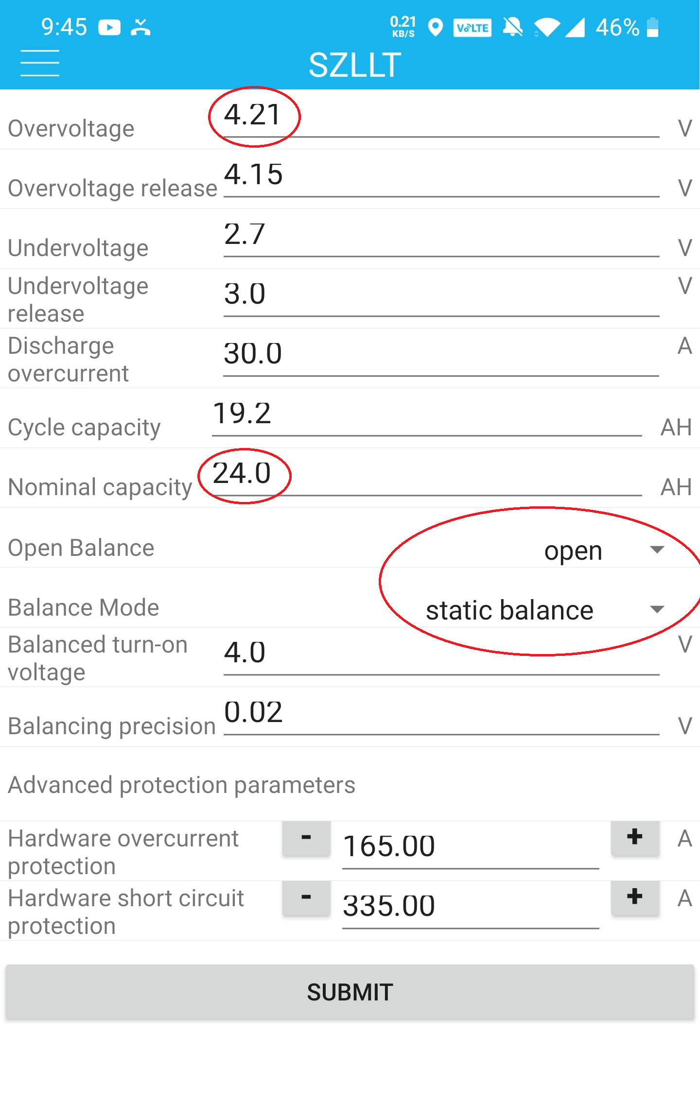

Do we have to calibrate the smart bms’?
mildly yes… mostly just basic inputs for charging… i noticed that all the low voltage cut off and stuff would be if you are using it for discharge as well, but since no “smart” person hahaah would those values dont really matter and can be left stock
a little yes, super easy.
i reduce the overvoltage figure a bit, it balances it down to 4.15v
nominal capacity is total AH, cycle capacity is 80% of nominal capacity.
change open + static balance.
can reduce balancing precision but do it at your own risk, i can get stuck in a balancing loop.
Thanks! So I want static balance and open, correct?
correct, means it’ll balance without the charger being on (i think)
Dope thanks :love_you_gesture:t3:

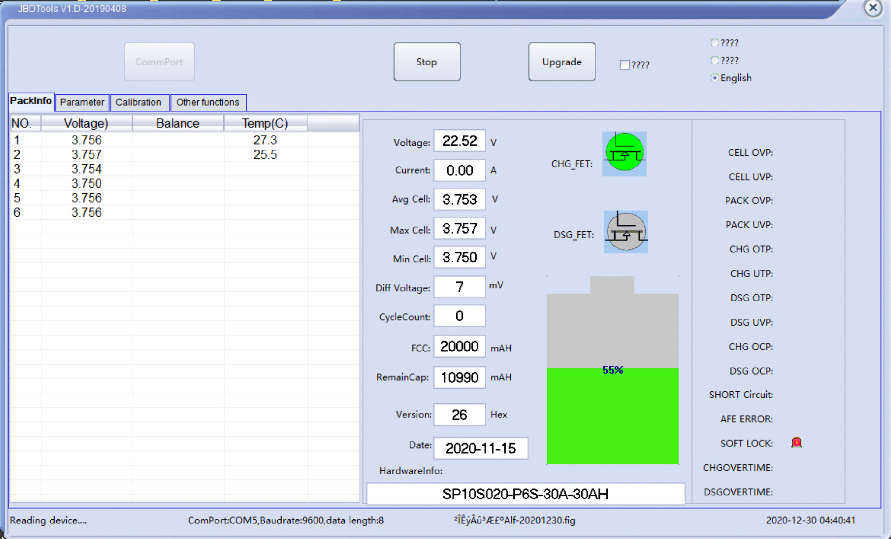

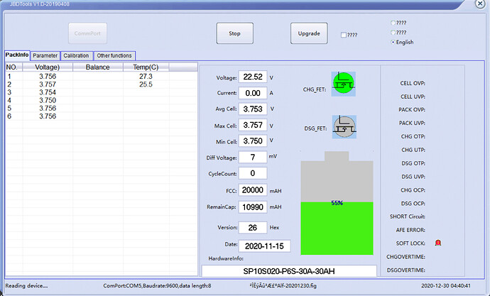

has anyone used a eswitch with these BMS?? I just hooked a momentary pushbutton but that doesn’t seem to work. Also the JBD tool from lithiumbatterypcb.com has ??? popping all over the place making it difficult to work with.
EDIT: Got it working.
