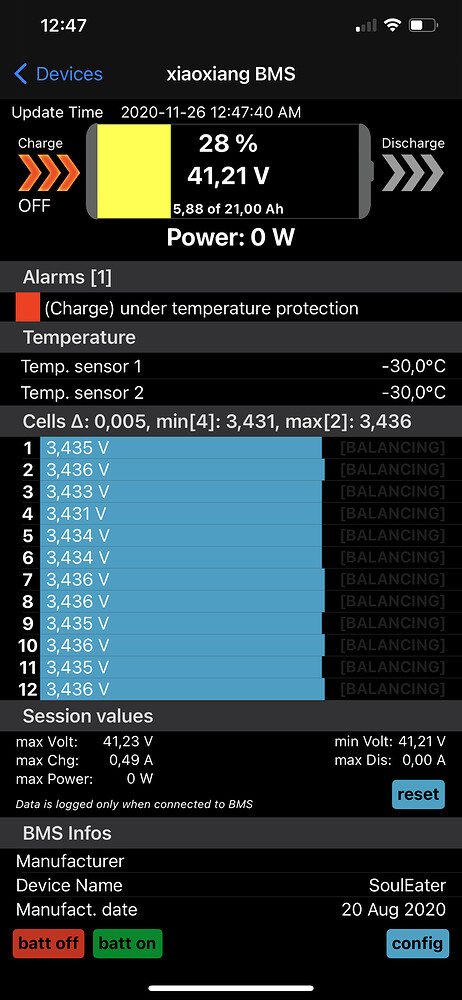

smart bms not charging
My bms won’t allow me to charge. The charger light even stays green. Everything is wired right. I even pressed the turn battery on button. So I’m seeking help. If there’s something I doing wrong
The BMS thinks its too cold and won’t allow the battery to charge. Do you have the temperature sensors plugged in? You could also change “charge under temp” to something like -100 so the temperature protection won’t get locked out like it is now.
Any chance you bumped the charging disabled feature? On these BMS you can turn off charging ability
Your temp sensors are not connected.
Ah. that too, don’t know how I missed that
I lost them
This should work even if they are not plugged in. You need the full paid version of the app to change the settings though.
I guess that is the one downside of the IOS app

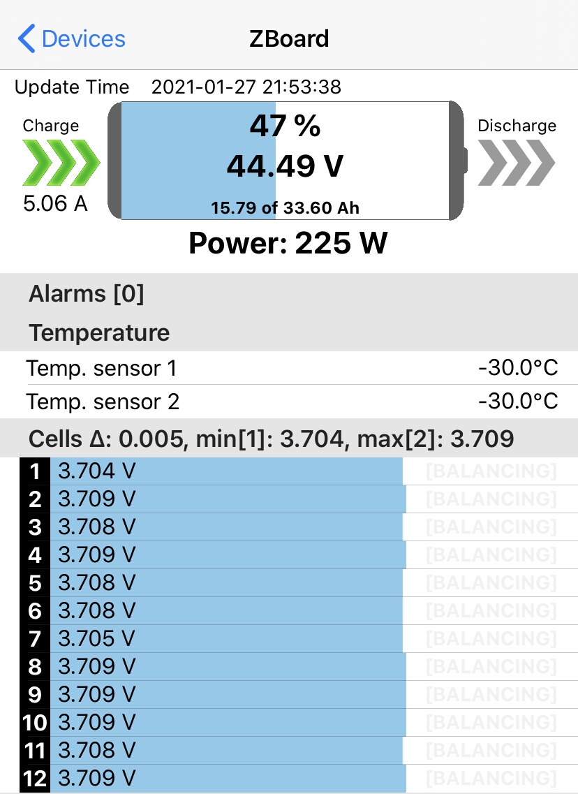

Interesting, have you tested this theory? I’ve wanted to ditch the temp sensors but once I ran into the not charging issue tossed out that idea.
Just tested it, -99 works.
Legit dude. Thanks for the tip!!!
