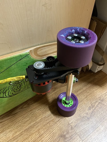

So I started this build off my making some adapters since the meepo battery has a female xt60. Made a female xt90 to a male xt60
Then I found this loopkey setup I had made from months ago

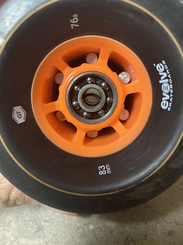

Already assembled the drivetrain but I need some new wheels, 83mm evolved are complete shit
Boardnamics press fit allows for no tracking on the drivetrain and his new precision mount is flawless.
It should be coming to the market soon, but this is one of the early prototypes. I fucked it up by forgetting to put a bearing and kinda messed it up but still works fine lol. New axles on the bn220’s rock, fuck shoulder bolts
Encountered a problem along the way while removing the screws from the precision clamp. One of the threads on the clamp became stuck and while trying to remove it, I broke the head of the screw. Now it’s stuck for good but doesn’t effect the mount itself since it fits through its slot.

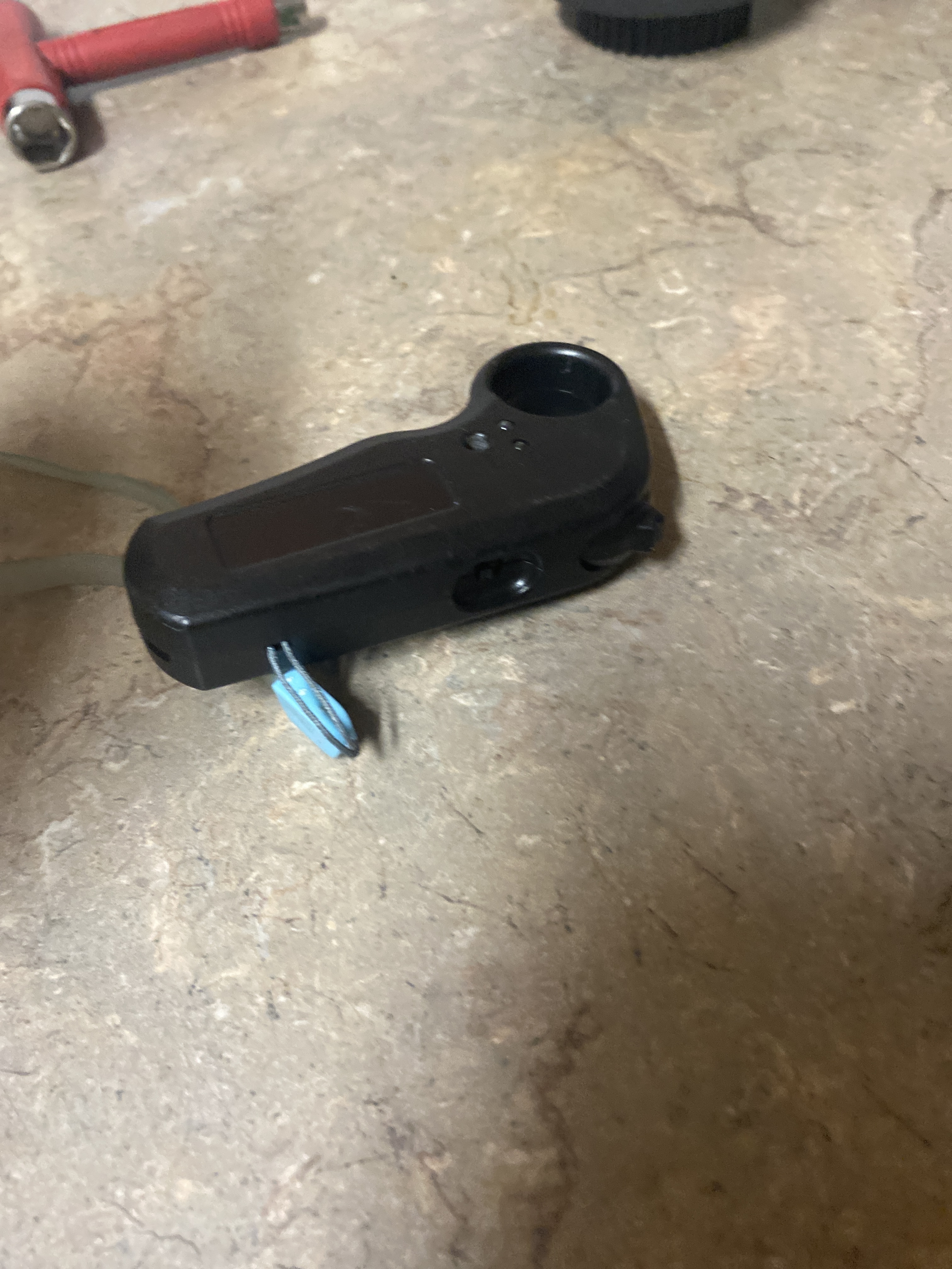

Still deciding on what remote to use as I don’t want to put my little brothers life up for grabs with this winning remote I got

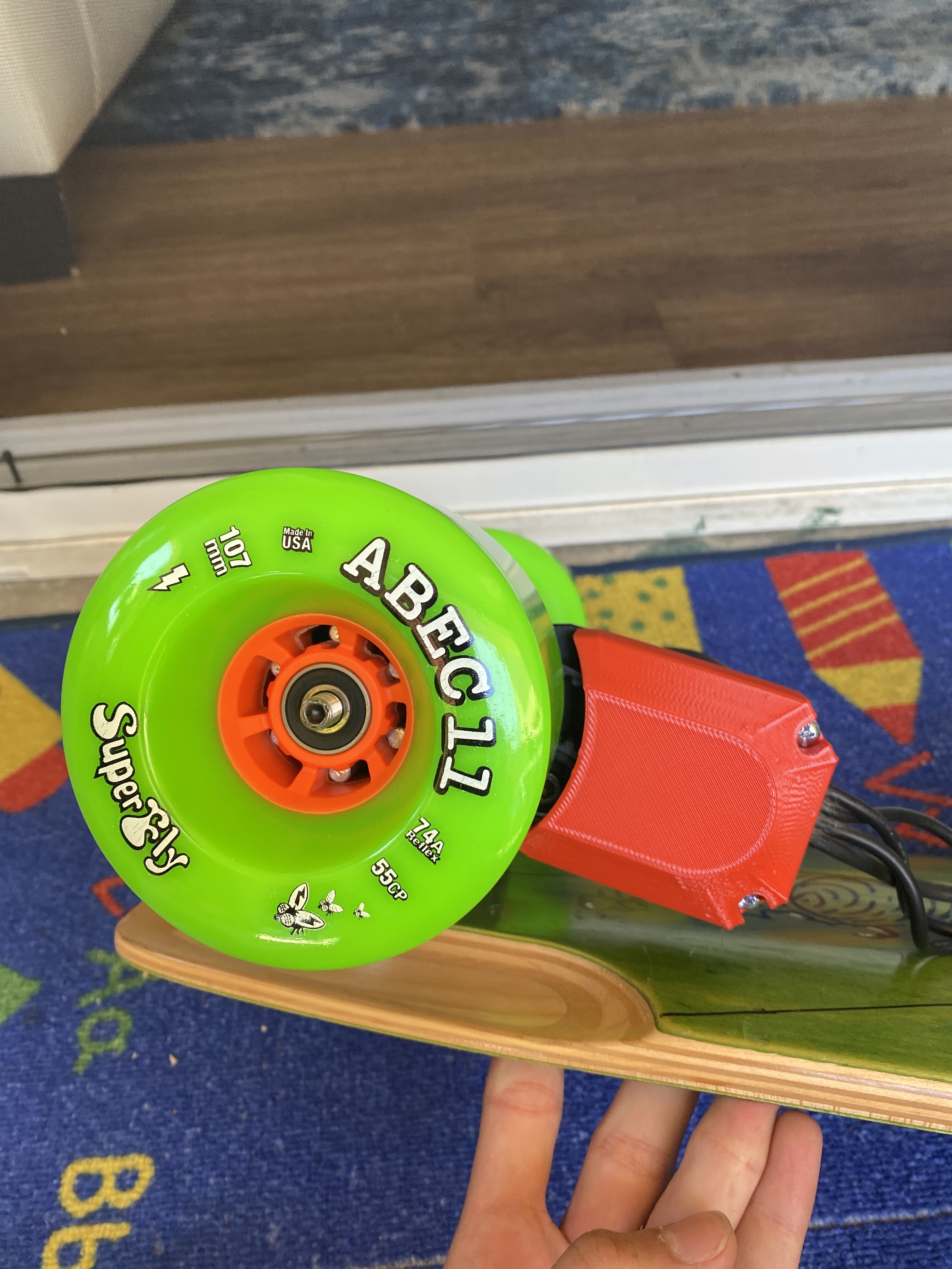

Other dilemma is I need a new set of wheels for this build. @Bobby is trying to hook me up with some evolve 107’s but he lost 1 wheel :joy:

Lol I have some 107’s I could have gave you and my mom literally just got home from shipping a package to san diego.
Post earlier next time.
Lmao, I’ll send you a pm haha

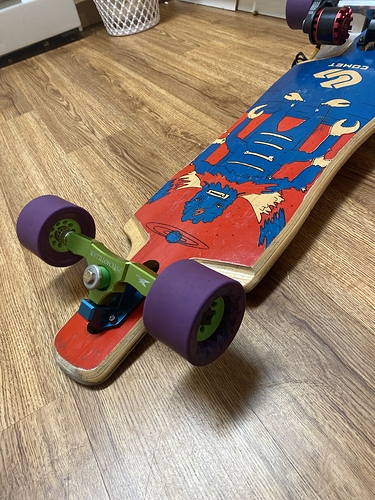

Ok, got settled on a deck. Found a comet fsm 2012 on offerup for $10!!! Decent condition too. Since I don’t have a enclosure, I decided to just use a steel it’s container.
Ok so I pretty much finished the build
I just need some risers and a new remote and it’s good to go!
Decided to top mount the battery for a lower ride. Bought 85mm purple caguamas for the board.
Probably going to switch out the mount since it’s a little to big for caliber style trucks, I put some adhesive Velcro to the truck for a tight fit with the Boardnamics truck
Also running a dickyho 40t pulley
Also waiting on my other enclosure, this tubberware container is temporary. Other enclosure should be coming in a few days🙂
Colors kind of clash tho
Finally bought the deck for this
Build is now very close to finished, I just need to buy some screws to secure the enclosure 100%

Here is the complete finished board
