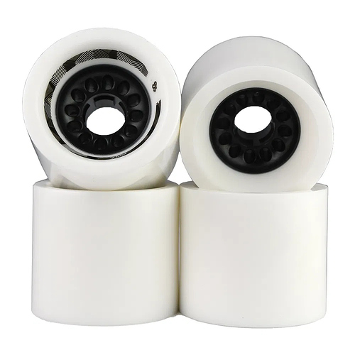

I bought this ones for the same purpose. Wanna compare them to purple Kegs.
nice… I am confused to the Duro rating though - on the website spec it says 88A, but on the wheel itself is 85A. Interesting to note that the harder the duro the cheaper the wheels are. if you manage to find Ahmyo Akashas, they are great for sliding if you can achieve the road clearance for the drives.
They are 85A. No regular ESK8 rider wants to ride such hard and small wheels. Those are just for science.
Those don’l look bad, a litte soft though.

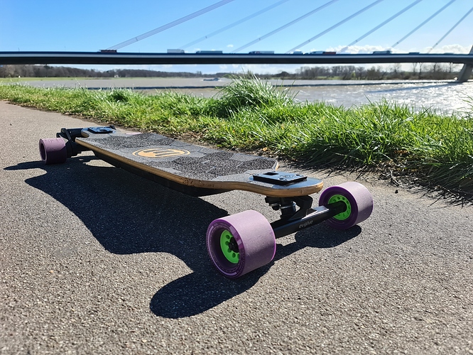

First I want to start with the 80mmx56mm squared lips 83a purple Kegels.
First thing I noticed is, that the wheels feel very soft for 83a. They grip way better than I thought they would. I thing this is because of the squared lips and the happy thane formula in general.
They are really comfortable for 80mm wheels. But this is not what I hoped to get. I was looking for a smooth sliding wheel and this is not the right one for that purpose, in my opinion. When you start sliding it, it gets rubbery instead of chalky. I think this is a great long distance push wheel, or a in general nice ESK8 wheel for mini boards, but for me it’s definitely not the best sliding wheel.

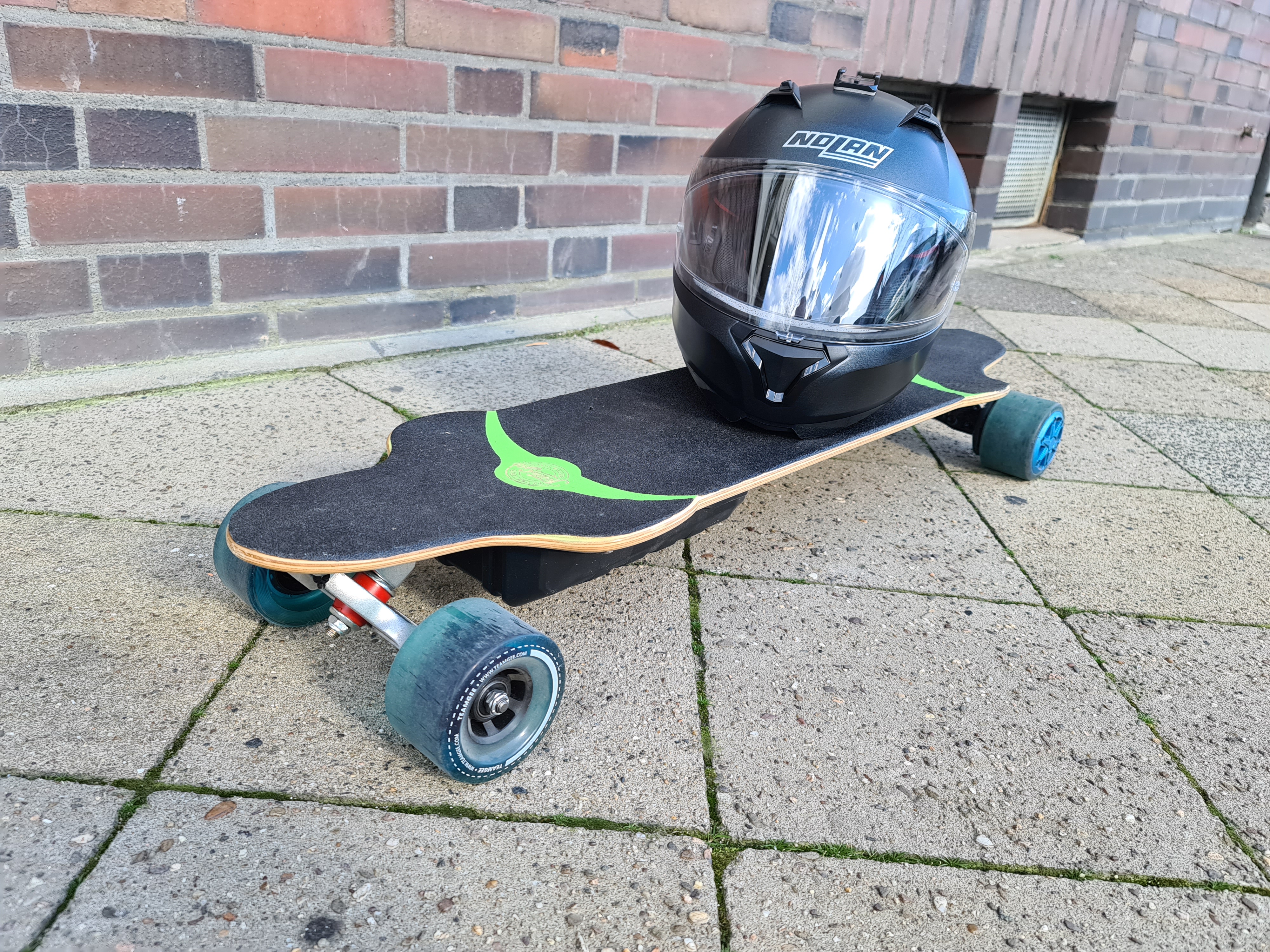

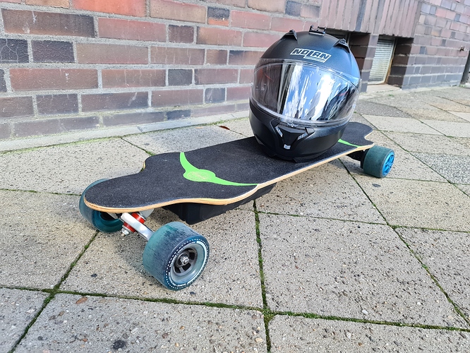

Next wheel is the 83mmx52mm 85a round lips SR.
That wheel is also surprisingly comfortable for a 85a wheel. It is significant harder than the Kegel but not much less comfortable, since it’s 3mm larger in diameter and it kind of flies over small obstacles.
Compared to the Kegel it’s almost as grippy, but much smoother to start a slide. it has a nice chalky feeling while sliding, thanks to the round lips and it is in general a nice looking and fun wheel to ride.

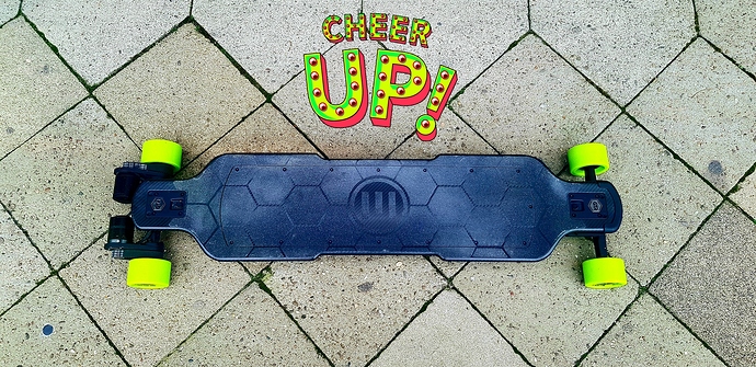

Last one is the new 97mmx56mm slightly rounded lips 76A Evolve/ABEC wheel.
The ride is not very comfortable for a 97mm 76a wheel.
When you squeeze it with your fingers it feels like a normal 76A wheel, but when you ride it, it feels and sounds a little bit harder. Maybe this is, because they changed to a harder core, but otherwise the batches before were also not very comfortable for such big and soft wheels. The grip is really good though and in my opinion slightly better the older black batches.
The slides were so far the smoothest ones. Very controllable and forgiving. Not as playful as the 83mm SR wheels on the same deck, but smoother do ride and slide.
