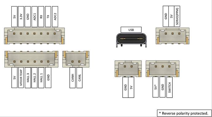

Went to plug my shiny new Minnie into my shiny new SKP solo and… The CANbus ports only have CANH and CANL, no 5v or ground. Do I just split out and pull 5v from a UART port?
Also, is there a better pinout diagram for this thing? The text on the casing is almost unreadable.
there’s a dedicated 5v/ground plug
YAY I CAN READ THE PINOUT!!
Also yay, just an easy JST swap from a 4-pin to 2 2-pins.
For CAN, should I plug the Minnie into both Solos, or should I splice out the CANbus to one CAN port on the Minnie?
Can the Minnie act as the CAN bridge while providing telemetry for both units?
i’d just splice the can cable
I think the two CAN ports on the minnie are designed for exactly that.
There are two CAN ports that allow daisy chaining
Meh, already spliced it.
also works. :slight_smile: here’s a diagram that says: “yeah that’s right too”. :stuck_out_tongue:
Looking on the PCB, it’s wired together inside the Minnie anyway.
