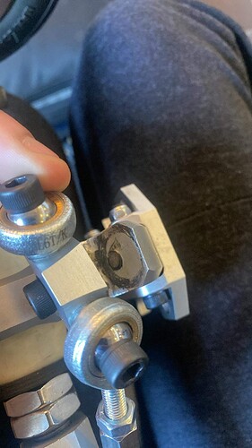

Broke my trucks, same failure point each time, but they were both from slamming into stationary objects at high speed. First time was back home running into a pole which broke my motor loose and messed up some gears. The failure point has already been addressed in the second and future iterations but it still sucks…Second time i broke the truck was here in Vegas changing input settings and the board. The board started pulsing the throttle and took off after changing the control type. Fortunately it was in a building and not on the street but it bent my truck bolts and sheared another on the truck. Tried to remove that sheared bolt and it didn’t work out so we were screwed. I damn near threw some nexus trucks on the front just so I could get the board working enough to go on the group rides.
MASSIVE shoutout to MBoards and crew.
They happened to have a set of gen 2 Newbee hangars that they’re letting me borrow until I get that front truck from Stooge which I’ll have whenever he arrives in Vegas. (Yes I’ll be running one Stooge and one Newbee truck whenever I remove that hammock from MBoards) They also let me use their shop/tools to work on the trucks and get the board back up and running. Sidewinder racing in this event was made entirely possible by them.
After this second crash, the board is gonna be getting the full short rod truck setup from Stooge and I’ll be switching back to good ol belt drive which also means more testing of the thane belts!!!

@janpom @rpasichnyk I had my board ghost into a wall and the Megan has been acting up ever since. I thought it was a loose cable but they both seem to be fine. The screen cuts to white randomly and then has to reset or will sometimes be stuck on the white screen till I restart my board. Any idea what could possibly be happening?
Does that happen randomly or upon hard acceleration? I have heard of people having a voltage drop on the ESC’s 5V rail as high currents are pulled.
i’m pretty sure it wasn’t just in hard pulls. probably won’t mess with it till i get home but i’ll put it in the other uart port and see if there are any changes
it just happened not too long ago and it happened right after a hard pull
You might want to try adding a small capacitor to the 5v rail.
Some of the first gen little foccers greatly benefitted from a small cap
how would i go about that?
I ordered the capacitor for my board from makers pev. It’s just a little cap with a 2pin jst that you plug into the 5v on the vesc.
can you go into more detail on how exactly you did it?
I’ll see if i have a pic of the cap when i get home from work
I was about to make the same suggestion.
The capacitor need to be connected in parallel with Megan, i.e. solder one leg to 5V and the other leg to GND.
