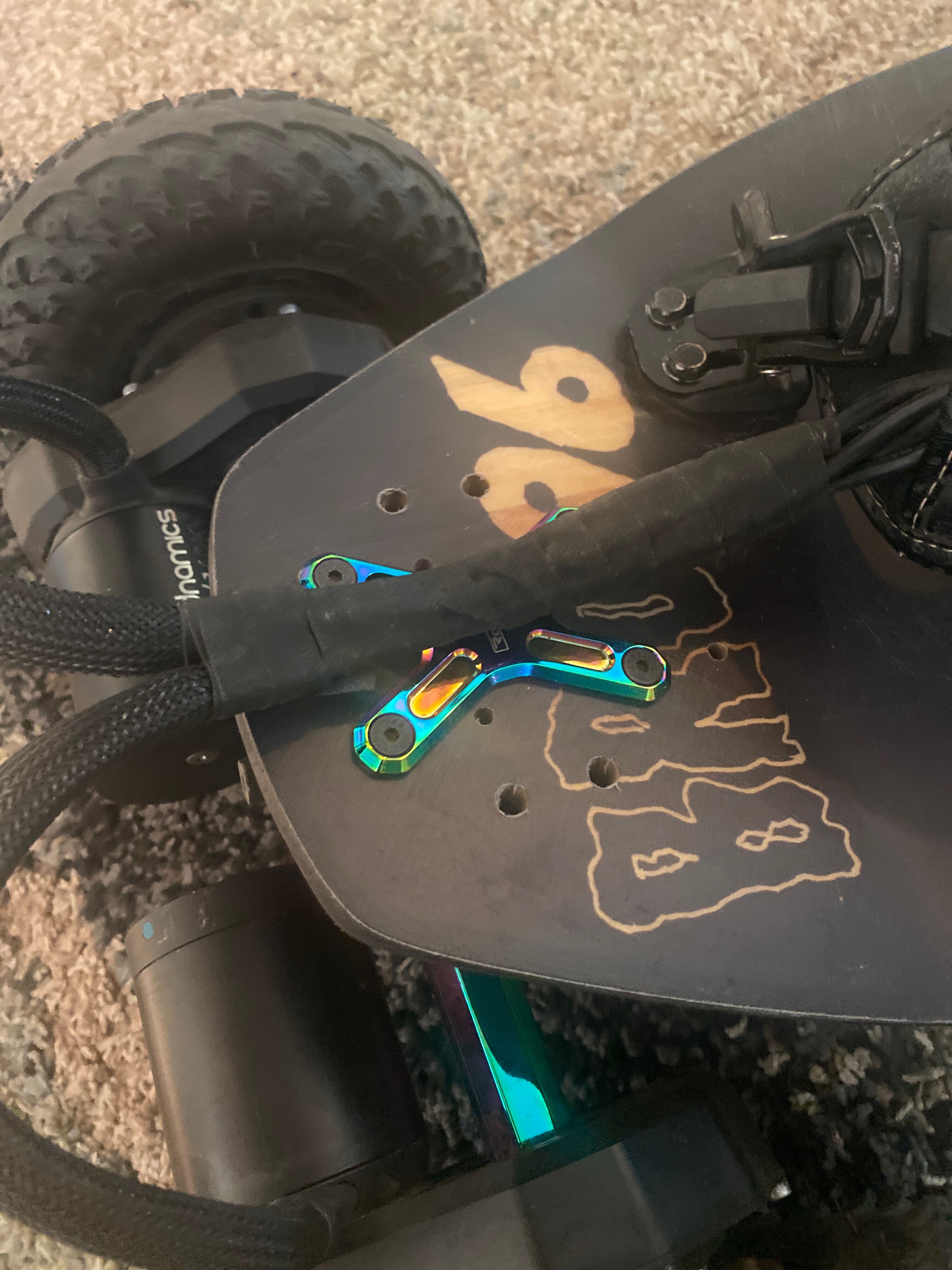

WIP :joy: I’m still new to cad and I am having a hell of a time getting a riser to match up with @Tony_Stark x plates the way I want… but practice makes perfect.

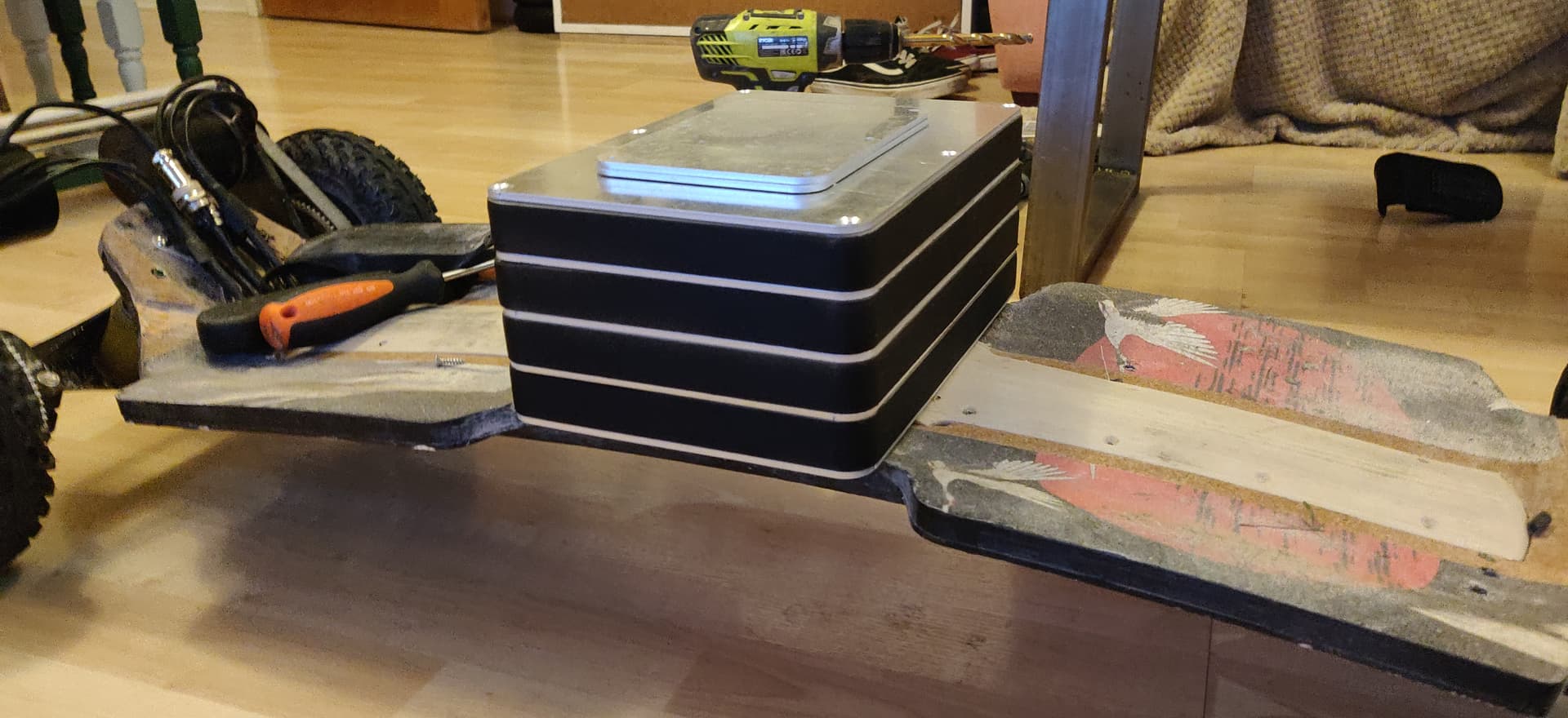

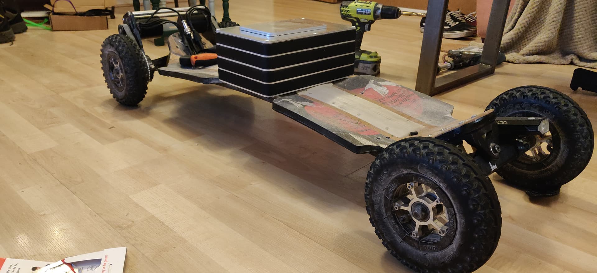

Working on a top mount enclosure, 3d printed+aluminium
Can’t tell the scale, but is this for ESC and stuff only or battery?
Battery and esc on top

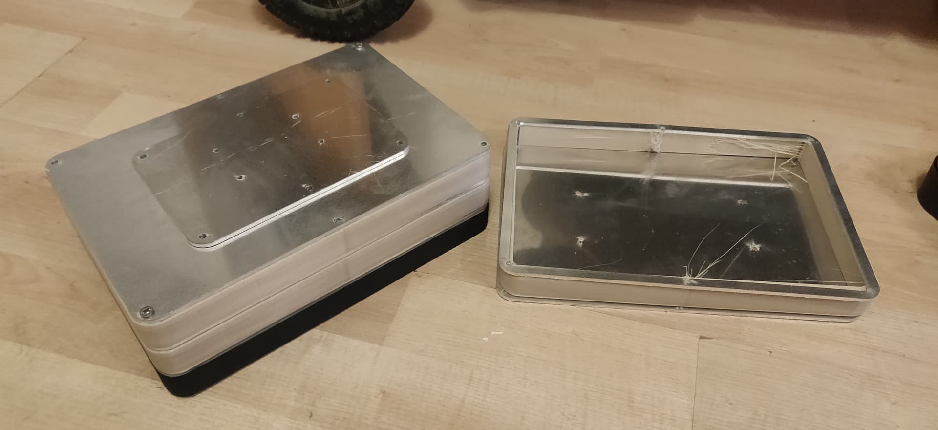

What do you guys think of this?
I’m printing the top section where the esc will be, those smaller plates at the top are 2 pieces of 3mm drilled for the DV6 mounting holes, to act as heatsink
Looks like a very interesting enclosure. What’s going on inside?
Looks kinda like a building :face_with_raised_eyebrow::+1:
Like a data center
We do it like this
You mean you buy them like this :rofl:
Jokes aside, I enjoy experimenting and trying things out, I have a hard case on my shelves, but well done for the choice of enclosure for your boards :+1:
At the moment I’m renting out to a Irs scammers operation :rofl:
