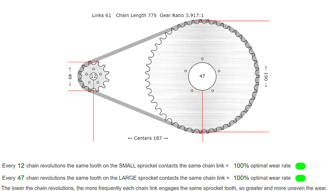

In industry , to have long chain life, motor sprocket should have odd number of tooths and wheel sprocket even number of tooths. Reason is to have equal abrasion for complet setup. I do not want to put all rules here, You can check Your gear ratio here: ⚡Chain and Sprocket Calculator | RPM and Chain Speeds

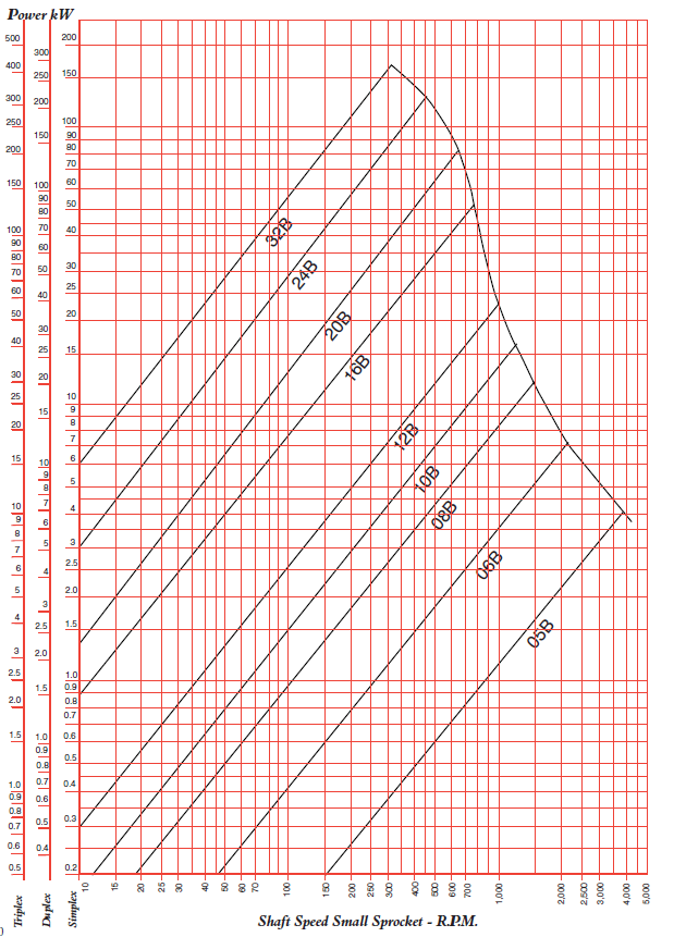

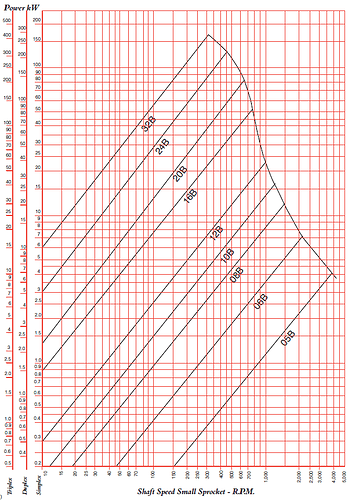

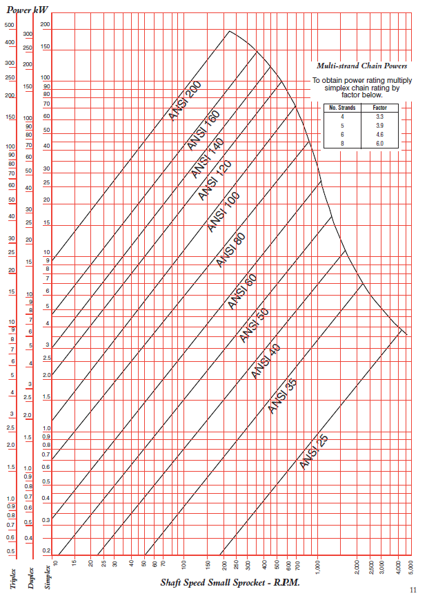

Iam already made few of calculation. I would like to use motor Flipsky 6374 140kv 3,5kW. This motor have max. torque 8N/m. My targer was to use ASA25H chain becouse of small pitch, unfortenatly with this motor Iam slighly cross safety border line. So I must choose B06 or ASA35. Iam from Europe so B06 is for me most avalible. If You are not able calculate it, You can use following pictures. It looks for me also usefull.
and
Next point is the maintenance. Chain shoul be time to time greased and in case of any mechanical damage should be replaced. Based on Czech or Slovak standard should be replaced after 2% of extension ,according EU standard it is after 3% extension. I mean this is very important unfortenatly I never saw this on any Youtube builds where guis are using chain from Alixpres without any strength tension value introduced by seller. I would say ,it can be little risky.

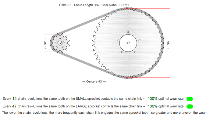

Can I achieve the same result if it’s the other way around?
I mean my motor sprocket is 14t even and 65t odd for the wheel.
My other board have 12t by 47t.

It is general rules, to be honest I have nothing to compare how big influence have this rules on lifecycle, Mainly is inportant to avoid thath both sprocket will have even number of tooths or both will have odd number of tooths. But also it exist combination which will works also with it. Anvay according attached link on calculator, Your nombers will worrk great. Iam not sure what is your axial distance, but it should be ok. As Iam wrote this is theory from industry.
Sorry. This is correct. Iam used different chain typ for first calculation. It have just dimensional ipact :slight_smile:
