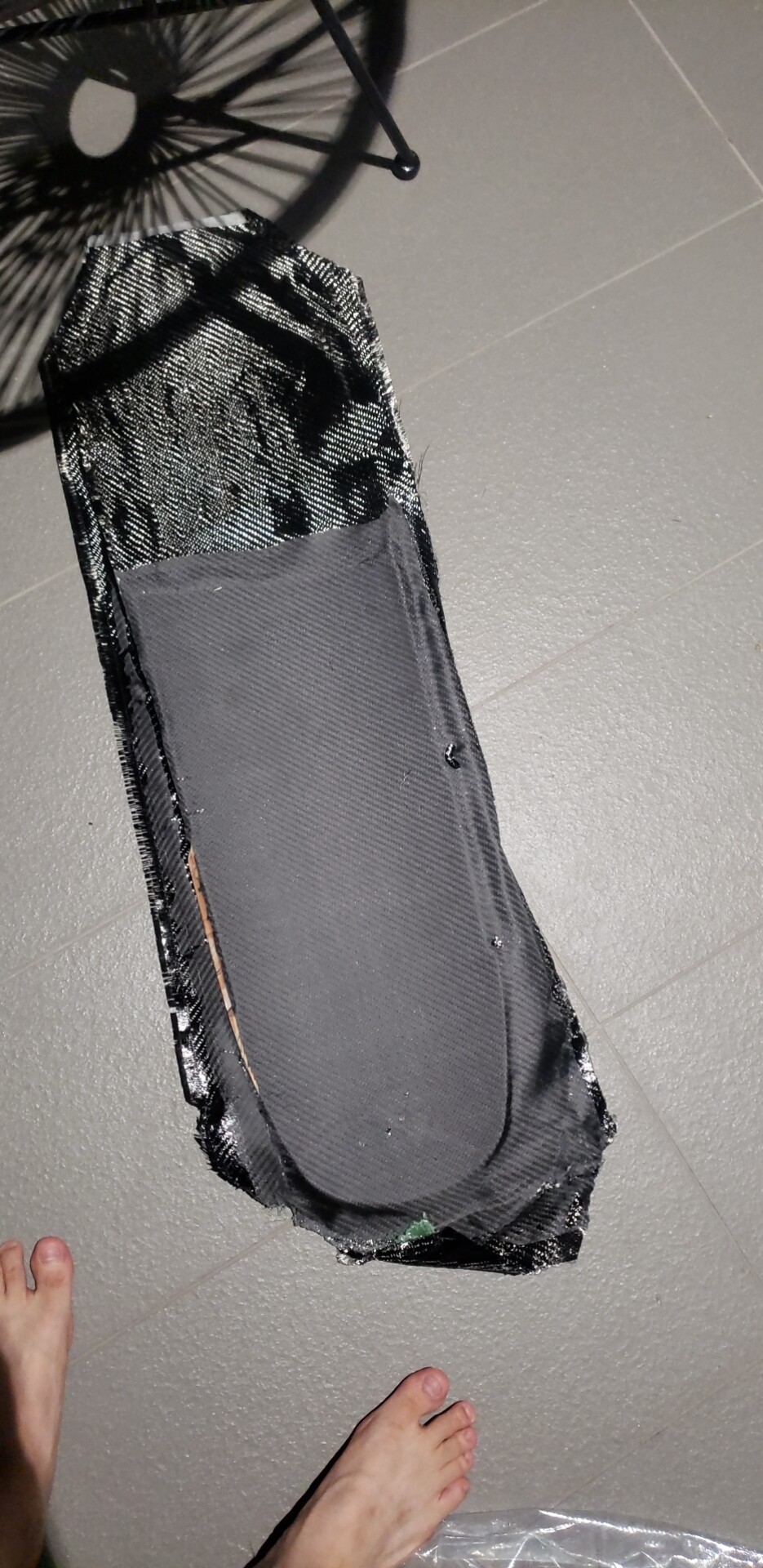

after polished deck, decide try use carbon fiber infusions to skinning the deck.
did two attempts
it go well at beginning
but I screwed up later, realized i need change infusions ports, resins only can through half…

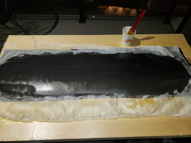

Here is my plan, make a little aero kit for the deck & esc will be stick tail of the deck.
Did both side carbon skinning after.
here is the step I skinning the deck (without vacuuming)
1:brush first layer of resin first
2: gently lay out the carbon fiber cloth
3: pouring another layer resin
4: apply peelpl (ensure it been rolled smooth & no bubbles)
5: put a layer of tissues for absorb extra resins
6: add up a layer of vacuum flims, press the flims gently ensure tissue absorbing.

That shit happened to me too, except my stupid second hand vacuum pump failed. wet layup was the way to go for me as well

Shoulda bagged the wet layup?
Not much more effort
I’m ran out the seal tape, wasted too much

really like the rear foot check moulds, hold my feet really well.
This is looking mental.
What’s going on under your back foot? Judging by the last two photos, I’d be amazed if that was holding your foot really well.

Oooh, did you add concave pads to it ? That looks dope
