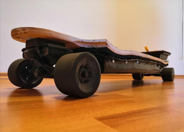

The “craigslist board” I bought off a guy online, single torqueboards hub motor on an original enertion space cell enclosure, 10s3p on 25r’s with a nano remote. Purple board is just a pusher.
Updated Maestro with dual motors and new grip, also new thermoglass maestro deck since the bamboo snapped.

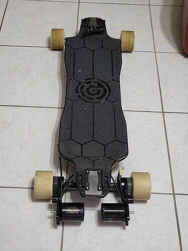

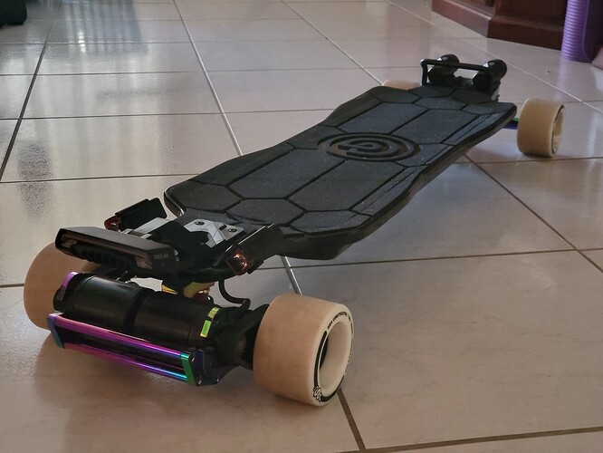

Oh god, this one is gonna be interesting, and make me look stupid. It’s a long shot from my first boards (Ride1up hub motor board, and a handful of boosted boards).
I bought an Ownboard zeus pro after my eovan GTS carbon pro’s charging port caught on fire and blew the BMS. Yes, that recently released board that’s only been out for a couple months at this point. Preordered it on release day. I really didn’t need much encouragement lol.
Rode it for a few weeks while i waited for my classes to finish, then the instant summer started, i tore it down and got to work.
Immediately ordered a spintend 75V VESC to drop in, preordered Radium 6485 motors, and BN270 hangers with adjustable baseplates because the stock split angle TKP’s are kinda meh to me. Stable, sure, but nowhere near carvy enough at low-mid speeds.
Managed to get the BN270’s installed and working, but oh, guess what - Can’t use the stock motors since they need repinning and i’m lazy, plus they have worse pulleys. Ordered a set of flipsky 6384 motors to use in the meantime while i wait for my radium preorder.
After that, i got around to modifying the spintend VESC. Decided that i’d use all my knowledge working with custom gaming PC builds and replace the stock thermal pads with some nice ones. Tore down the unit and replaced the stock pads.
Next came installing the spintend VESC, but guess what - zeus pro enclosure doesn’t fit it without heavy modification. There’s also not enough room for the spintend power button, because it’s longer than the stock one. Got lazy, decided not to go through with my plan for cutting the deck, dropping the VESC down and making a new mounting plate. Now i need a new deck and enclosure!
Ordered a boundmotor octopus deck and enclosure. Great, now everything fits. Had to modify the front wire routing panel to fit the spintend power button, and make a custom JST 3 pin extension cable to connect the power button from the front all the way to the VESC in the rear, same with the charging port.
So in the end, what do I have? Well, it’s a mishmash of a bunch of different parts and is now an entirely different board from what i was originally planning on having, but hey, i wanted to eventually build in this deck and shove a 16S6P in it, so i’m a bit closer to that goal atleast. Part list below (and better pics eventually, when i finish).
Boundmotor Octopus Deck, enclosure.
BN 270 hangers, 10-8 stepped axles. I need to get another set of the BN270’s with 10mm straight axles for my pneumatics.
BN adjustable baseplates.
BN Precision XL motor mounts.
BN M1AT gear drives (still need to try these out, but i’m lazy).
Spintend Ubox V2 75V.
Ownboard Zeus Pro 13S4P P42A battery. Too lazy to upgrade to a 16S6P, and also too broke.
Newbee Esk8 footstop x2. Because i dont like being thrown off my board, but i also dont like being thrown with my board.
Shredlights SL1000 x2, SLR1 x2. I also have a handful of SL300’s, but for now this is enough.
Random assortment of custom lasercut aluminum truck risers. Thanks sendcutsend, i spent 50 bucks for a sour patch kids and they sent me some free lasercut stuff!
Backfire Hammer spoiler. Gotta have downforce, or something right? Jokes aside, it works as a carry handle and i’m planning on putting a third brake light on there actually connected to the VESC.
A veritable assortment of many different wheels, not even accounting for all my different pneumatics.
A bunch of incredibly overkill, way too expensive titanium hardware. Yes, almost every nut and bolt on this board is either titanium or stainless steel. I even bought titanium bushing cups.
Zealous ceramic bearings. Woo, fancy bearings that don’t cost 30 bucks apiece, but rather 30 bucks for a set.

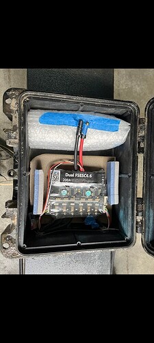

Wat dis
looks like a PCB fuse? the hell
This, it’s for “protection your vesc” so sacrifice the rider to save the electronics type thing
Parallel fuses give me heeby jeebies
Yeah samezies
Its an inline fuse between battery and VESC. Ill likely remove it, just had it in for the initial boot incase something decided to try and pop.
I would take that out, I third that. Even if you wanted a fuse there, I also don’t like parallel fuses.

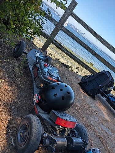

BoB has been through many changes but the core remains the same.
Original build in 220 BN / M1 straight cuts and tb110s done just in time for Halloween ride last year
Tb130s for a lil bit till delammed
Bn 270s and bergs
Swapped to 3link up front
Swapped to SavageTKP👌
Bent axel from 37mph into a curb
Added a 12s4p parallel pack and swapped back to 3link till I get an axel for my tkp
Added a riptide footstop at some point :ok_hand:, really underrated
I have 1700mi on this board since its birth. Really has given me very minimal problems. Did 50mi last night romping down to/in/back from the city last night. Stoked to not have to drive to most rides.

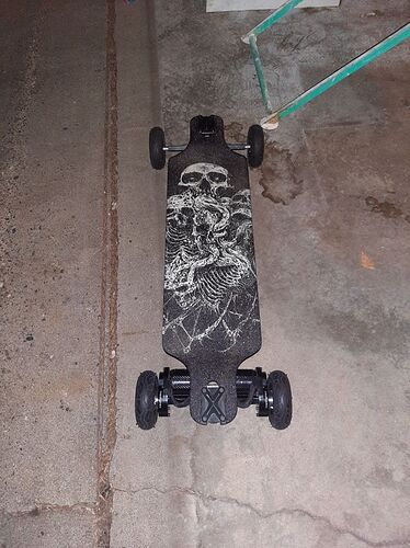

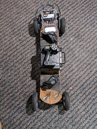

Well, it started out as a free ad on Reddit
Somebody had built this DIY for a YouTube video and decided to give it away, shortly after I also found a used MBS complete for cheap with bindings I merged them together with a few other random things
That made it slightly better but it certainly wasn’t pretty
Then came the idea enclosure, apex deck, and custom battery which really got everything to come together
Eventually I put some stickers on it, changed the hubs, put the bindings back on and grabbed a Z mote but it’s primarily stayed the same since
