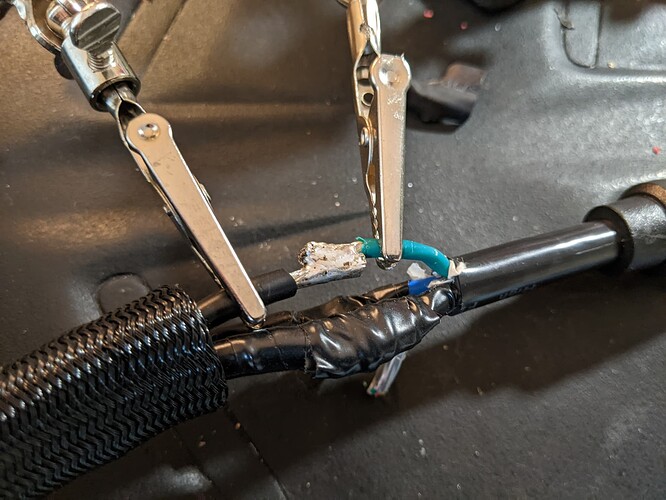

The first connector I did I used the ā€œmesh-spliceā€ method of trying to interlace all the fine wires and then soak in solder. The wires are too fine to interlace by more than a couple mm. Kinda turned into a big ball. So on this one I tried tinning both wires and soldering them side by each.
is this silver solder?
