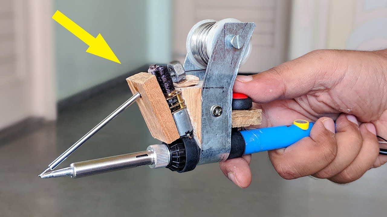

where is the 3d printed version of this for the ts80/100.
ts100 would be good because it would be easy to “jack” into it’s power delivery. I guess you could pull volts from a modified USB C cable.
I don’t think it would be that amazing but I sure want to try it, I would also want the solder to be dispensed to the side or bottom.
