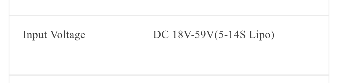

Does anyone have any experience using Sequre WP14200? I’m planning to run a 16S 60V battery with 150 amp max discharge. The Sequre appears to be a little better built than the Flipsky VESC boards.
Link to VESC is below, most worried about reliability and power delivery since this will be used in a wet environment.
I am planning to pair it with a JK BMS JK-PB2A16S-20P, 2 amp balance charge and 200 amp discharge**.**
I don’t think that is a VESC, just an ESC. So it won’t easily be compatible with Bluetooth modules or common to esk8 remotes and doesn’t seem to work with any motor sensors meaning poor low speed torque. And while it’s current rating is very high I think the continuous current without overheating will be poor.
I actually also started off looking at that kind of esc when first building an esk8, and I’m sure it can be done but won’t be good.
