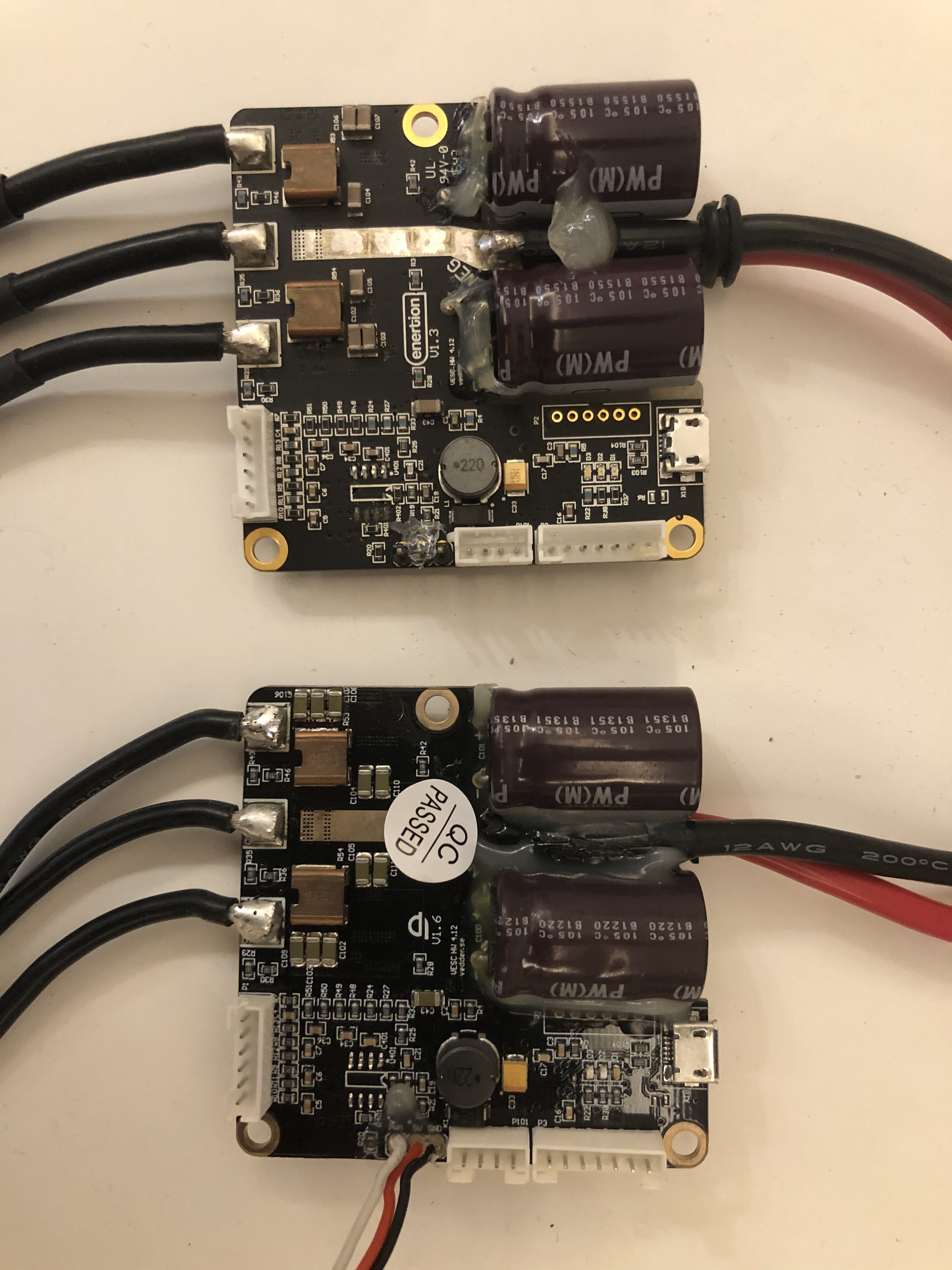

My team is working on reverse engineer. We already see some interesting thing with these pcb. This top pcb is made from American pcb and bottom one is from China.
We plan make change to some component for more reliability. We change capacitor to have larger uF which can helping for regen.

The bottom one is the later design, can’t remember the changes brought in for V1.7 which was the last version

For capacitor, we change to Panasonic 2200uF (from 680uF) which is same size as current one but can handling more heat and reliable.

My engineer discover many component not having enough solder to connect to pads in some place. We can making this better and reliable. Also some cold solder joint.
This can cause by using low grade solder paste and dirty screen during manufacture.
