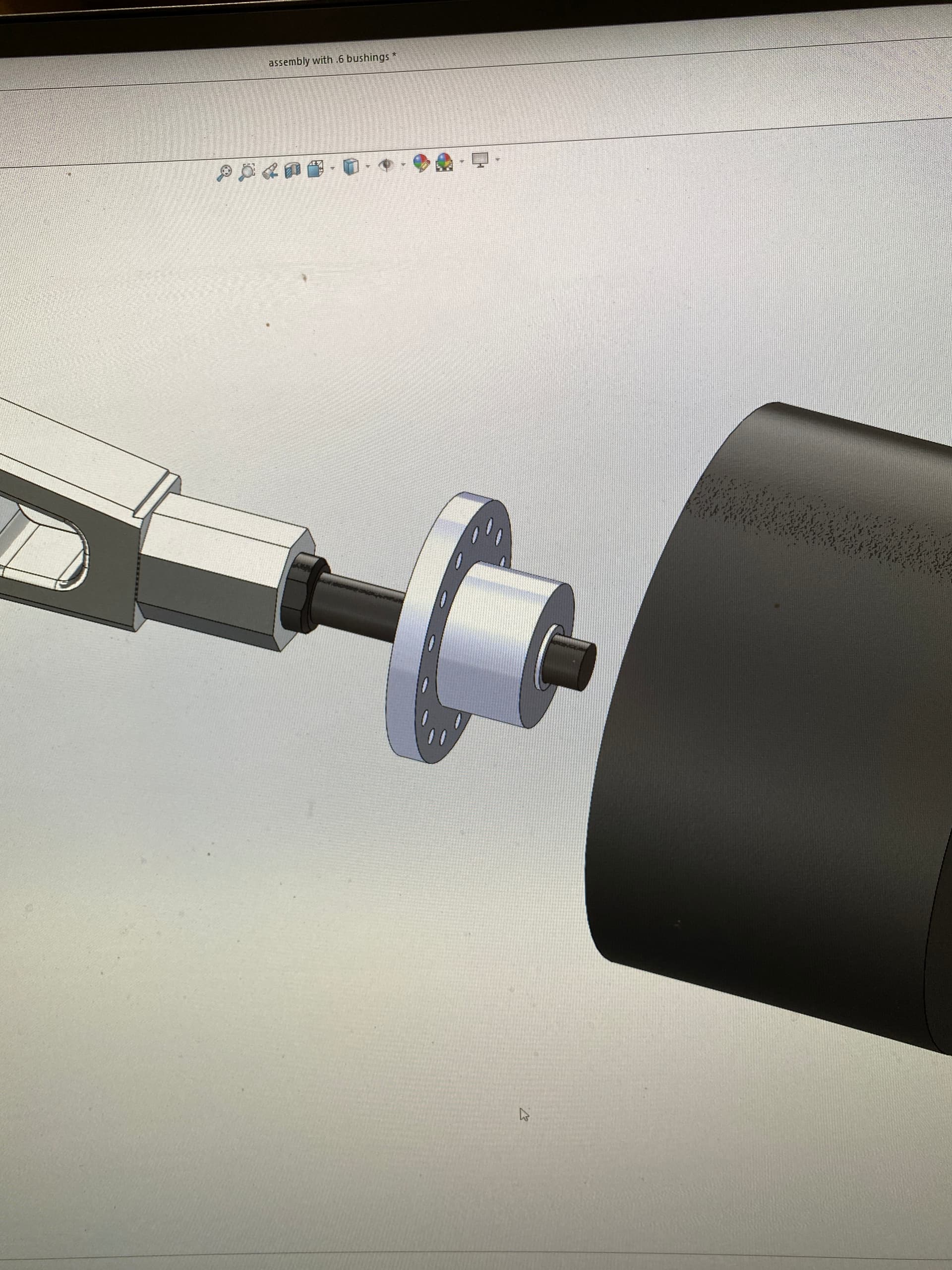

Small update on the progress of these…
Base plates are done. Hangers have been ready for axel end machining for a few weeks now, but I’ve been trying to come up with the best end profile to accommodate for some sort of a standard. This has been difficult as I want to accommodate for as much interchangeably as possible without compromising on durability :sweat_smile:.
I felt that a 22mm square would be a good start. @ApexBoards but trying to make that fit the BN M1 gear drives, (not AT).
The biggest challenge for this, is my axel design. It will be a 10mm axel, but with a 15mm flange screwing against the hanger. (I will not stray from this).
I’ve got a design for a belt drive motor mount 22mm with 6mm chamfers that could also replace the hanger mount on the M1 gear drive.
More info coming….
I look forward to any feedback, suggestions, and criticism.
Axel end machining is happening tomorrow!!

I think if you made your clamp the same as Kevin’s would be ideal! Is there enough room tho to accommodate the flange and still be strong enough?
hmm would it make sense to machine a BN 220/270 hanger profile to 22x22 AA adapter?
