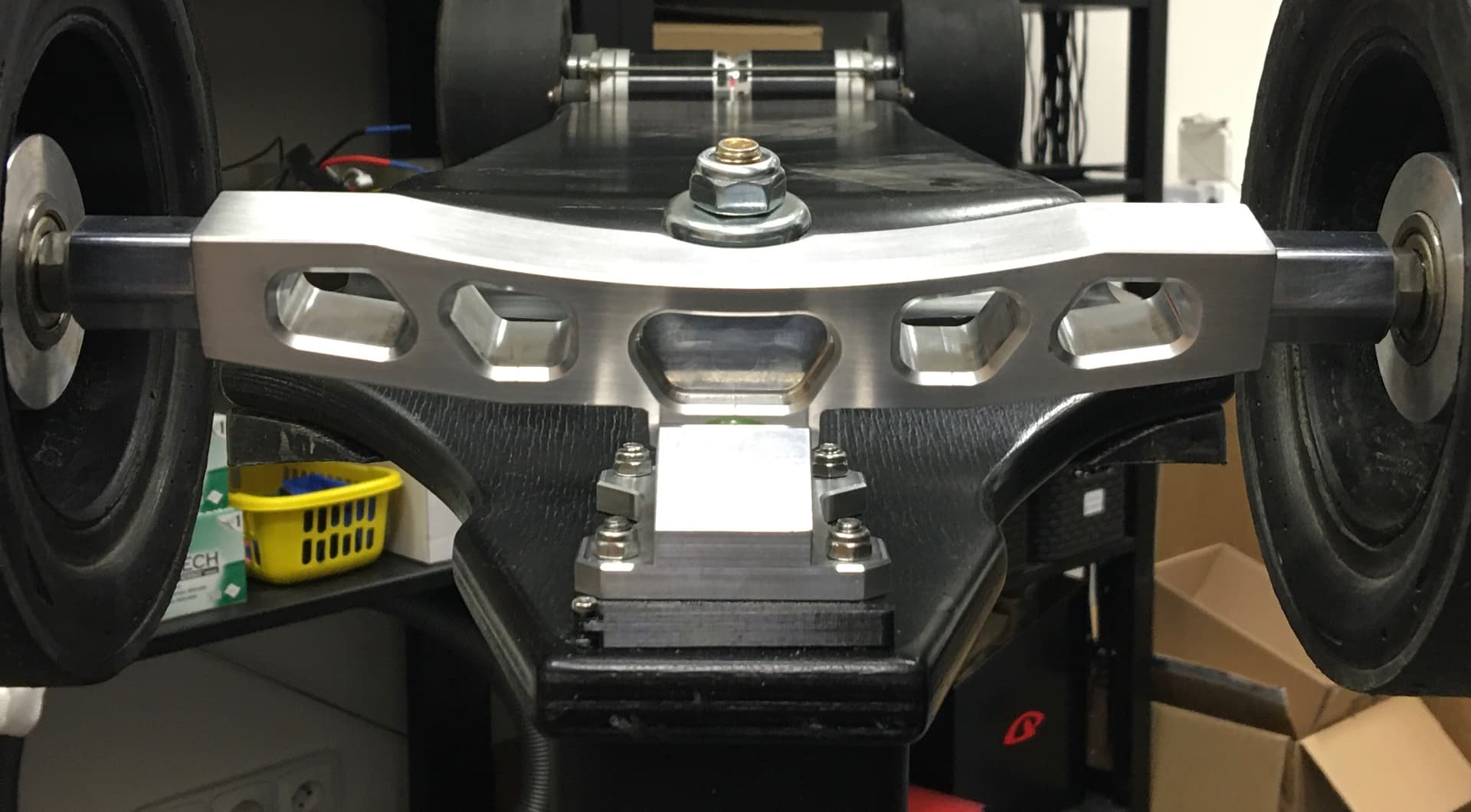

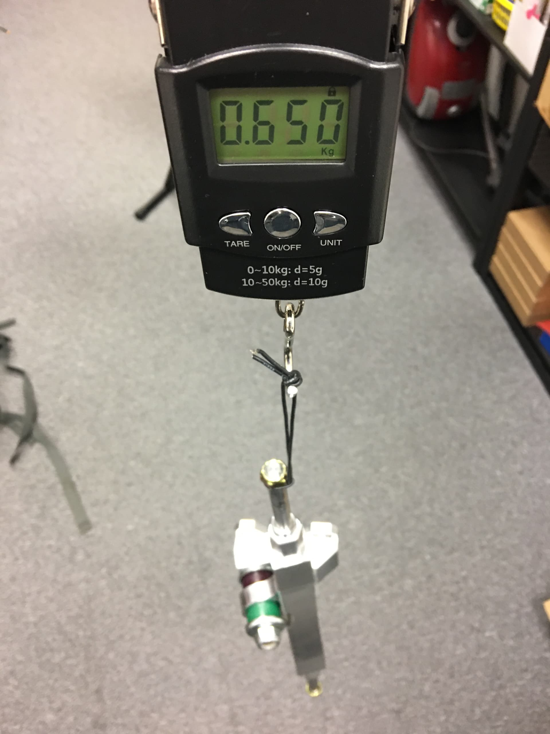

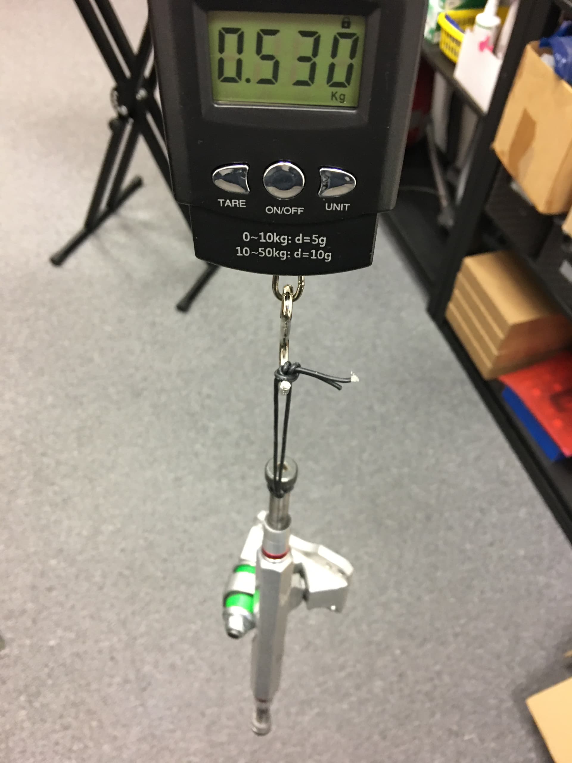

The truck is heavier than my old SR TKP 177mm but it’s not by much:
Impatient as I am, I just put the front truck on and went for a ride:

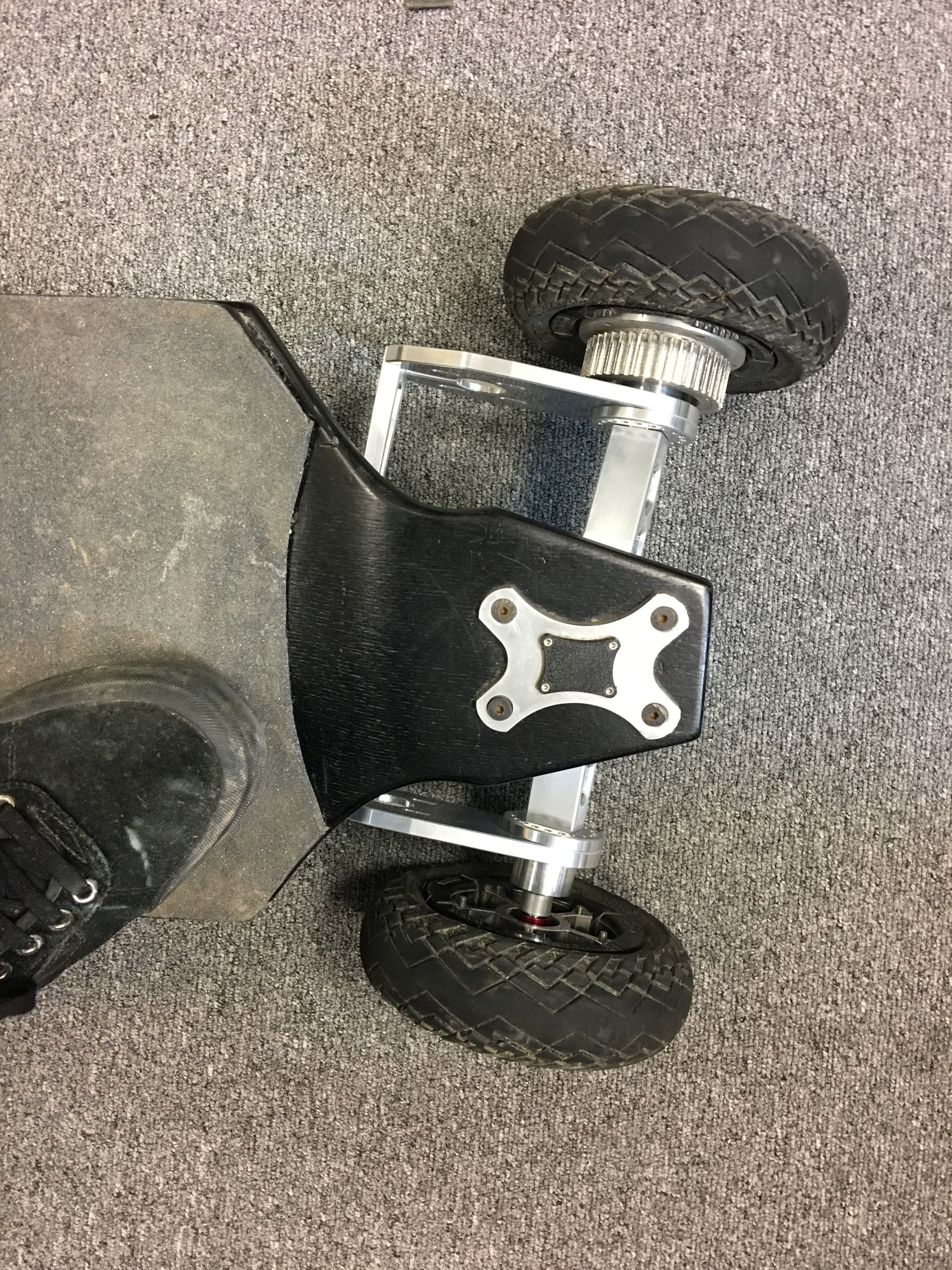

This week I went ahead with the rear truck. I quickly realized I won’t be able to use the Stooge wheels easily since:
  1. They require very long axles.
  2. The threaded holes on the Stooge wheel cores are too close to the center, which makes it impossible to design a pulley that would revolve around the motor mount clamp.
Not blaming Phil’s trucks for this. Most other trucks would have the same problem. Not blaming the wheels either. They are designed for the NKP trucks and the Stooge open gear drive. Just stating the facts.
So no Stooge wheels… for now… I have a little something in the making but let me not get ahead of myself.

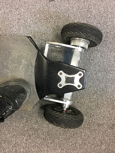

Instead, I decided to put my good old Trampa wheels in the rear. The assembly went smoothly. Everything is very well made. All parts fit together nicely.

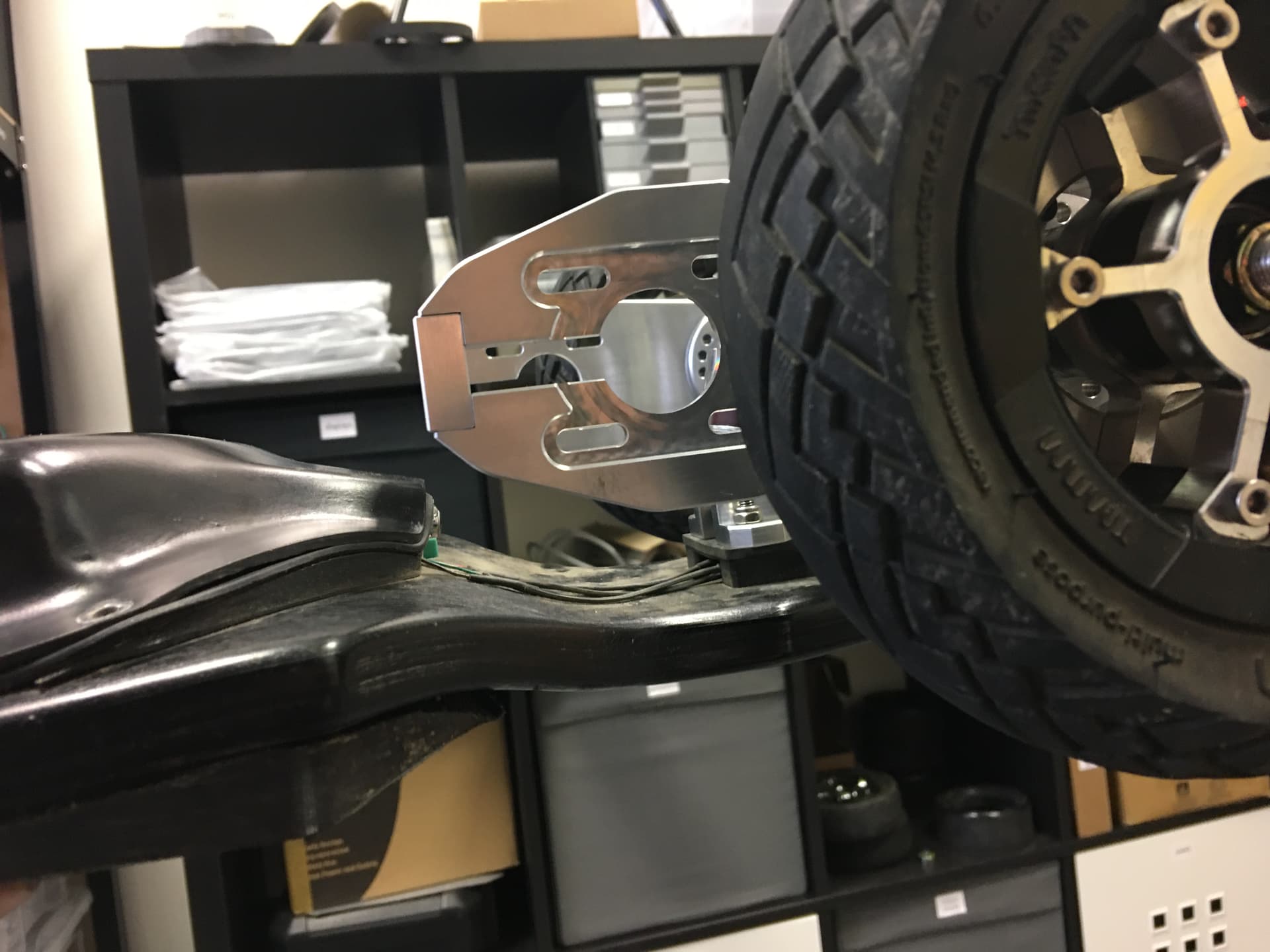

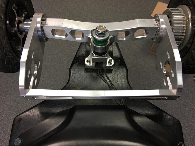

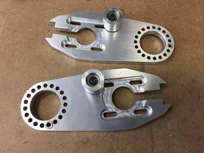

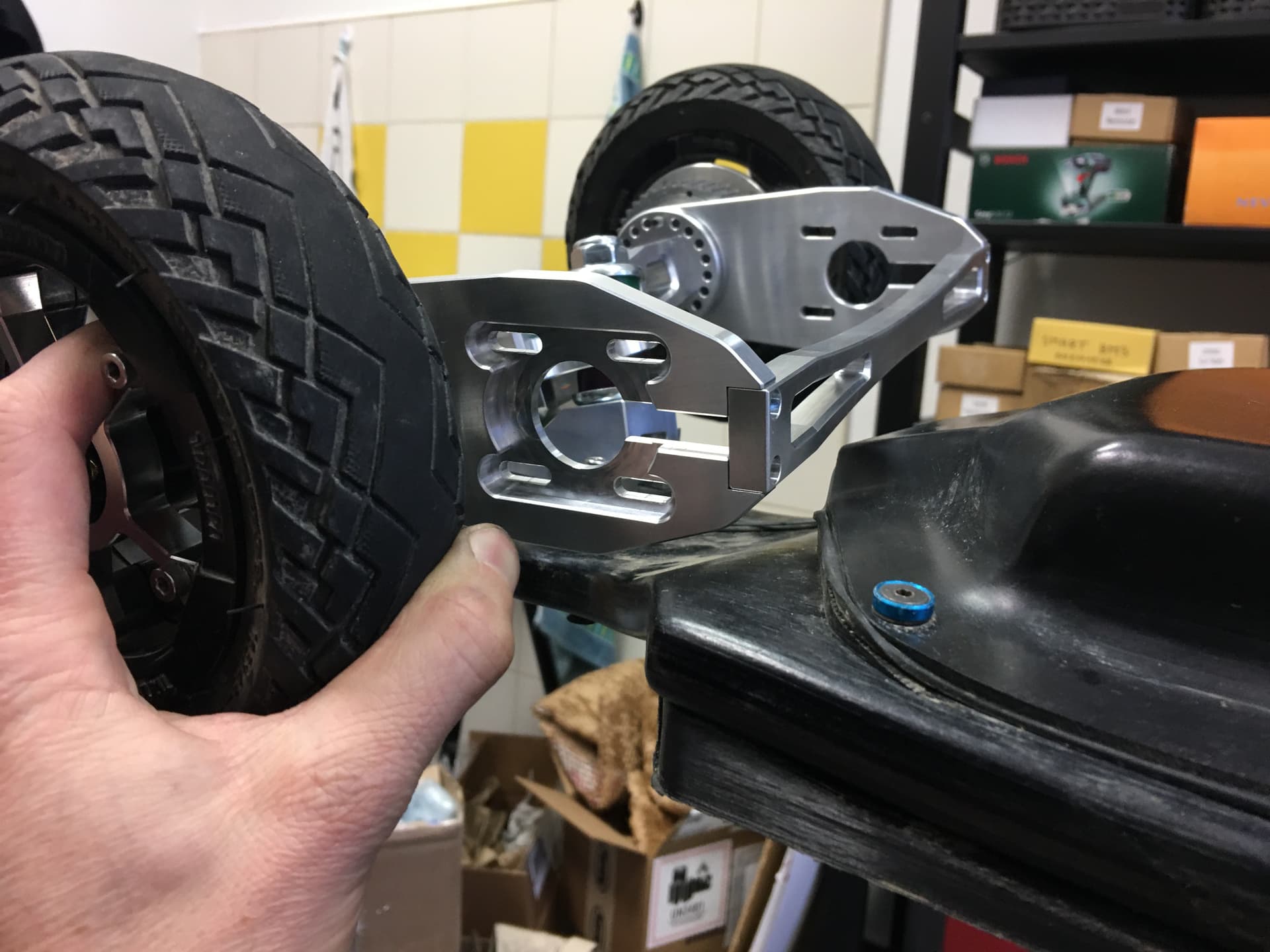

The motor mounts and the clamps both have 19 holes so it would seem that you can only adjust the mount angle in 360 / 19 = 18.95 degree steps. However, in addition to that, you can also rotate the clamp with respect to the hanger. The mating pattern is an octagon so there are 8 different ways to put the clamp on and each rotates the holes slightly. This subdivides the 18.95 degree step into 8 smaller 2.37 degree steps. So you can really get the mount angle finetuned very nicely.

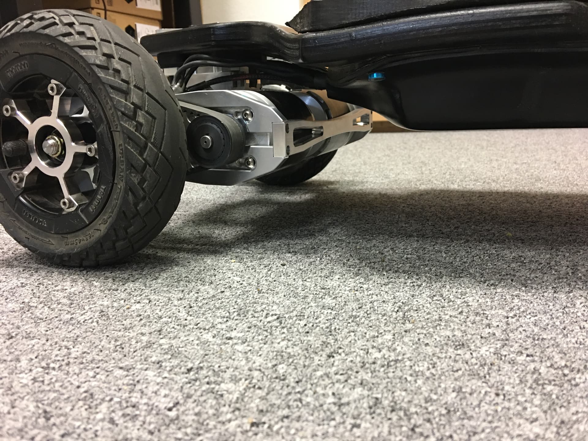

This is especially important for forward mounting where you want to be just low enough to avoid the mount/motor collision with the deck while turning, but no lower. You want maximal clearance under the mount.
This is the angle I ended up with:
No mount bite:

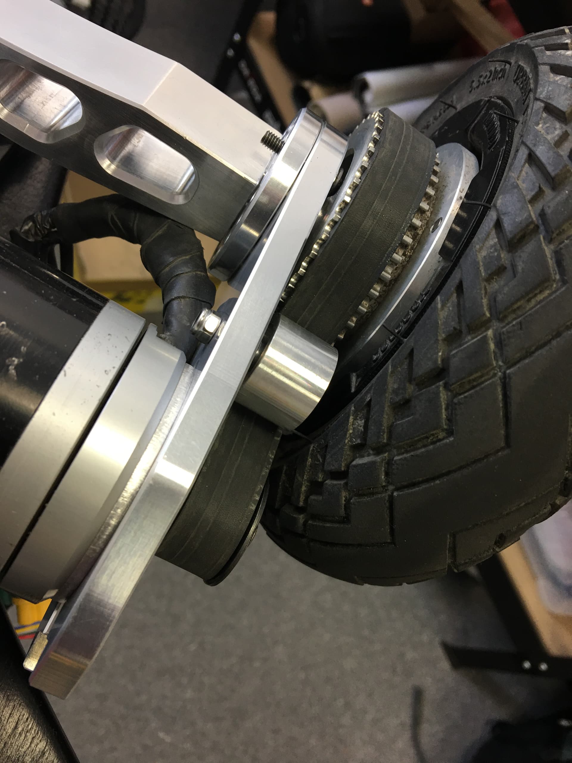

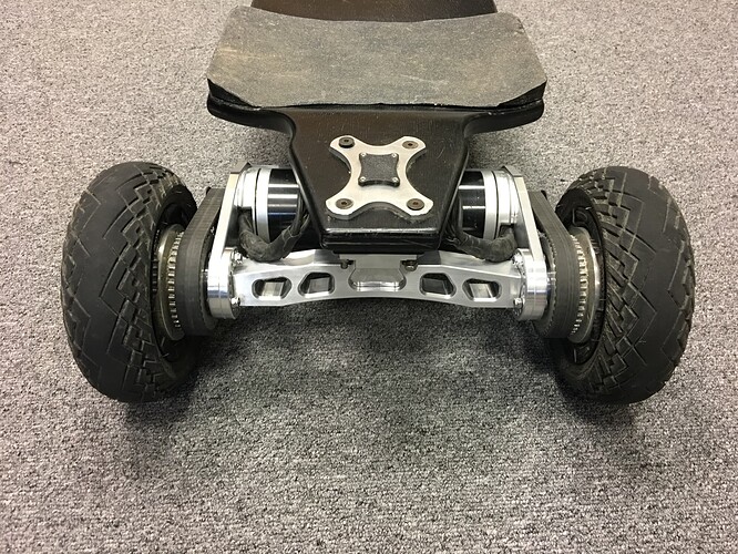

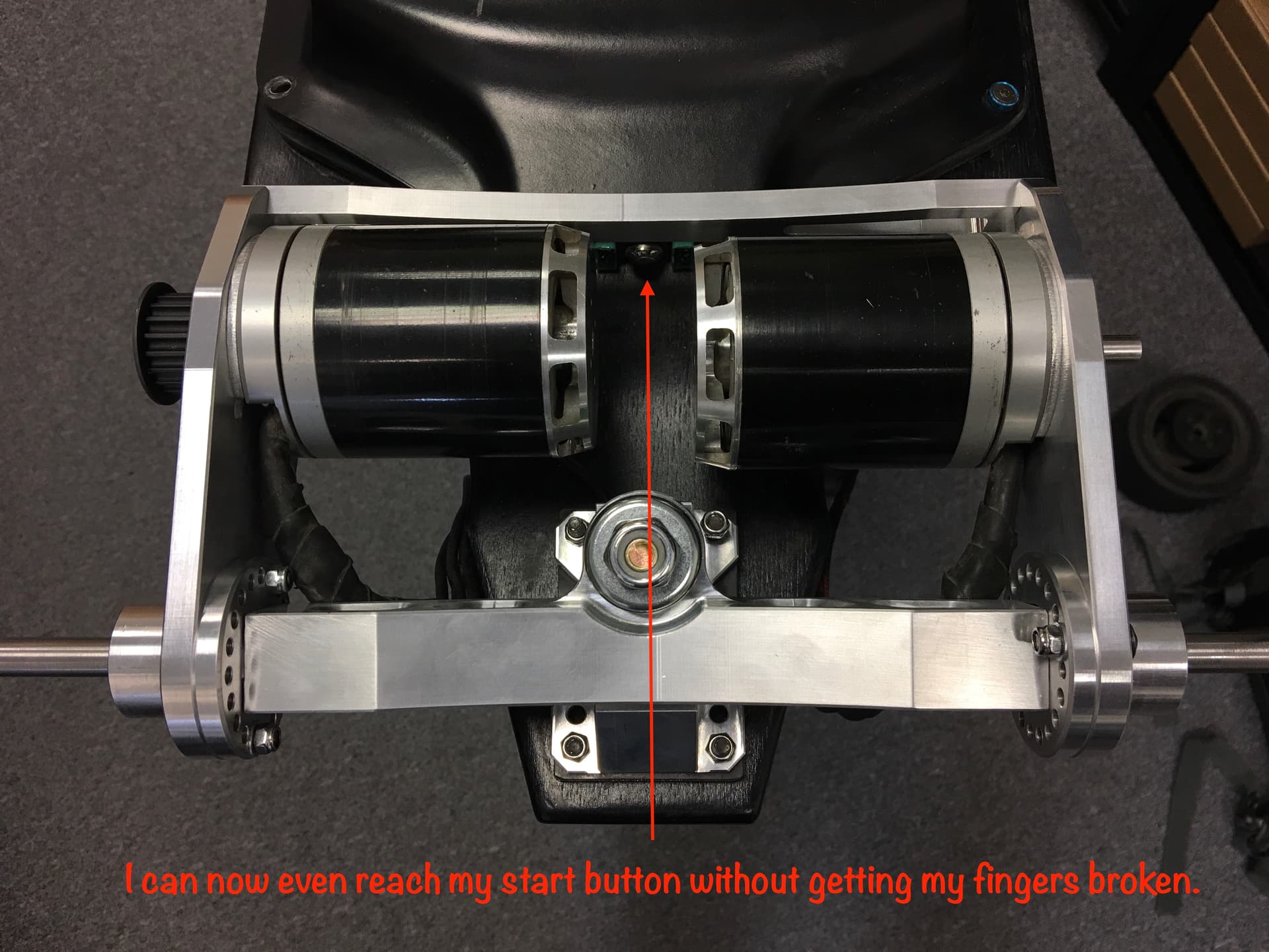

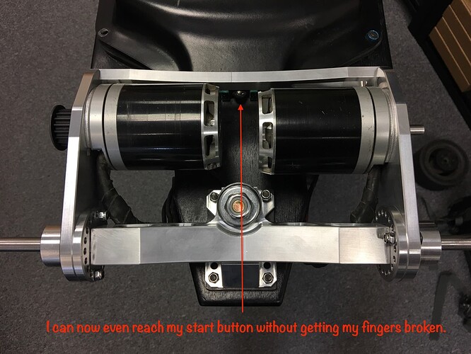

The hanger is wide enough to easily accommodate dual 6384 Reachertech motors (including spacers for the stupid protruded bearings). This is a huge improvement over my SR TKP:

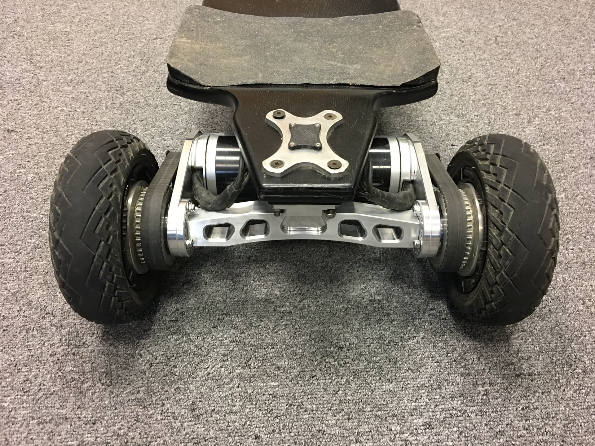

Ready to ride:
Well, kind of. The mounts are the perfect length for forward mounting. I believe they are the same length as my old mounts, which worked great for me.
The problem is that my old mounts have idlers and these don’t. Plus, I didn’t have any shorter belts to compensate for the missing idler.
So I ended up using a bigger motor pulley. I had to go from 13T all the way up to 18T, effectively changing the gear ratio from 3.38 to 2.44. :slight_smile:
Good enough for a test ride as well as for reaching the mach1 speed but the acceleration wasn’t great.

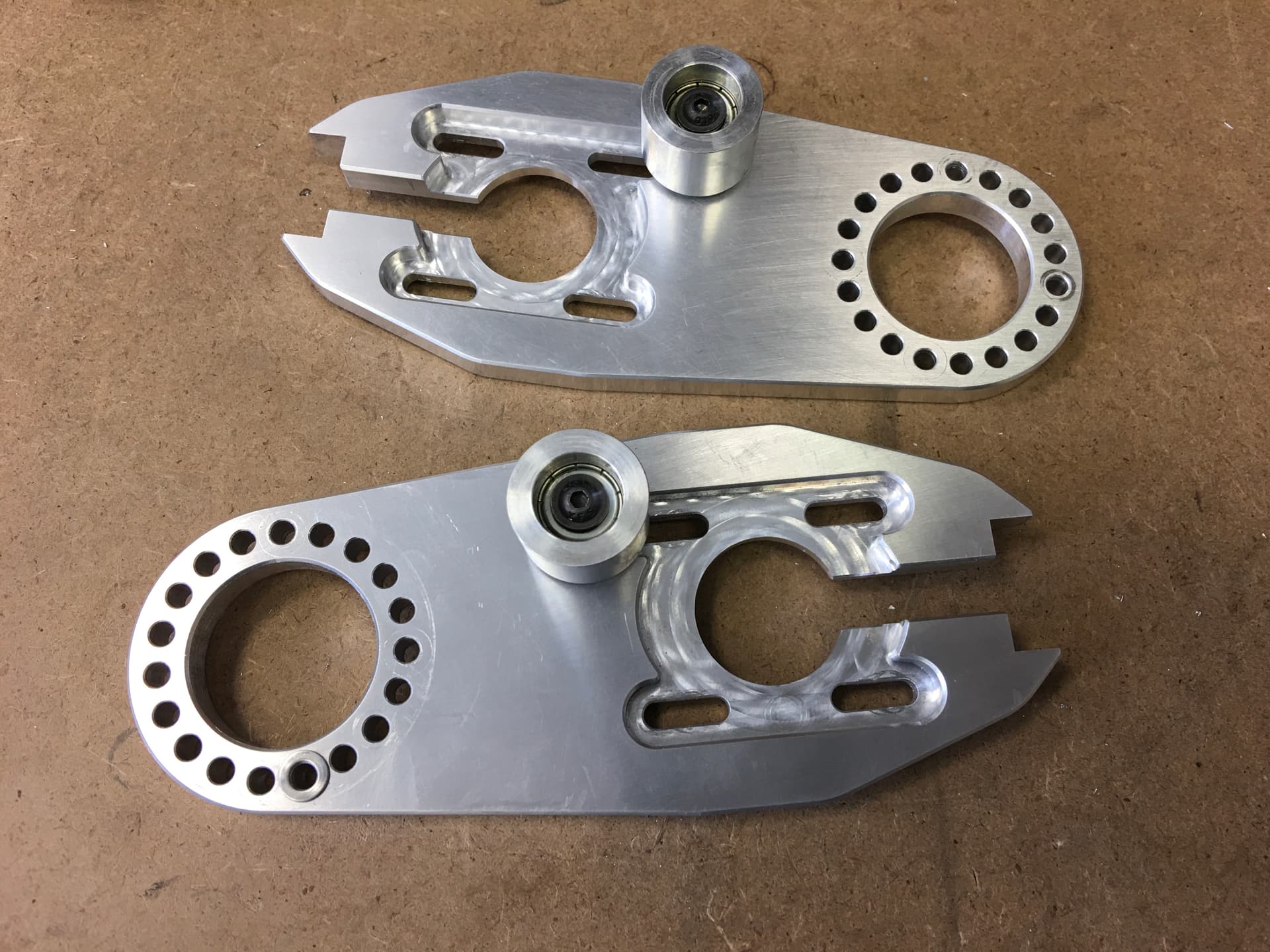

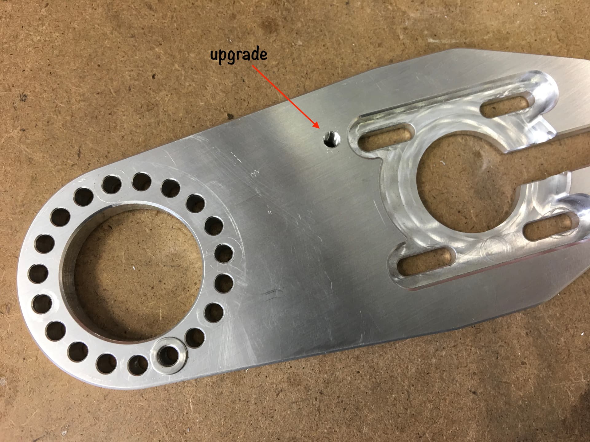

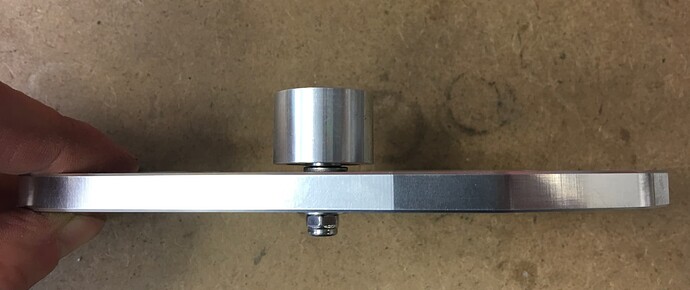

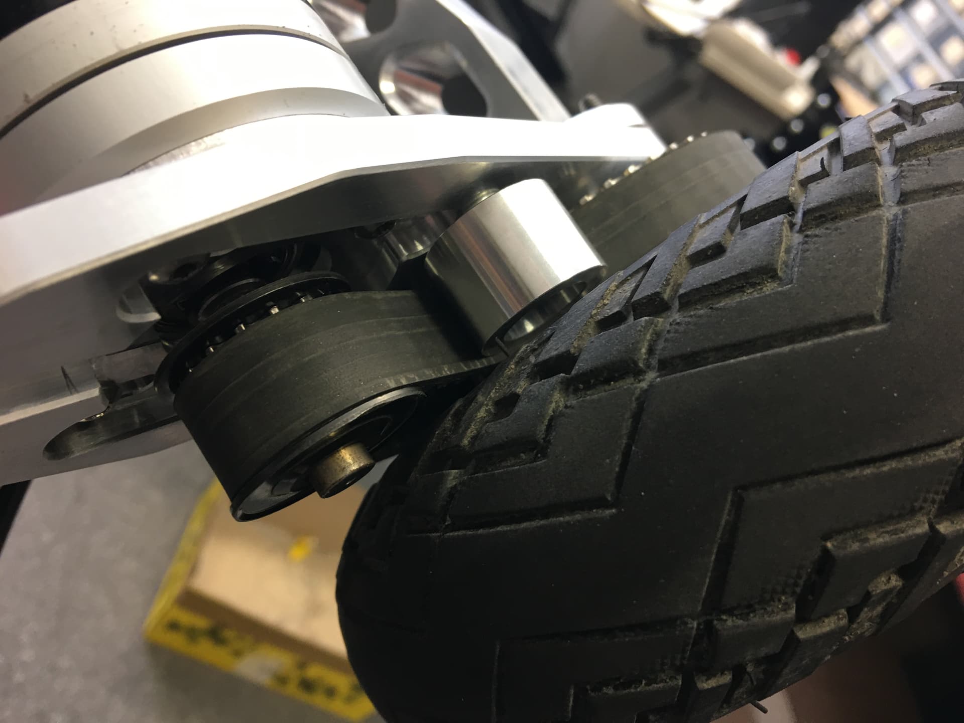

While I could have just ordered shorter belts, I really wanted the idlers anyway so I did something horrible. :see_no_evil: I took those beautiful, precisely machined, well polished aluminum motor mounts… and I drilled bloody holes into them. And I didn’t even use a drill press cause I don’t have one. :see_no_evil:
Nevertheless, it actually worked out pretty well. The idler is a little bit in the way of one of the slots for attaching the motor so I lost some flexibility in belt tension adjustment but there’s still enough travel available so it’s not a problem.
So I’m back to a normal gear ratio now and ready to do some riding.

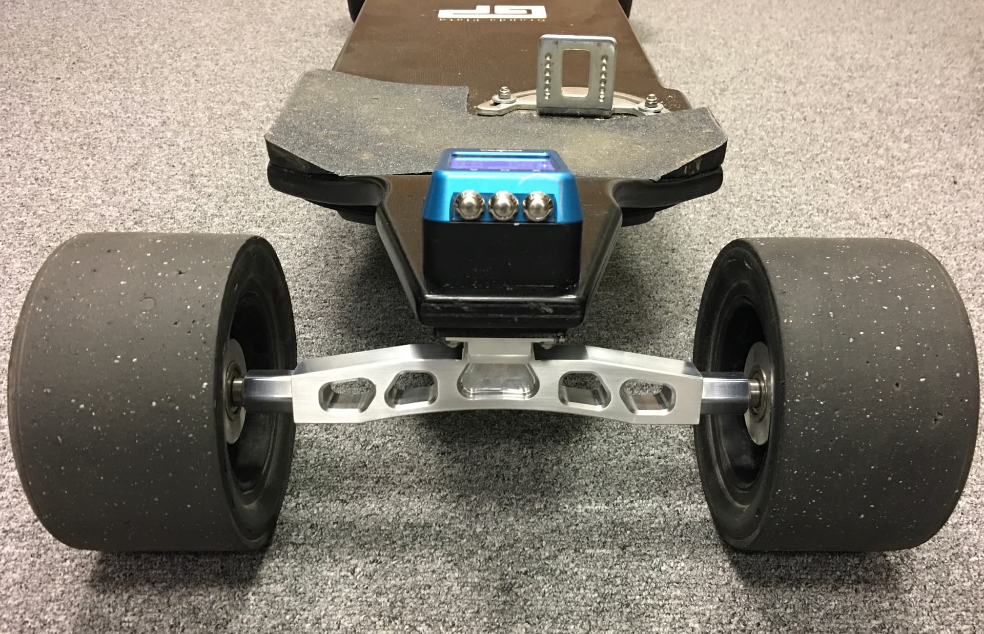

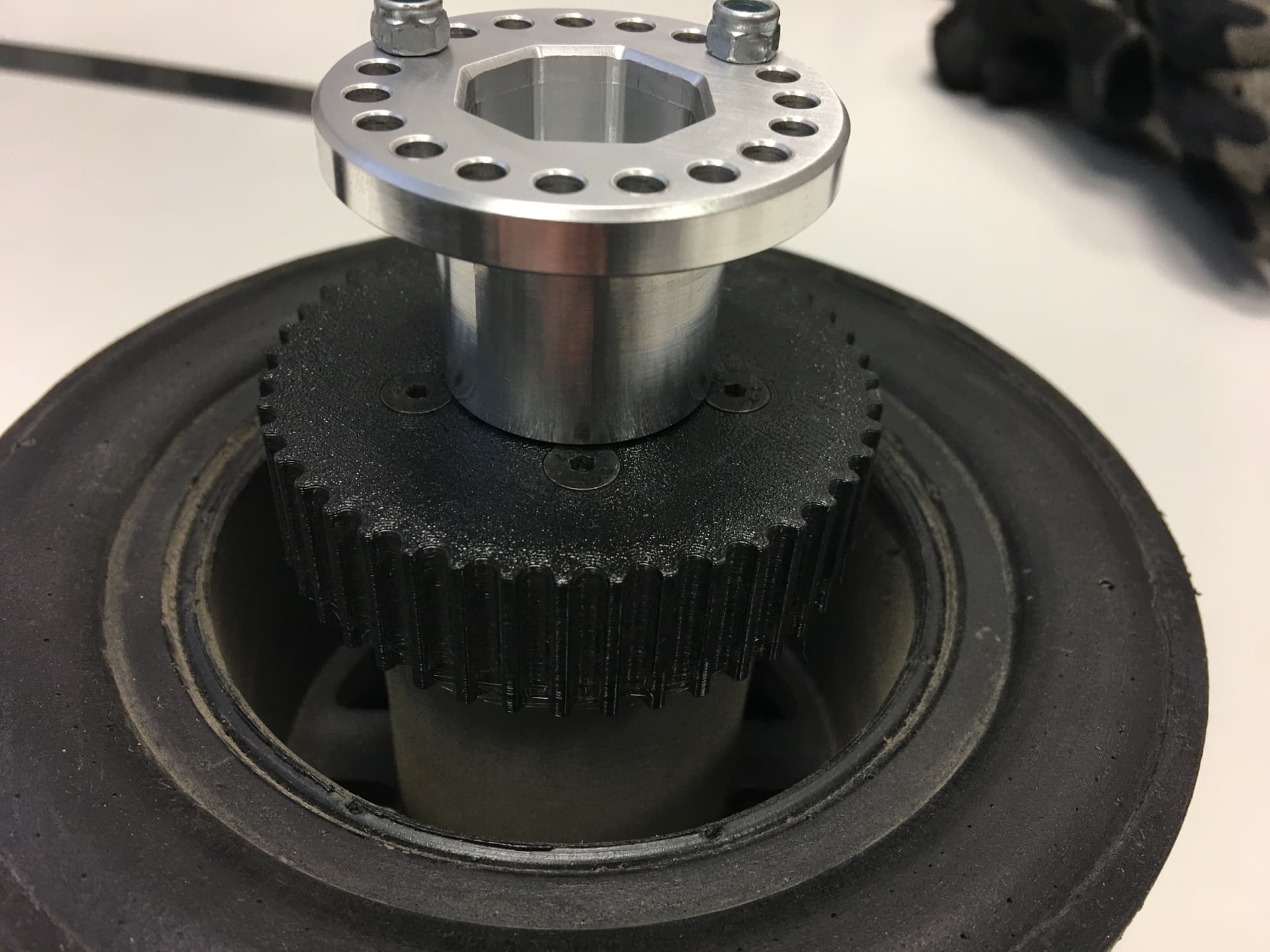

Second test log. After quite a bit of struggle I finally managed to print what seems to be functional custom cores for Moe Stooge wheels that allow me to get the wheels installed on the rear truck. Pictures below. Since the wheels are very wide and we also need room for the pulley, I had to bury the outside bearing pretty deep into the core. Hopefully it will still hold up. If I could have some extra 12mm of axle length that would be very beneficial in this case.
