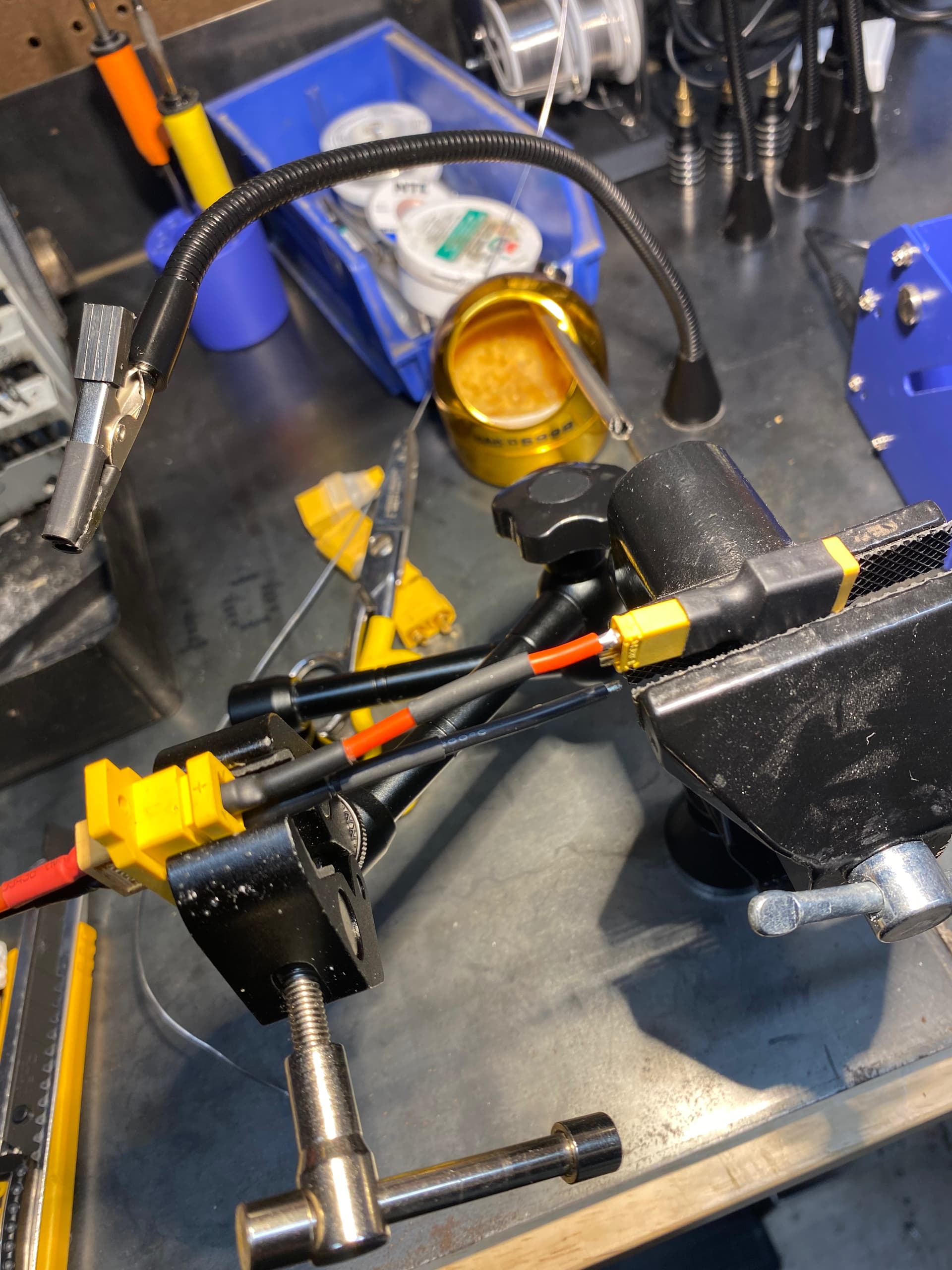

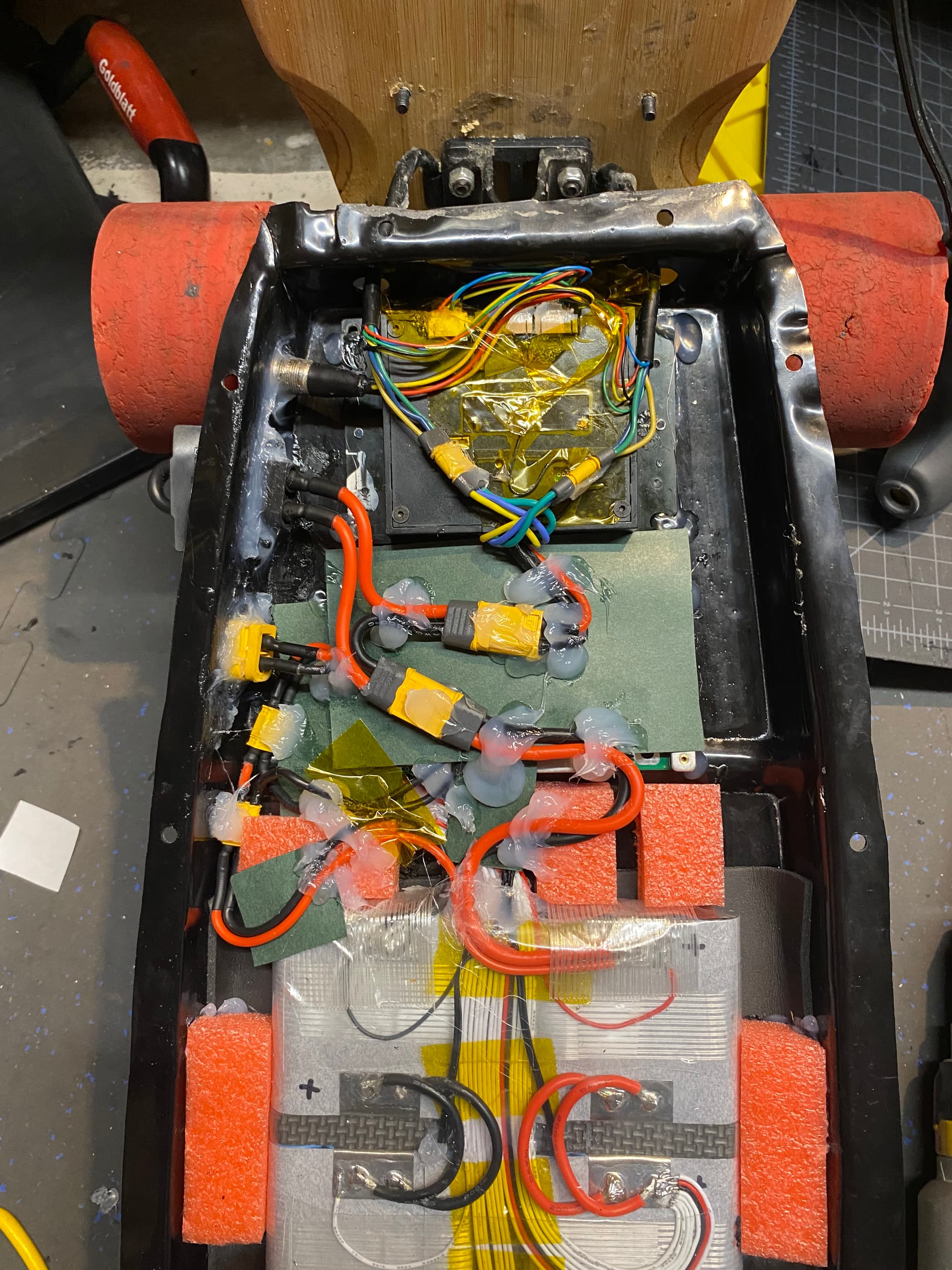

Ok so i got it in the shell, shell is vac formed abs: see shitty diy thread. It’s way too weak but idc, looks ok but it is the end of a long series of compromises and failures and i need this board off my work bench. Added foam blocks to secure everything, made up the wiring harnesses and jumpers, cut some more holes for a loop key and xt60 charging port.
I hate how hard it is to make the wires neat and tidy, I die a little inside every time i get to this part. Added a bunch of kapton, fish paper, hot glue to hold temporarily and a fuck ton of silicone to keep things from rubbing in a bad way. Now to let it cure and then close it up for some testing. It will be getting a 1/4 of foam on top of everything to lock everything in place but not until its dry

So they have a pretty good wire diagram:
Instead of making all the connections outside of the pack i took the wires all the way in to the cell termination point:
