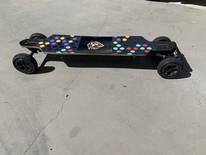

EDIT: I now have an Esk8 commuter! I have edited the first post to show the pictures. I still consider this 80% complete as I need to update the grip, mount bracket, new wheels, one of those x-plate brackets, general upgrades/improvements to the build. But the main thing is, I have done approx. 100km without any catastrophic failures.

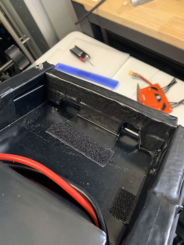

    • Foam and insulation tape for diy seal between deck and enclosure

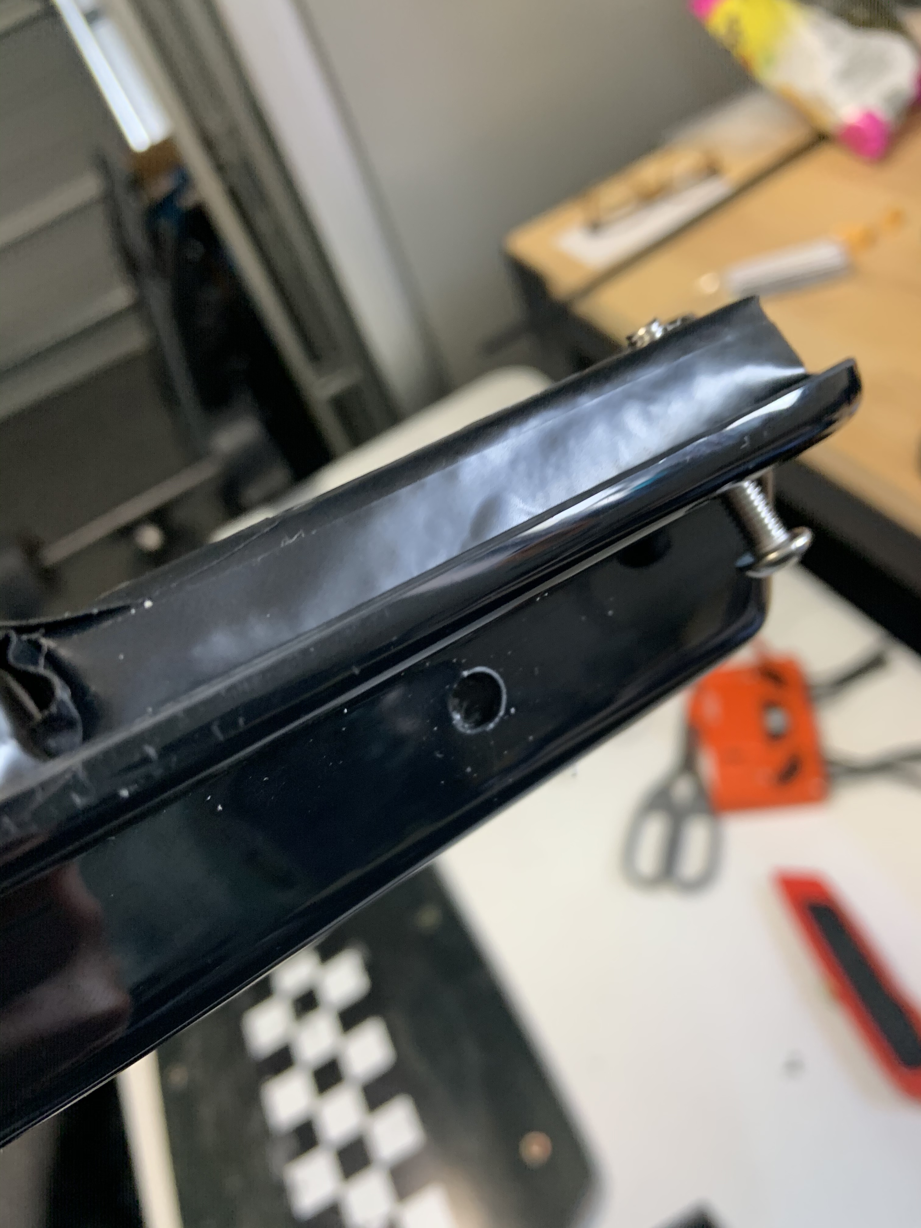

Stage 7 - Drill my deck for the enclosure :scream: and add foam, holes and stuff

Stage 9 - Yes, you guessed it, scream like a little girl receiving a pony for Xmas and ride her to work!

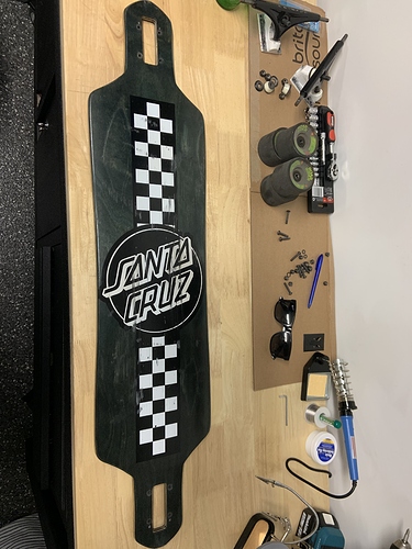

Deck: Santa Cruz 41” Concave - Existing board, now worried it is too flexible

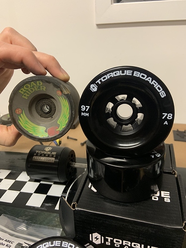

Wheels: TB’s 97mm (paid)
Motor: TB’s 6374 190kv x2 (paid)

If anyone has any recommendations for a good stiff deck that doesn’t cost an arm and a leg I’d appreciate it.

Cool stuff mate. 35km/h??? 12s on 16/36 with 97’s will get you up in the 40’s
mph.
Maybe find yourself a 40 evo or subsonic century. Something that is very stable at high speeds.

I like that deck you have there a lot. Use it and just take it easy. There really is no magic formula for high speed and being able to carve around. Even on something like an evo it takes a lot of practice going 40 mph. Not something you should just do. If you use the ackmaniac firmware to program the vescs you can limit the top speed. Have you ever ridden an esk8?

You may want to consider changing your gearing: Maybe drop down to a 14 or 15t motor pulley, and/or increasing your wheel pulley size - 40MPH is pretty fast when you’re only ~4" off the ground with nothing to grab onto for dear life.

I like this deck a lot but enclosure fitting would be your challenge.
@J0ker has that deck
He recommended it to me and I have it now too :smiling_imp:

Actually. I think its a TB 12s uni, but its sits well enough on the deck that with a little heat gun and molding, it will be a perfect fit.
