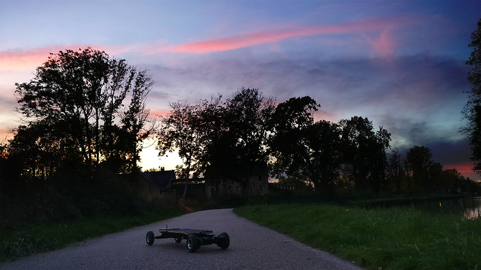

Now that summer end, the MadSurfer will patiently wait until next year. I need a little AT during the rebuild of the new Darth Vapor
Something like the Burgunboards I was riding last winter :
That could also be my spare board, or for my love, or friends, or between two rebuilds.

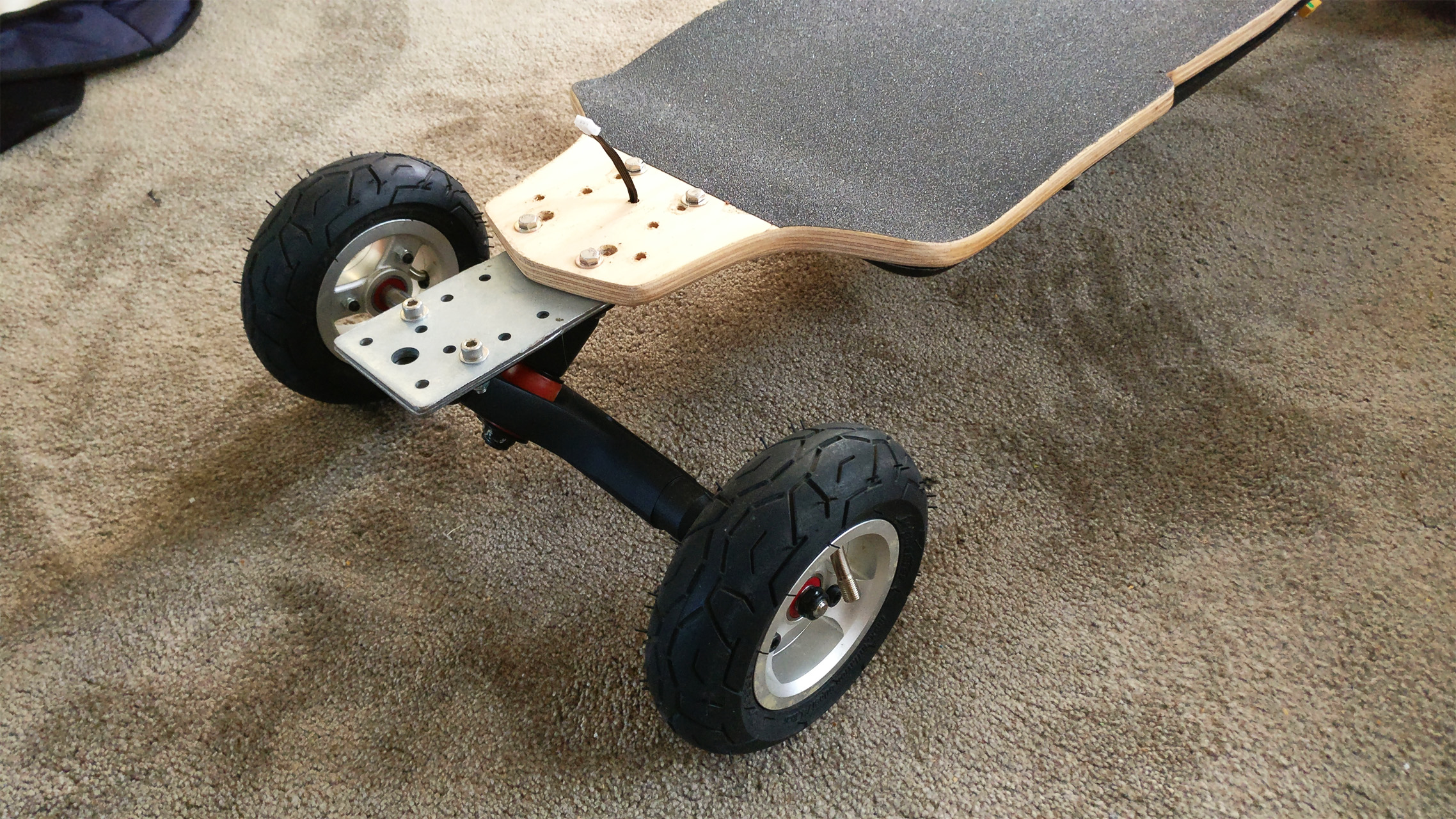

I was needed a wider deck, with more space to accommodate my stance and start thinking about an old one laying around.
  • It’s an old Madrid asymmetrical DH deck, 9 plies, little dropped, W concave.
  • And I have customized a bit the shape, Break the block appearance by lightening the center of the deck, also make it symmetrical now. And I send it all. I think I will let the natural wood like the finishing.
(the deck is shorter (compare to the Axis), and maybe it is still a bit shorter for my stance, but I should be able to put my feet a bit rejected, as the shape gave me more place to use finally… I hope to be understandable ^^)
  • I have to go with extended mounting plates because I don’t want to cut the shape and it will be where the “dropped wave” is located (the space that I will use as gas-pedal/ foot stop), and I want to let it full size now I can enjoy a wider deck! ^^

Extended mounting plates prototypes and put inserts in place on the deck etc. (yes I change the Haggy Berg. rims, the green will go on another board :upside_down_face: )

  • mounting plates : extended ones, a raw prototype for now
  • Trucks : Kahua trucks (50°) and a PNL 40° base plate on the rear.
