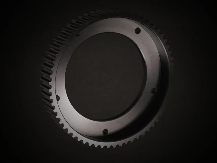

I know lacroix sells 62T for rockstar, but they’re pricey I think :joy:

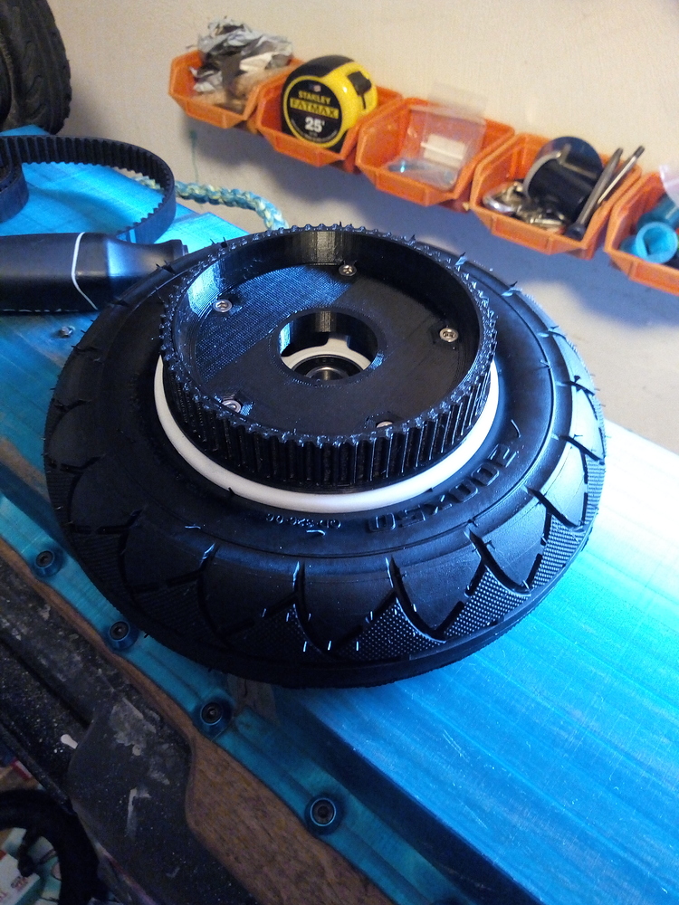

I’m currently running 66T that I printed in PETG

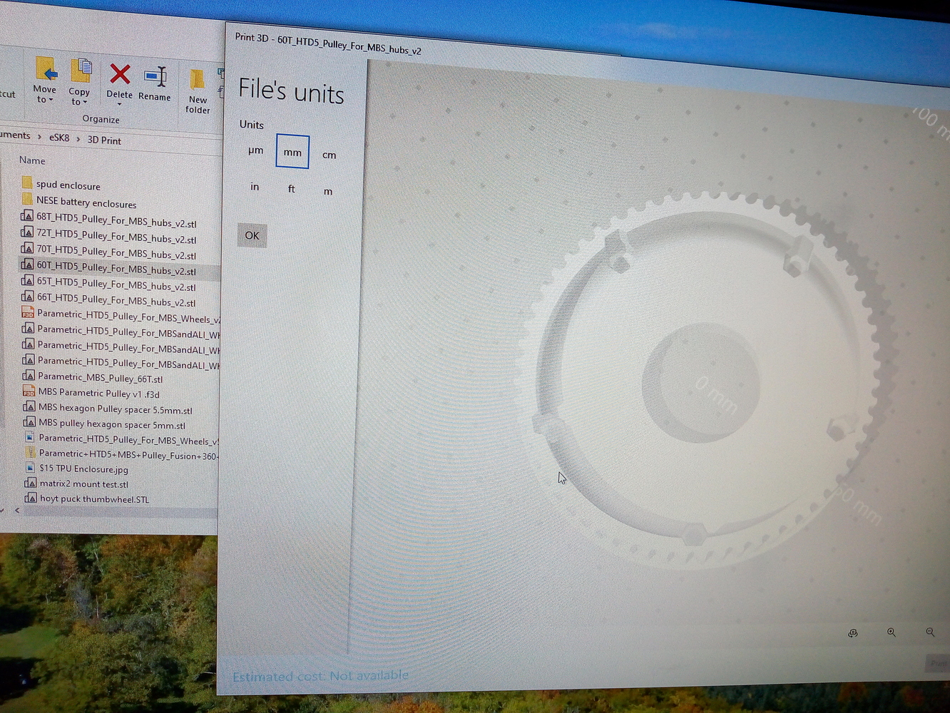

I can make 60T, actually have it on my “to-do” list after I finish a battery.

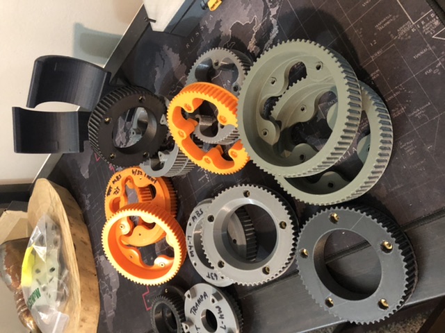

I do have a couple sets of 63T that fit MBS hubs. Long story short I need a specific size and that just end up being the number of teeth for the size it fit so I have extras.
Bottom right
How wide are they?
Diameter is 100mm, teeth are 18mm wide with a 1mm lip. Have 5mm spacers too, or can print extras.
