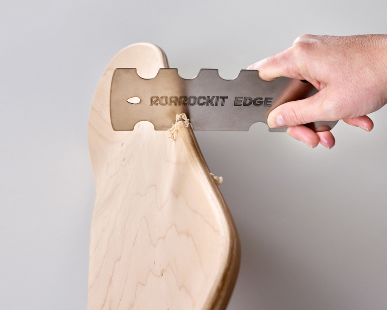

They just recently started selling more in the range of tools that a deck builder would love to have. This ranges from an awesome edge profile scraper (I picked one of these up too!) to the rulers I had been looking for all along.

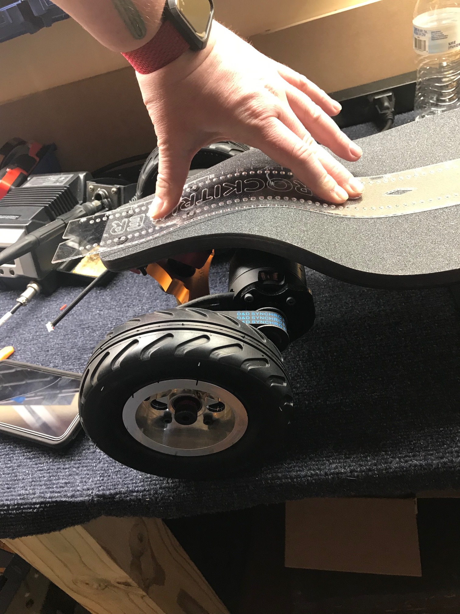

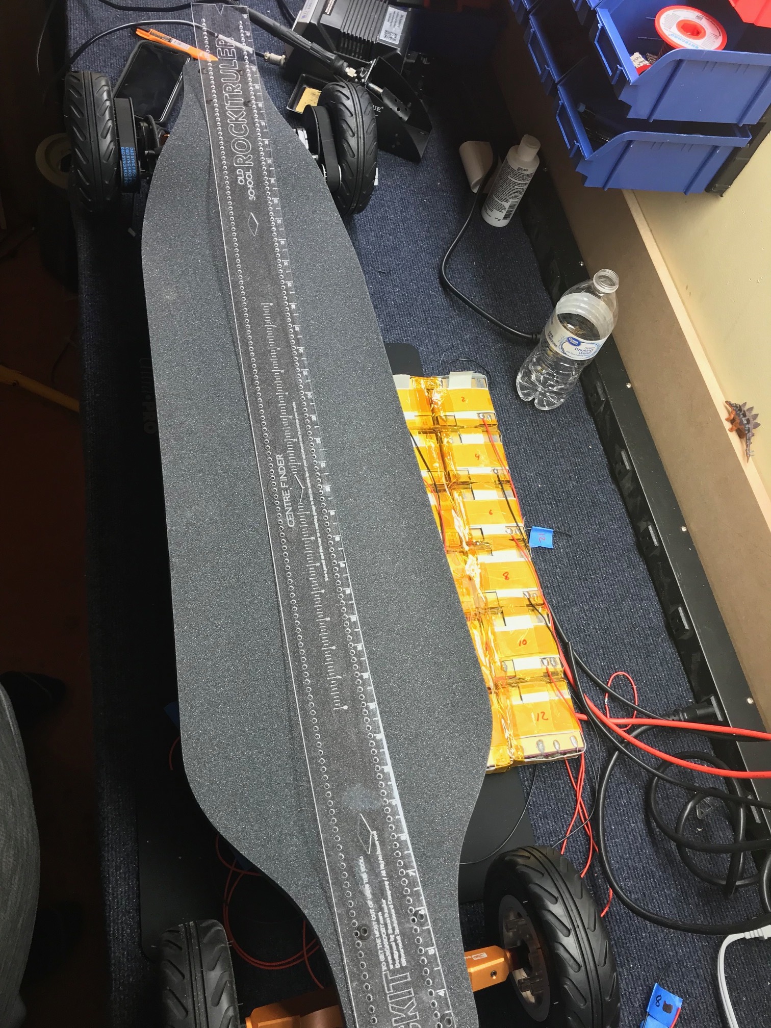

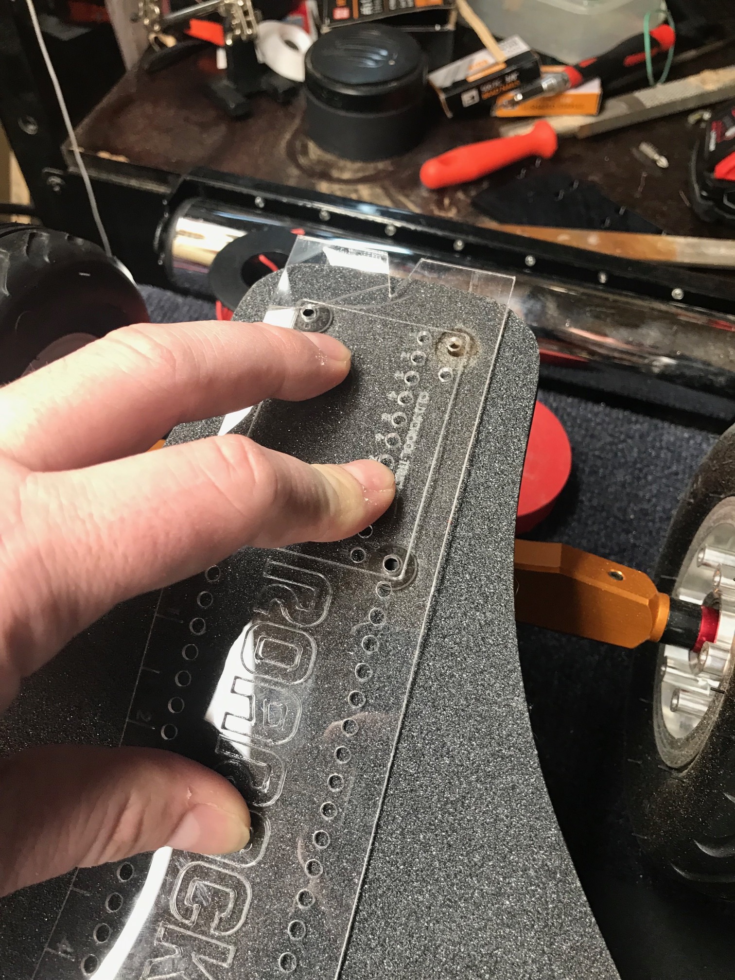

I chose the old school bolt pattern, as you can see in the picture below, it lines up perfectly.

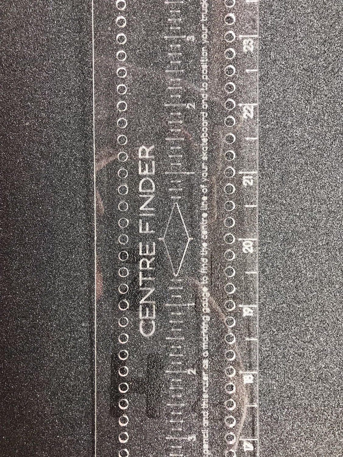

There is a nice “center finder” on the ruler with diamonds spaced out equally over the entire length off the ruler.
There are plenty of bolt hole guides as well. If you are building your own decks or doing any sort of modification to your decks, this ruler is going to save you so much time and headaches.

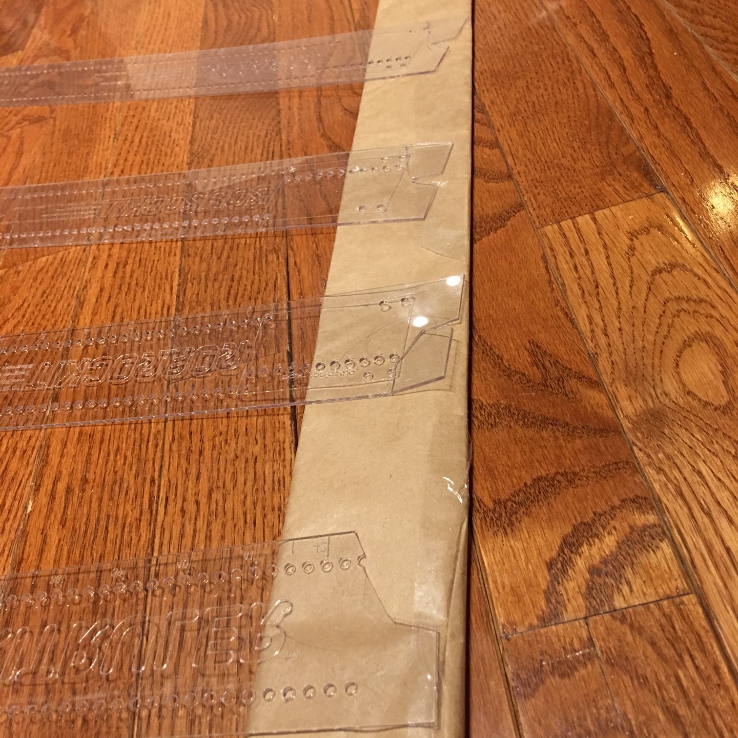

I bought 4 of these at once, to help cut down on the shipping for some other members here. Unfortunately, UPS decided to not take very good care of the rulers during shipment. As seen in the picture, part of the box was completely ripped and held together with tape. I had a bad feeling about this before I even opened it…
I was right! 4 out of 4 of the rulers had broken on the end where the box was smashed. I immediately had this pit open in my stomach….customer service time.
I shot them a quick message on Facebook with some pictures and they said they would review and contact me in the morning. I got a fairly long message back from the guy I had talked to on the phone. TLDR; they are sending me 4 brand new rulers and re-evaluating how they package and ship these so it doesn’t ever happen again! They are also interested in the Esk8 community so I told them to come on over to the forum and introduce themselves…hopefully they will!

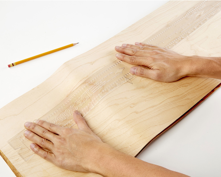

Quick visual guide on how to use the ruler
