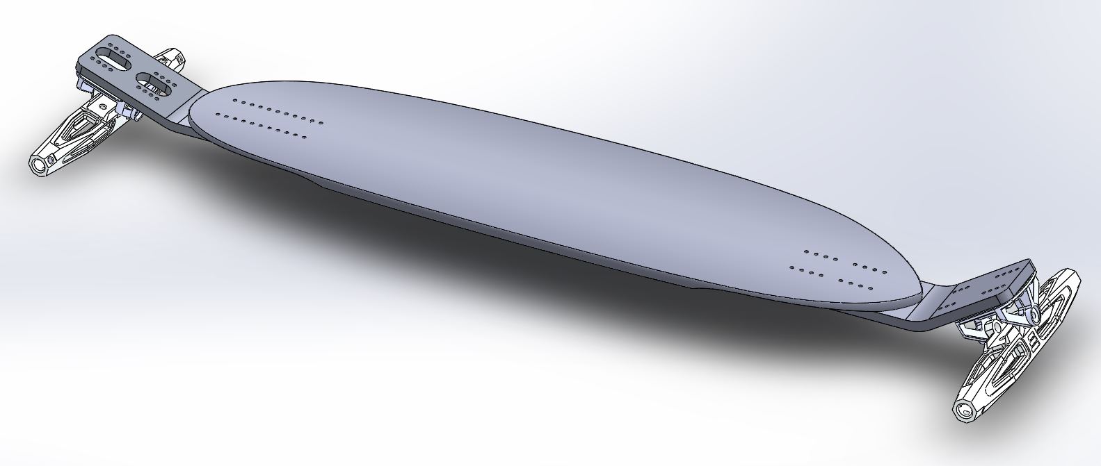

The good folks at Drang were nice enough to send me a couple of .stp files to see how the brackets would function on a deck not designed for them. We are working with G-Bomb to see if we can make this happen as a collaboration! Pictures with Lacroix Hyper trucks. Shown with 35/20 split
That is one long board. Might need to increase those angles to get the turning radius down…
G-bomb channel truck brackets! This is going on my next build for sure!

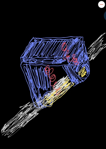

Ohhhh. That’s what it looks like. I imagined something completely different… A senario where the base plate is replaced with an angled bracket.
Excuse the shitty phone drawing. I had an idea like this: Blue is baseplate, white is the hanger and red is springs, yellow is axle.
That’s actually a really good idea.
Took me a while to understand what you drew but that is a very cool idea. Then again, the angle would decrease the amount the hanger can turn, so I think it would be no better than just using angled risers and a standard baseplate like we have now.
I imagine it will be much lower than angled risers, and in my head, how much it turns would simply depend on the angle it was made, for flat drop through decks, should be similar in height to RPK trucks
Edit yeah im shit at drawing
I’m having trouble understanding it
JK I thought I was original but its basically this I imagined, just slightly different. Should’ve just googled it
My version has another bracket on the outside so the pivot axle is supported both sides like channel trucks are, but otherwise that concept.
