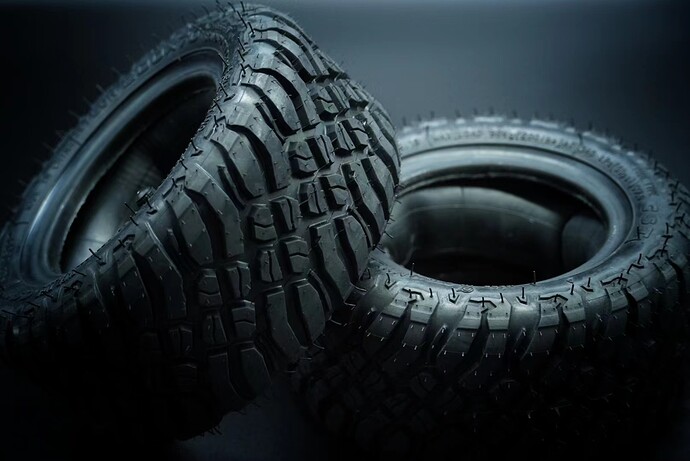

Hello,
I was given some used 9“ Mudpluggers for my LaCroixsannt MTB and I ordered fivestars.
I originally ordered Rockstar II XL but they are not being made / shipped / whatever, I’ve been waiting since April for the shop I ordered them at to come out of its ass.
Anyway, I ordered fivestars and they arrived promptly but I have a problem at the back.
I cannot get the tire to fit because it rubs on the motor pulley.
I could make some spacers and get it to work but then I wouldn’t have enough threads on the axle left to tightly fit a nut.
So it’s back to square one.
Has anyone got a solution, tried something that worked?
I’m still on my 8“ (now) slicks and that sucks for a mountainboard.
Thanks

Could I maybe pull the axle out a little bit?
ahh, that sucks. how much tread on your axle do you have until it’s no longer to fully engage the nut? can you space the pulley out from the wheel any more?
I think I could space the pulley out a bit but I’m worried it‘s not slotted into the rim any more then.
I think I have maybe half a thread I would normally have?
I‘m not riding like that.
only other solution i can think of is a wider wheel pulley or gear drives to fix that problem
Or different wheels altogether.
Or get 8“ knobbies.
or that, newbee has some new 200mm off-road wheels that have been getting good praises. whatever hubs you use will need a 4in lip
Phatlads should fit here no problem. They have more offset than the fivestars.
I think the main problem is axle length.
No matter the width of the rim, I need space on the axle to fit it.
For example, if I get wheel spacers for the fivestars to stretch the tires I may not have enough space on the axle to fit a nut.
I need rims that have the same inner width than rockstars / fivestars but a wider outer rim space.
I can stretch the tire and it would fit.
I guess.
Are there 72t or similar wheel pulleys for those?
Radium 78T would work.
It looks like they have 66T and 76T pulleys
Edit: looks like 20mm wide belts, but they do sell kits with new 20mm pinions also
The Hyperrims wheel pulleys would work with adding a spacer (another bearing to test the whole shebang) but then I‘d have too little thread on the axle left.
I‘m trying wheel spacers next.
if you flip the nut backwards so the nylock is against the bearing, it could work. i’ve had to do it before for the same reason. (obviously not the ideal situation tho)
It appers to me that your buldging sidewalls are interfering with the belt. And that a wider rim would give you the stretch you need.
Also, I believe that on those wheels the inner bearing sets recessed inboard of the wheel’s lip.
The Rockstar Pro II XL has the bearing out flush with the inner lip of the rim.
I’ve just recently purchased two sets of Rockstar Pro II XL directly from MBS.
I have 25mm spacers built @Dinnye in route to me now:
Using this configuration still utilizes the standard 38mm of axle space (8mm bearing x 22mm spacer x 8mm bearing) as any standard wheel. Yet stretching the the hubs width out to 80mm.
