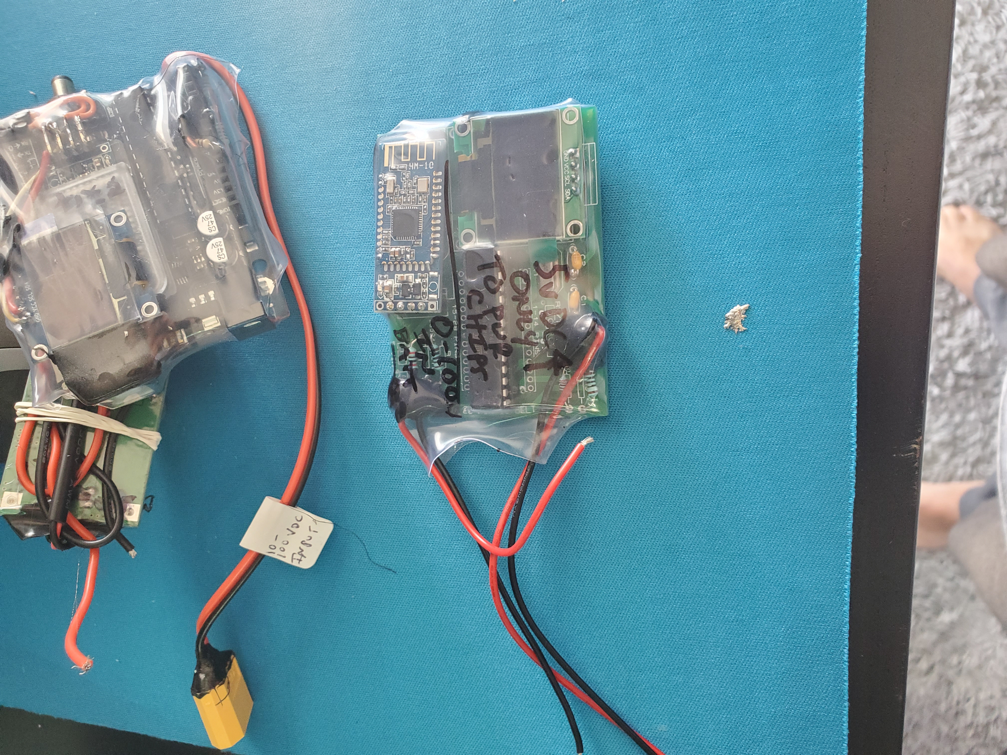

Big fan of the DAVEGAX. Best thing since meat-in-a-can. @janpom had a rash of bad WIFI boards a while back that he was incredibly quick to fix. I came across this on github: https://github.com/kolins-cz/Smart-BMS-Bluetooth-ESP32 and I had recently bought a Smart BMS (LLT, Xiaoxiang with BLE adapter). I thought I might repurpose that bad board into a battery checker. Here’s how I did. Had to cut/reroute two traces to deconflict the Bluetooth adapter but it was otherwise a fairly straight forward gig. Doesn’t have to be a DEVEGAX either. Parts list and a basic how-to available if anyone is interested. It is designed to be a quick “howgozit.” It shows relative mV off pack average. (I think @janpom did something similar) Thin line is better. Powered straight from VESC from an unused 5V servo rail. I’m gonna to wrap it in some 3D printed love and find a home for it somewhere under my board.

Can you please elaborate on this? Did you connect a bluetooth adapter to DAVEGA?
TFT DC and RESET ran to pins 22 and 21 on the ESP respectfully. It turned out that the BLE on the ESP32 was using those two lines. Because the BLE was working like a champ, I elected to cut those traces and run DC and RESET to 17 and 16 respectfully. Serial bluetooth code in that GITHUB repository is rock-solid. The adapter connects immediately after the board powers up.
In hindsight, I could have reassigned the blecomms hardware serial to move it out of the way. I find working with Bluetooth to be frustrating so I wasn’t about to fix something that wasn’t broken. In the end it was an easy workaround.

I dropped the code over at GIT hub as a fork of the original(https://github.com/markandkymward/Smart-BMS-Bluetooth-ESP32) The hardware should be just a generic ESP32 and the display is a 2.8in TFT 240x320. You can decipher the wiring diagram from within the code. Programming follows the same process as Arduino programming, you’ll just have to google how to bring the ESP32 into that toolchain - also fairly straight forward.
