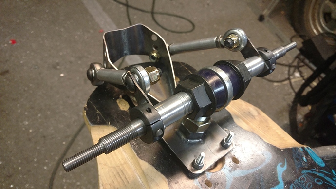

me… from my background (off-road racing) i see the links as the heim-link connecting the axle to the board as one link… the other 2 visible control links are the other 2.
9e60a781f5c2352b9f01dac7bafa83a0a6c6466c_2_690x388
@MoeStooge the inventor of the 3-link trucks (and name) actually commented that his design was a modified 4-link and had a drag link to center the axle, (my words from here on out)… I can see that… the bushing set-up is actually a modified drag-link that controls axle centering
The pocket protector wearing guys and I had an interesting discussion that the board was the 4th link… but that’d mean the drag link was an additional link and therefore would be a 5-link
Moe calls 'em 3-links and so do I

how difficult were those 2 pins in the hanger to get out? I assume it was pretty simple…
Let’s just say it’s a good thing I work in a machine shop. The whack’em method didn’t work, needed to use a press. The pins were mostly a press fit and there was also red loctite. They were removed with a hammer and punch. Now if I can just get my replacement axel…
