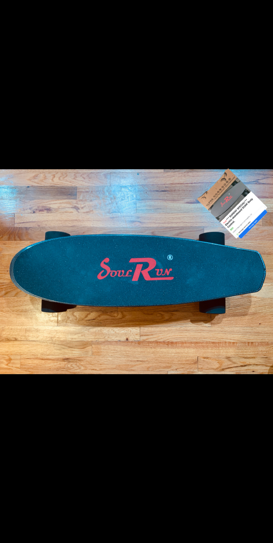

Cool deck, where did you get it?
Got it from a local seller thru facebook. Was trying to get rid of it. And it’s called ā€œBody control electric skateboardā€ if you check alibaba.
Other similar boards,

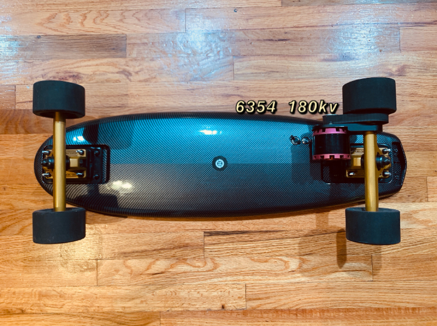

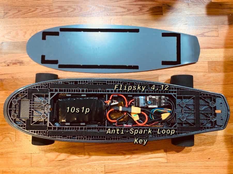

Your deck cracking?
Yep :sob:
best thing you can do right now is CF/GF skinning of the top and bottom creating a sandwich construction :confused:
should be doable using only a clothing vacuumbag
Man that sucks. I wouldn’t trust just glue. Carbon fiber or fiber glass is definitely the way to go. How long have you had that deck?
That’s a good idea, main problem is that is a lot of work, mainly to remove the batteries without damaging them and more money sunk into it without guarantee it would hold
I will probably mark all the cracks and monitor them to see if they increase
I feel like its just a matter of time at this point.
Unfortunately, really weighting my options right now, all of them a bit too expensive at the moment
Are the batteries siliconed to the deck? The curve till it completely cracks should be exponential, I would not risk it.
Try finding a plastic spatula or scraper so that you don’t accidentally damage the cells
