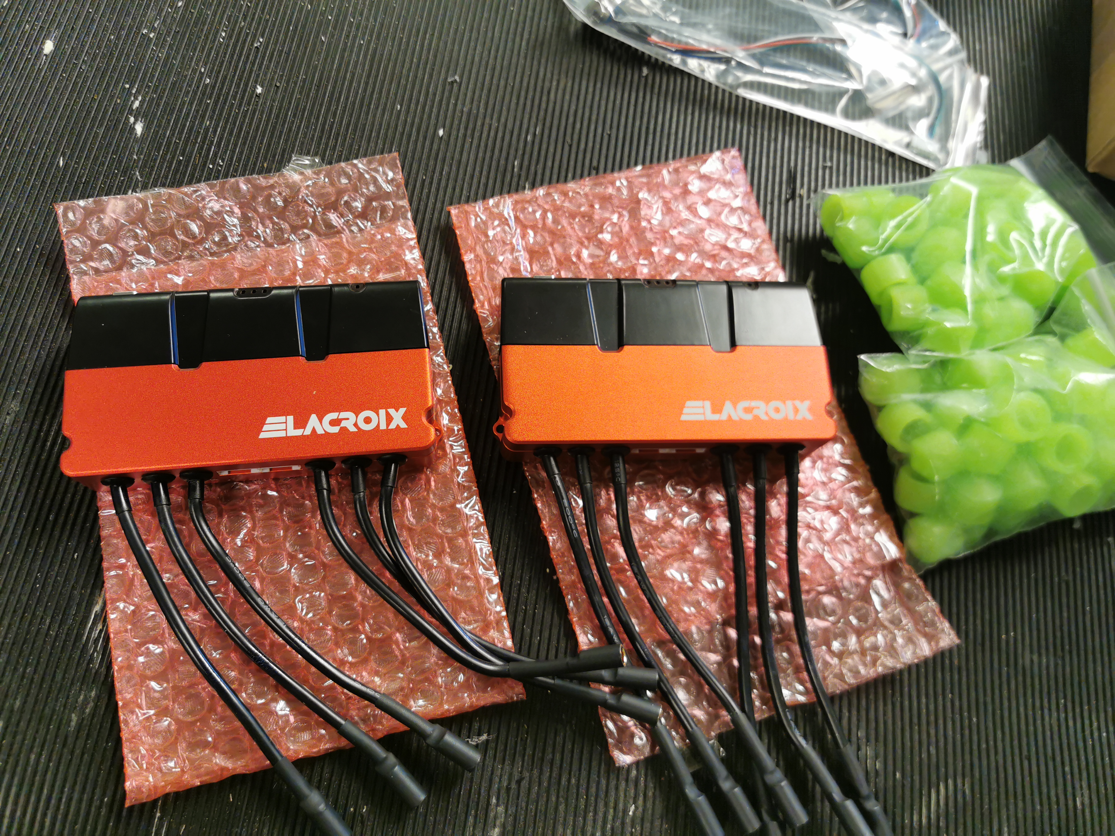

just what I’ve read on the spec sheet my man
:man_facepalming: who trust spec sheet?
you have a valid point lmaooo
We make electric car motor for more than 20 year. Your spec sheet is like a balloon, inflated.
ay it isn’t mine. it’s for a friend. the spec is what zill is specifying. so might need to see real life testing there.
Better to not advertise these numbers until it can be confirmed by a friend here.
