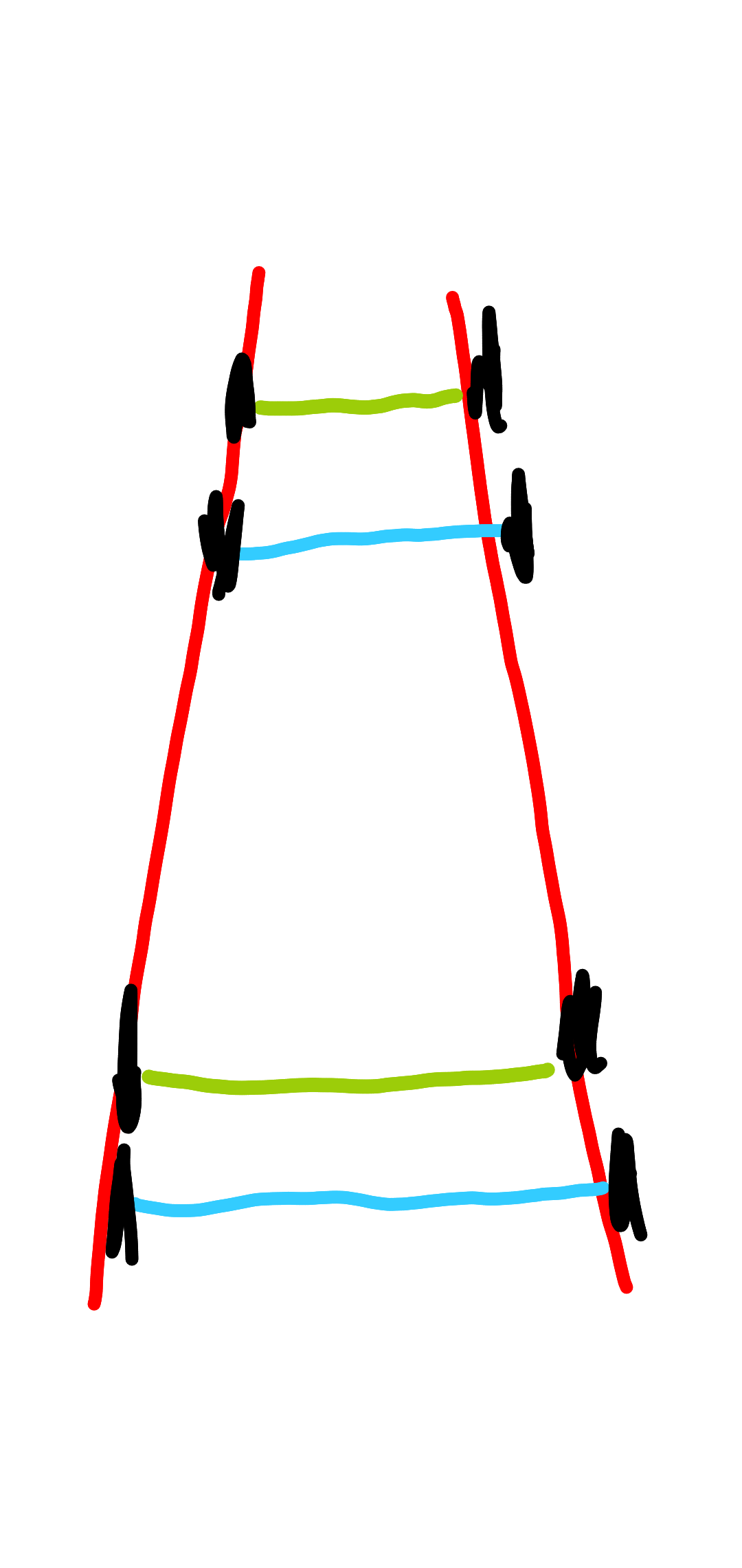

So in my current setup, I have the front of the deck slightly lower than the rear but equal wheel spacing.
Would I get an improvement by removing a spacer in the front? Or only by widening the rear further?

Pardon the crude drawing:
If green and blue are 2 different boards’ trucks and the red line is the track between front and rear wheels (equal angle between both boards) , would widening the entire system provide a more stable ride?
Or revert to previous answer :stuck_out_tongue_winking_eye:
I don’t know, but I would go for blue layout that’s closer to nose
I’m trying to make sense of this :thinking: @Dred
Looks like a POV time delay shot of someone puking from all orifices.
Lmao. Pineapple, coconut slice or peach and a blue flower :smirk:
