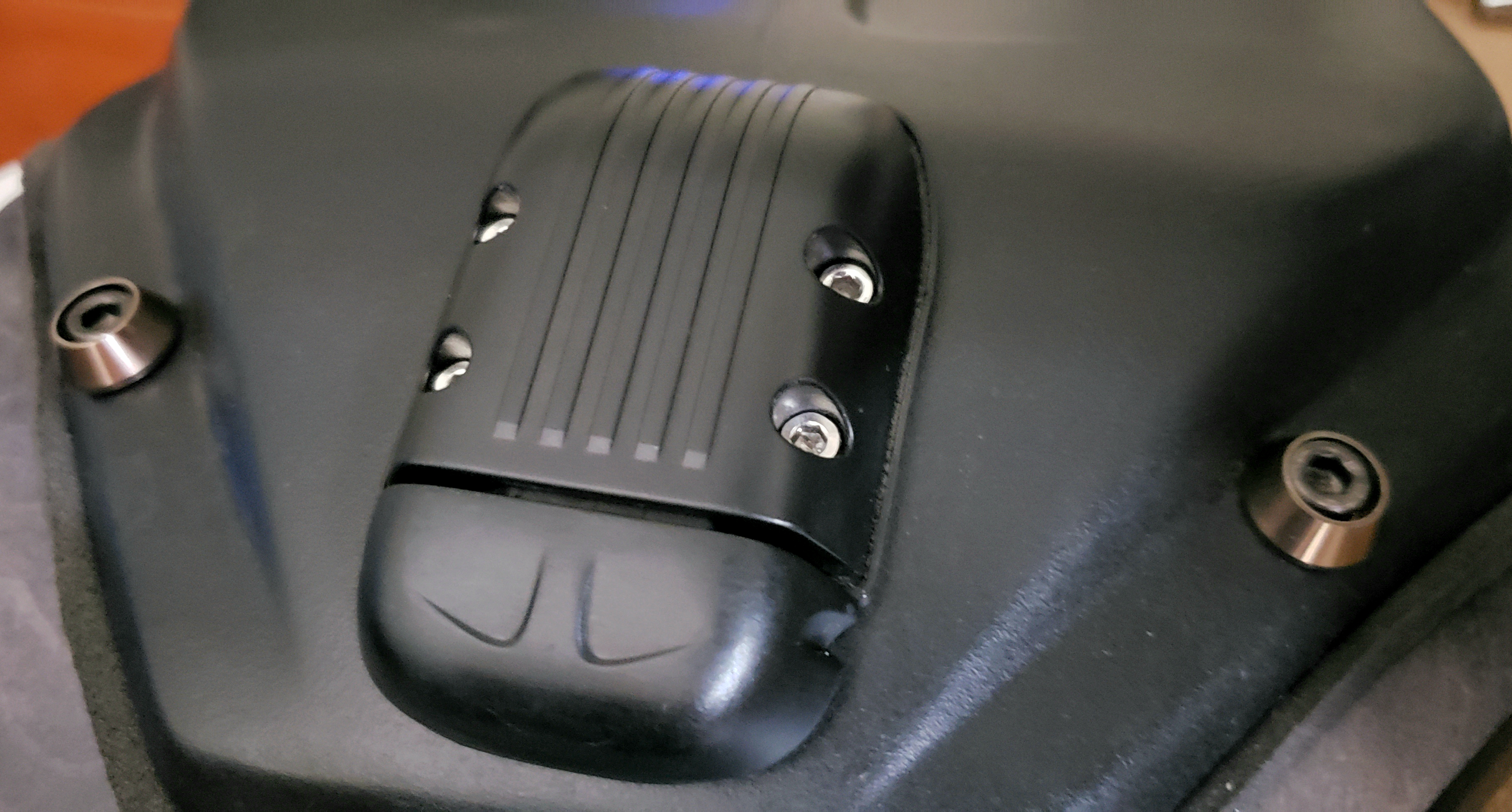

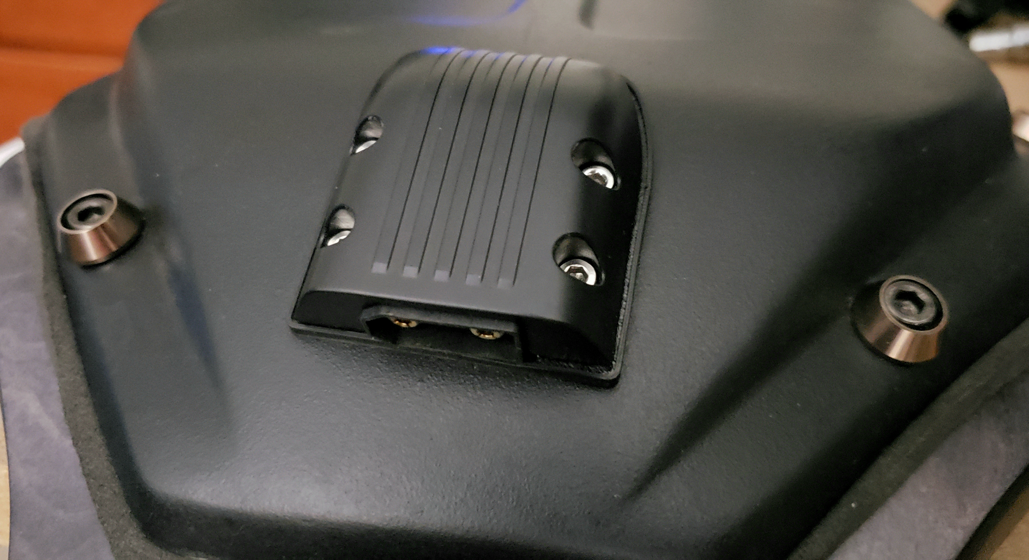

Can we have the files for that?
Also is it for charging or loopkey?
Cleanest loopkey design I’ve ever seen, it’s so sexy!

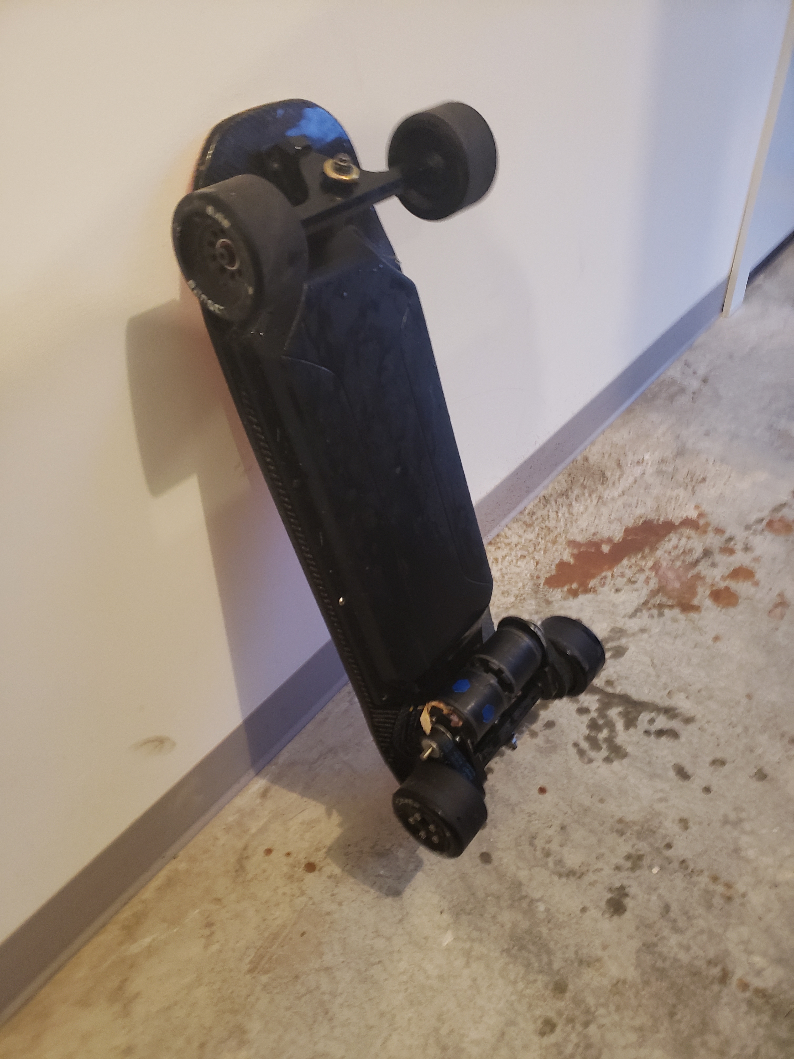

The battery fell out of the board and shredded the PWM wires…I just wanted to do a test ride to the lady friend’s place, it’s not even a mile and now it’s back to the bench for wire repairs
As a note, do NOT use cheap seran wrap to hold a 20 cell pack…it doesn’t work
Also it’s raining so I can’t do a proper test…we’re back to analoging on the shit board for a while
I’ve heard that one before
It shattered the heat shrink so I’ve gotta open it again and check for damaged welds later

Yeah I’ll upload them too. I’ll have to show how it’s assembled because there’s also a TPU gasket. I used up all my space inside so things like this happened lol. I have a 200a 3D servisas switch but turns out it was draining my battery too much over winter so I had to get creative and install a loop key.
Well, you came up with a fantastic solution!
What material did you print it with, it looks so clean?
SLA prints are on another level. Get yourself an Anycubic photon, then if you want to take it a bit further get a Z axis upgrade. Resin is brittle though so it has limits, perfect for stuff like this.

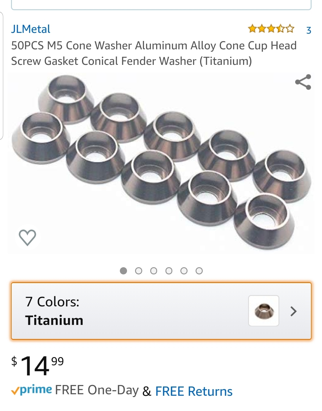

are those m3 counterbore washers? Im trying to find those in the same colour
they were a compromise and I don’t really recommend them, agreed finding these in the right size and color isn’t easy
Ah ok, Ill get ā€œtitanium coloredā€ ones since the ones on the prototipo are black and come with phillips head countersunk bolts :expressionless:
