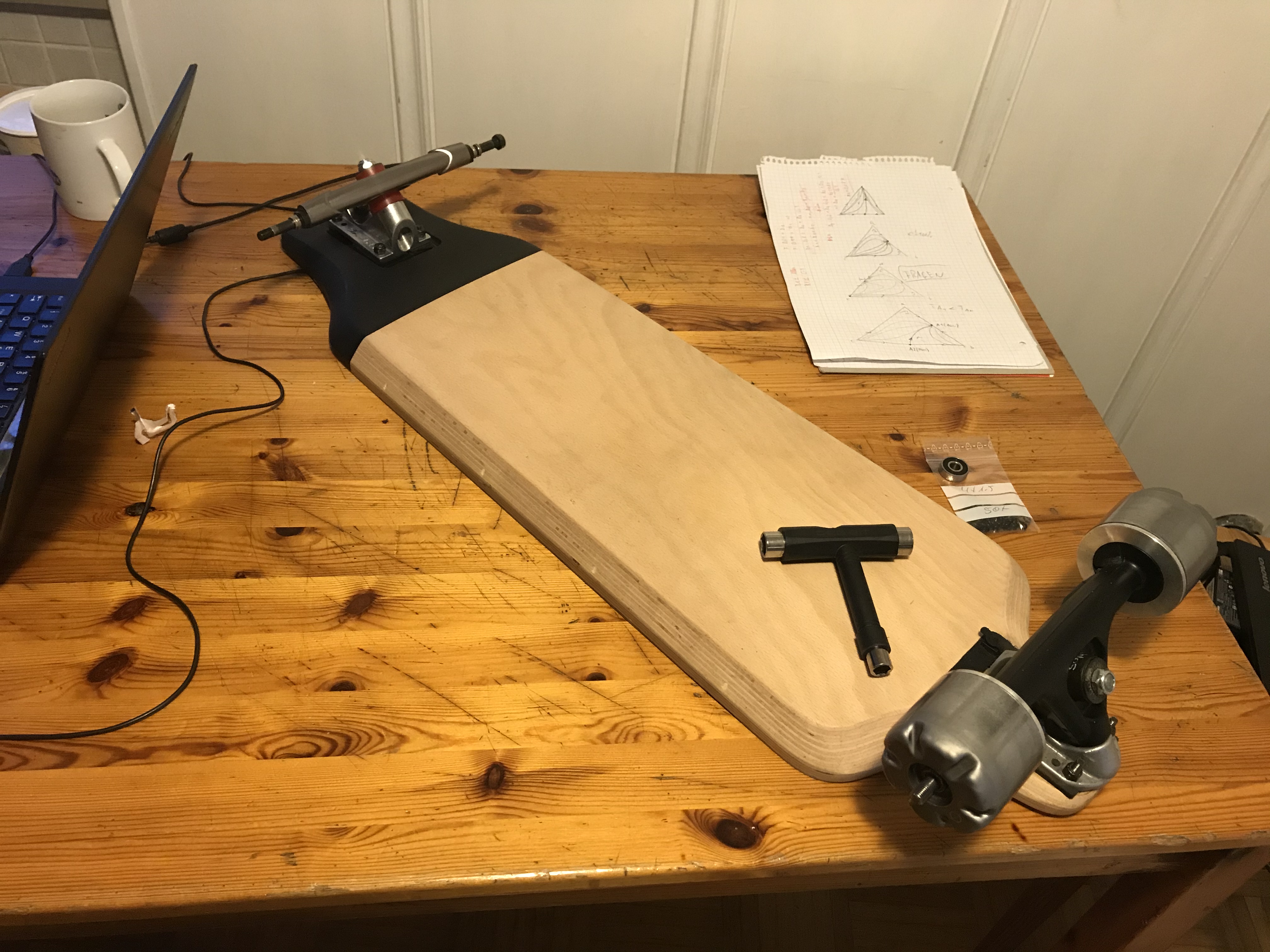

What are these silver things on the truck? They look neat :man_shrugging:
Mellow hubs, got them from @visnu777
Im preparing my travel board, I want it to be as simple and reliable as possible. I hope my modular battery pack does not get confiscated @ TSA
lightness ist also a plus, but im still at 7.3kg…

Will you power them hubs on 7s what they are designed for,like mellow does originally, or are you going 99s1000p like its trendy and always wanted?
Edit I need some, too in the near future, thats for sure!
You will make it, Moe! I believe in you!
Im so curious about any invention on your boards, always from another galaxy imo and monster professional.
10S3P, they have decent torque, but stopping power is low at moderate settings, I will have to pump the negative current quite high. Maybe even -100+ motor amps and -20A/Vesc
Short high current inrush pulses should not the a big problem, I hope…
I think the same, there are so well done that this should work out and Michael already tried them on 10s, unfortunately only on his bigger diameter mods. That worked technically.
Will you use the modded sleeves from @visnu777, too or are you going to add new original ones?
Original 80mm ones, I found some new ones in Ebay Kleinanzeigen for cheap. I am also using kegels on the back truck
yeah thatspretty cool, so you will get the real performance them hubs can do. Why insnt 7s4p or 7s5p not an option for you? I think it will make all components much more reliable, or what do you think?
my modules already set up for 10s3p, and Im a bit in a hurry and I have no time to redesign anything
