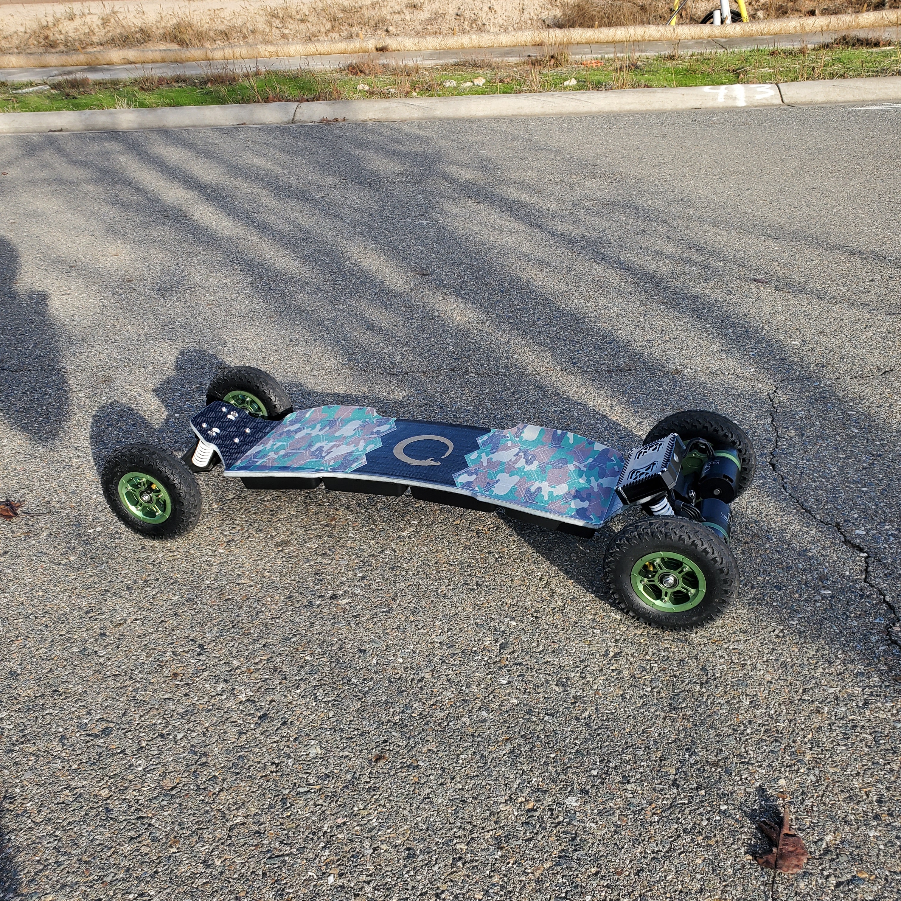

:clap: Congrats mate !! Love the green theme of this Kaly monster :heart_eyes: Lovely muscular setup !!

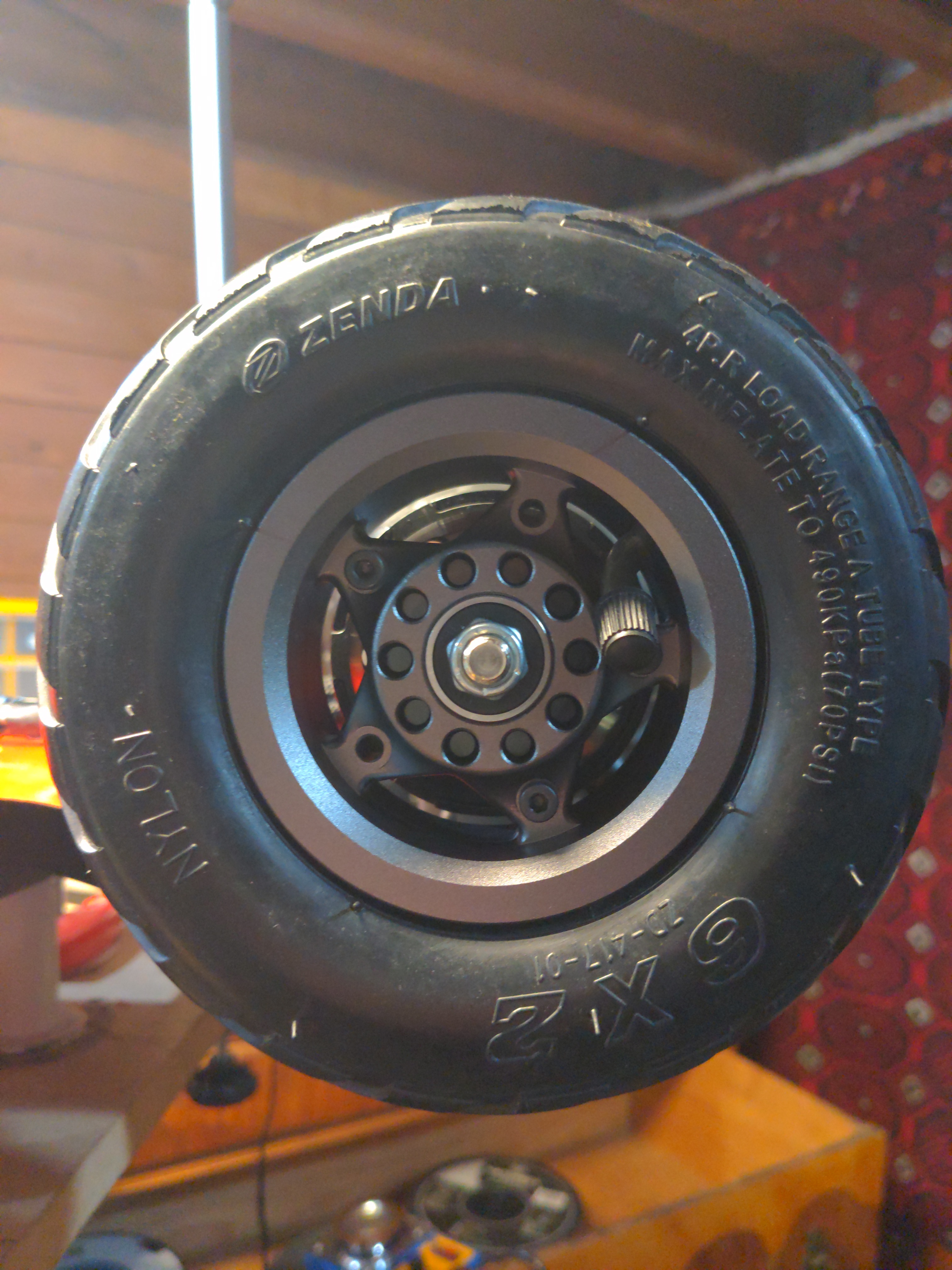

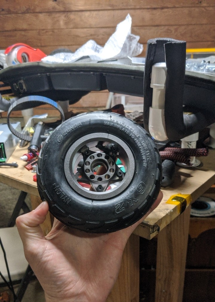

What are those wheels

Mockups. These are going on my 2nd Kaly deck anyway, I think.

Those aren’t hubs, they’re joint holders. :wink:

Oh okay. Makes sense now

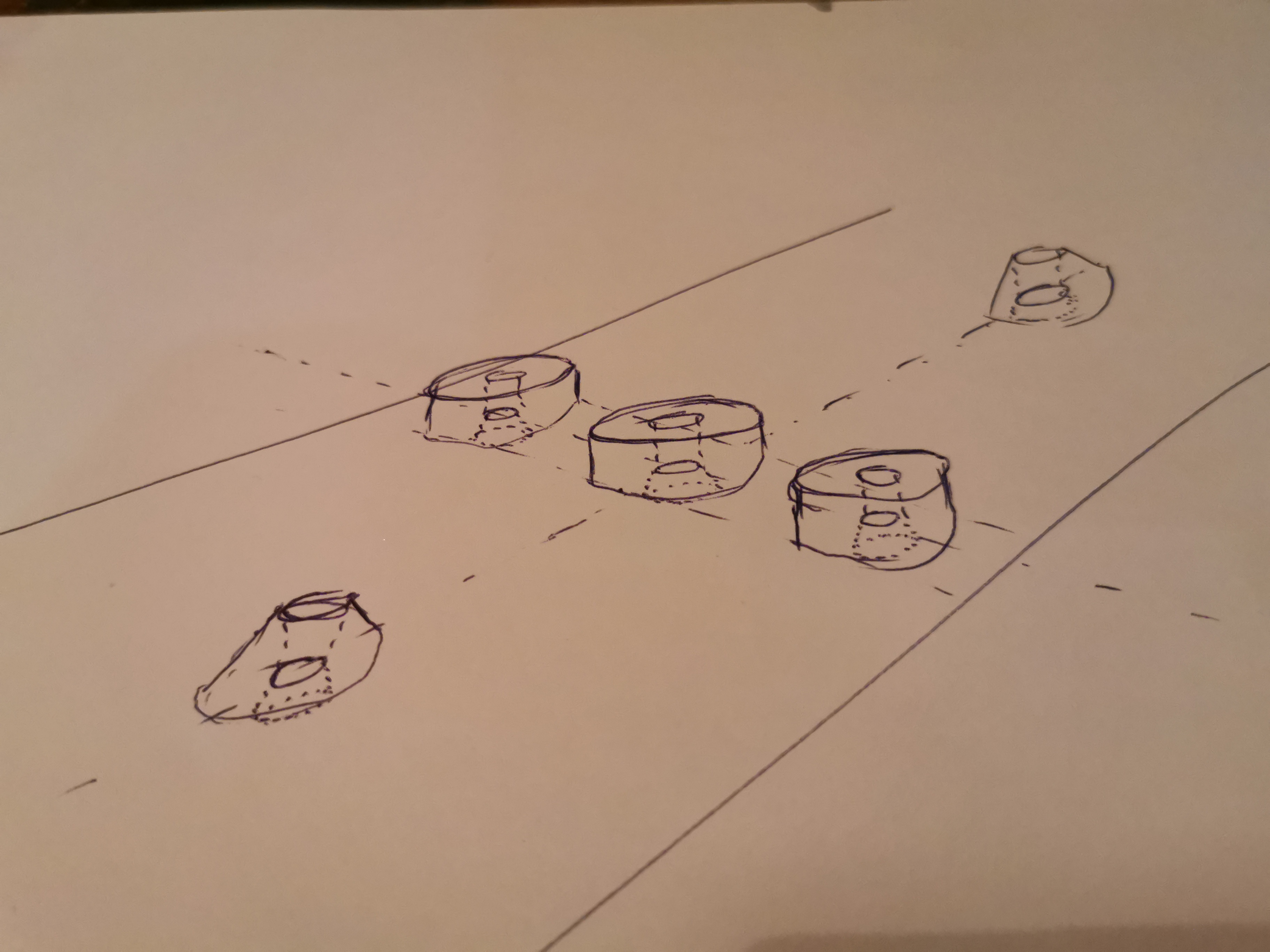

Trying to keep that thread for pics and specs only so I’ll reply here…
I use thick rubber washers under my enclosure. It waterproofs the holes and dampens the vibrations really well. Also protects the deck from the box scratching it up.
008236707670
Other than that, I use big thread inserts epoxied in.
Yeah, sorry 'bout that.
So here’s what I’m thinking of doing… and I think this might be what Trampa is doing, but I’ve never had the opportunity to check:
Three holes through the deck along its width at the midpoint, countersunk at the bottom. These will bolt into the enclosure.
Two further holes along its length, which will not bolt into the enclosure.
I’ll fit rubber bushings on each of the four edit: five points between the deck and the enclosure. The bushings on the two holes at either end just support and dampen the enclosure. Since they’re not fastened to the enclosure, they won’t apply any stresses when the deck flexes.
My main concern about this approach is the weakness it might create in the middle of the deck. I’ve got a DWII so it’s pretty solid. Anyone any views on that and this approach in general?
