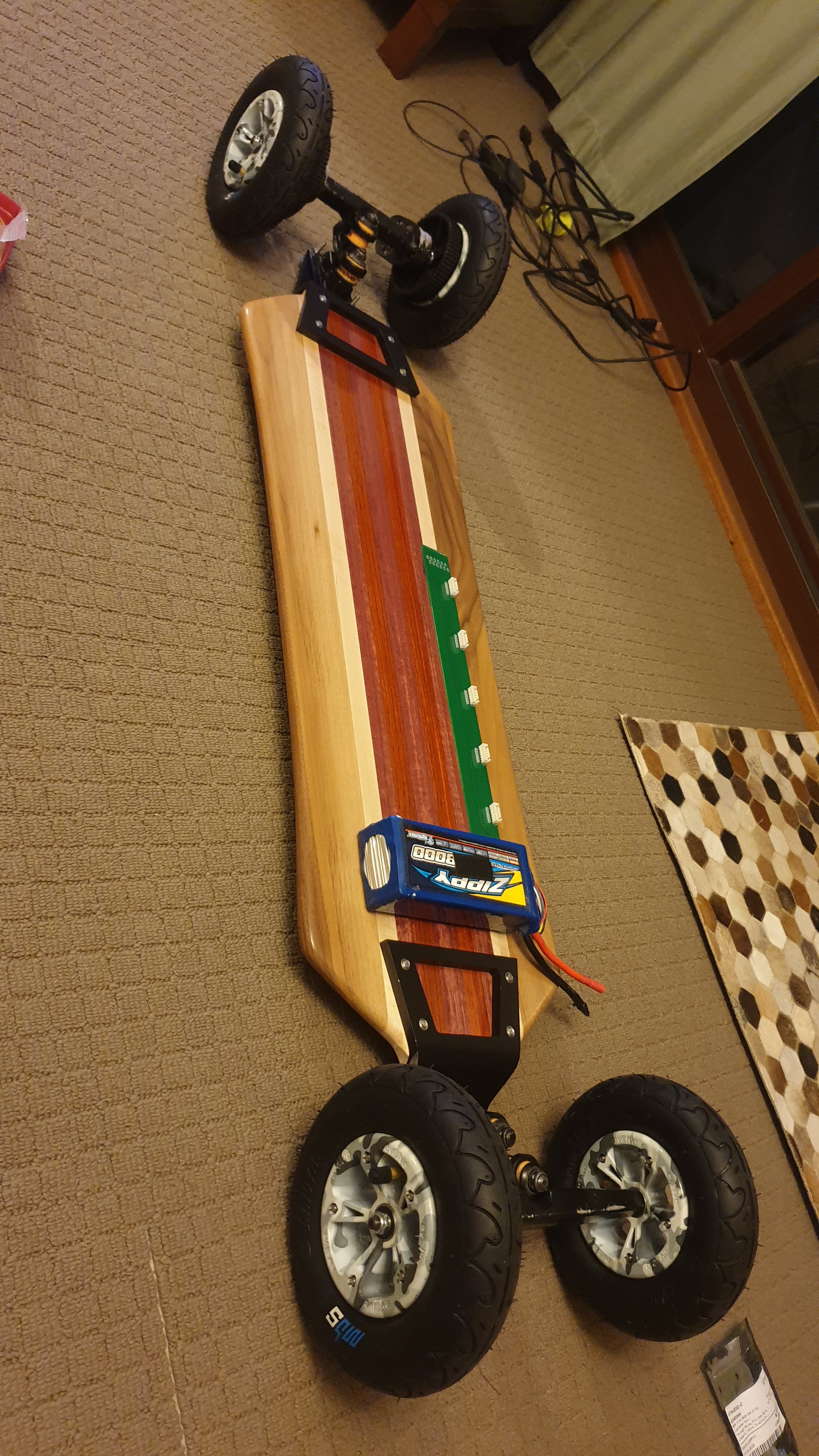

Damn bro, that is looking fresh! Did you make those extension brackets or buy them?
