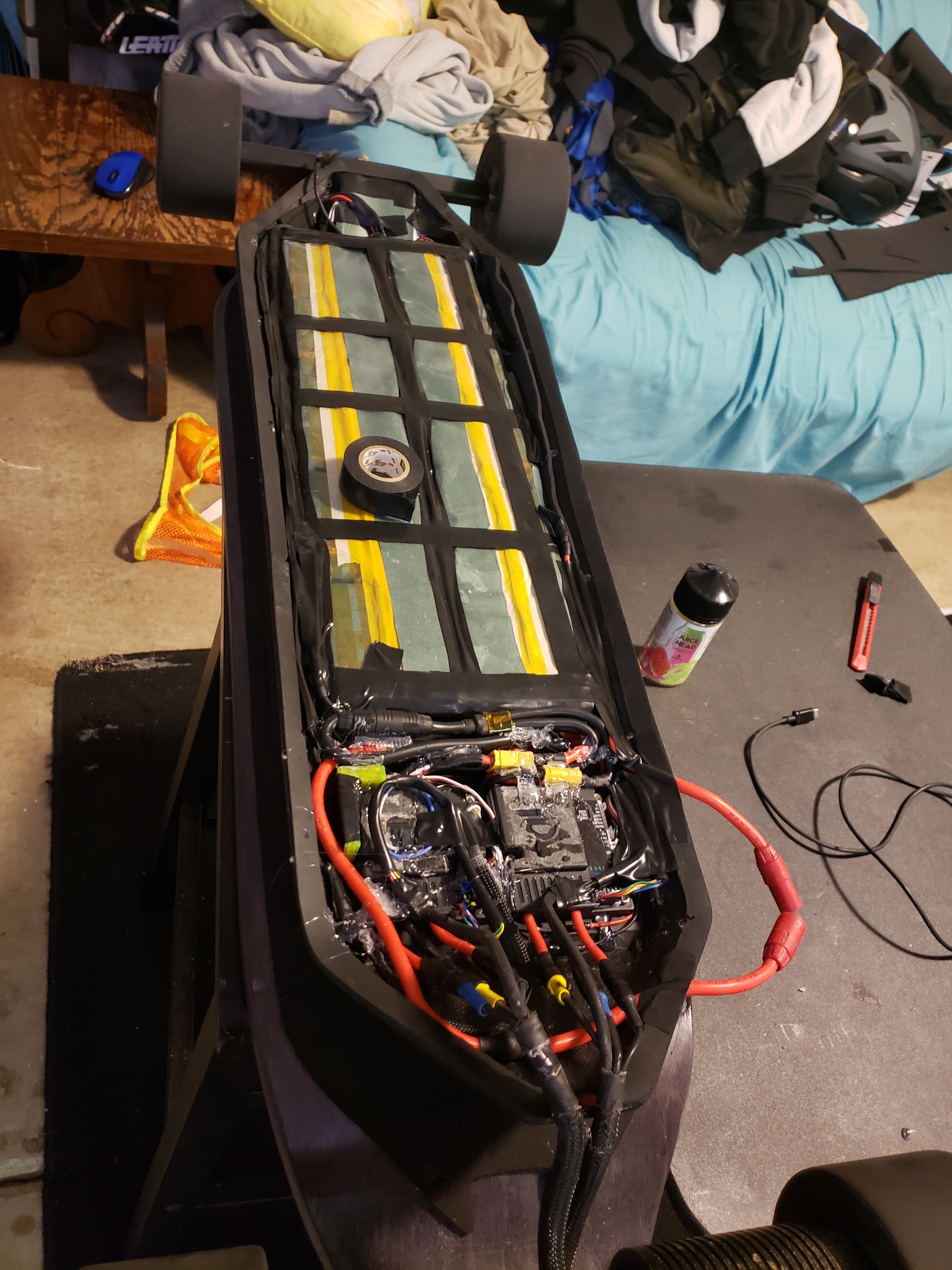

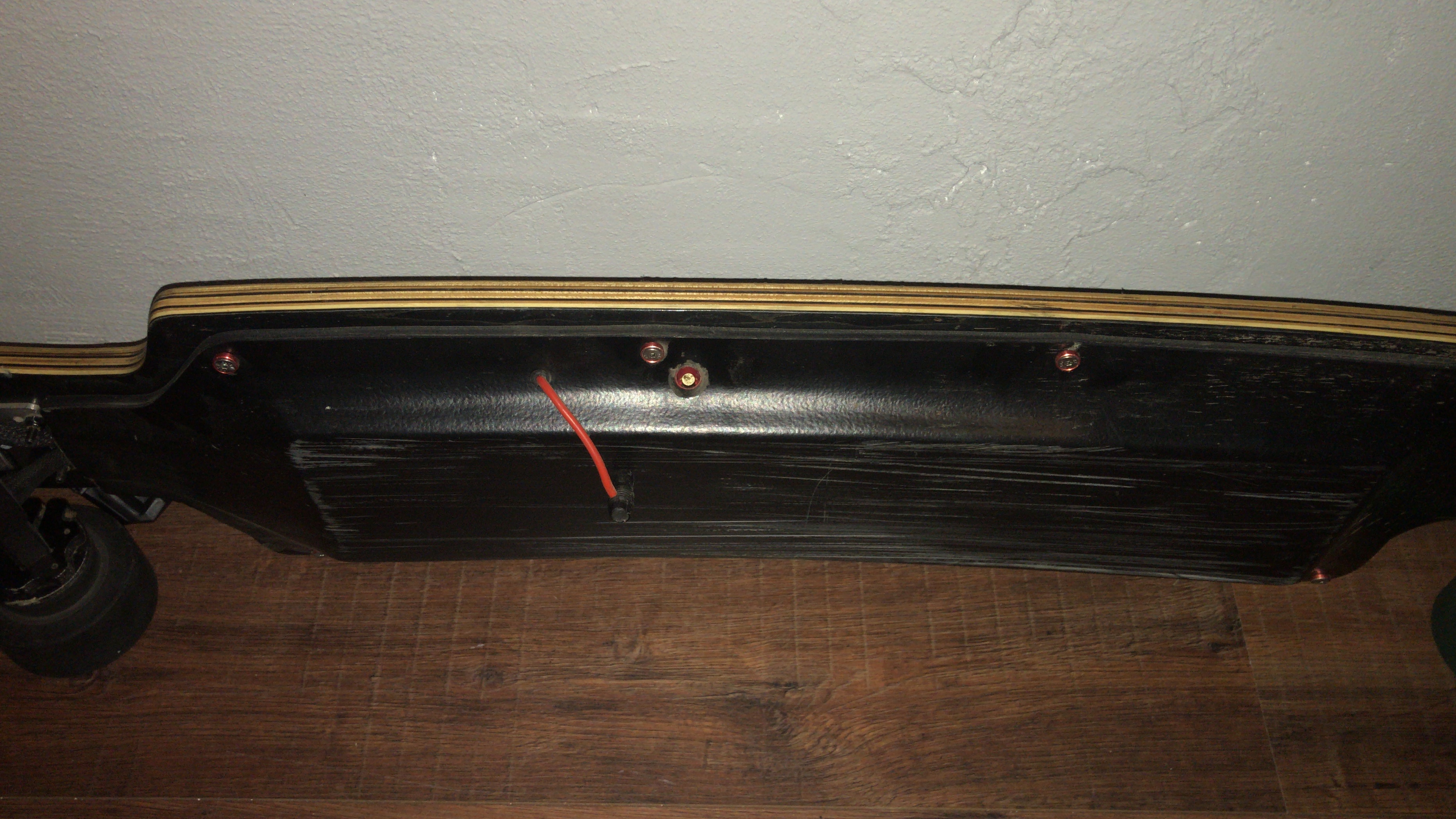

Same. I was surprised. Nothing a bit of drilling can’t fix tho. I just didn’t have the right tool to not do a complete hack job

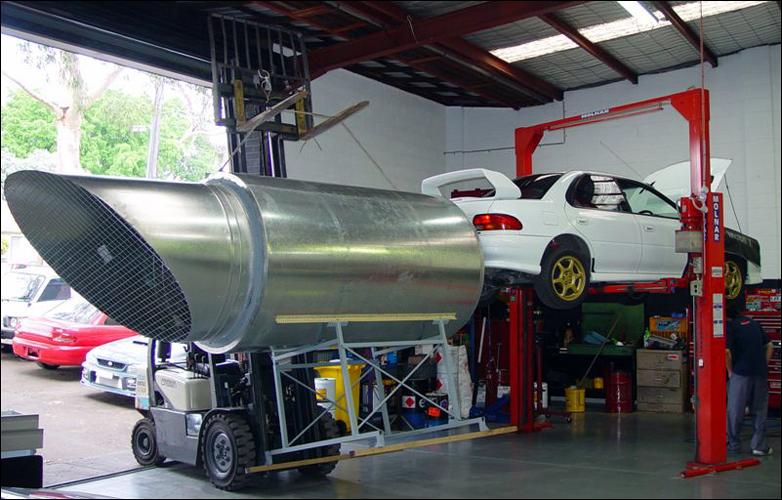

Would look nicer on a Honda hatchback civic :man_facepalming:
I know right. I couldn’t tell if that was a real scooby pipe or not :grimacing:

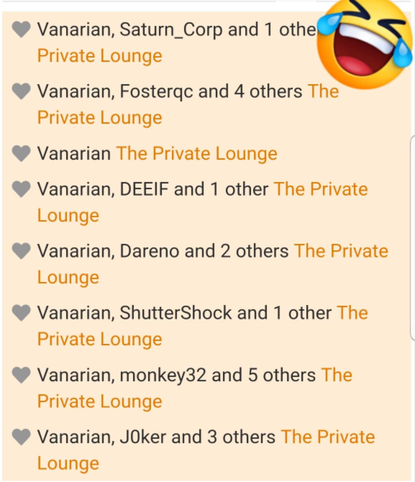

And you fags posting hundreds of messages while I’m away!!

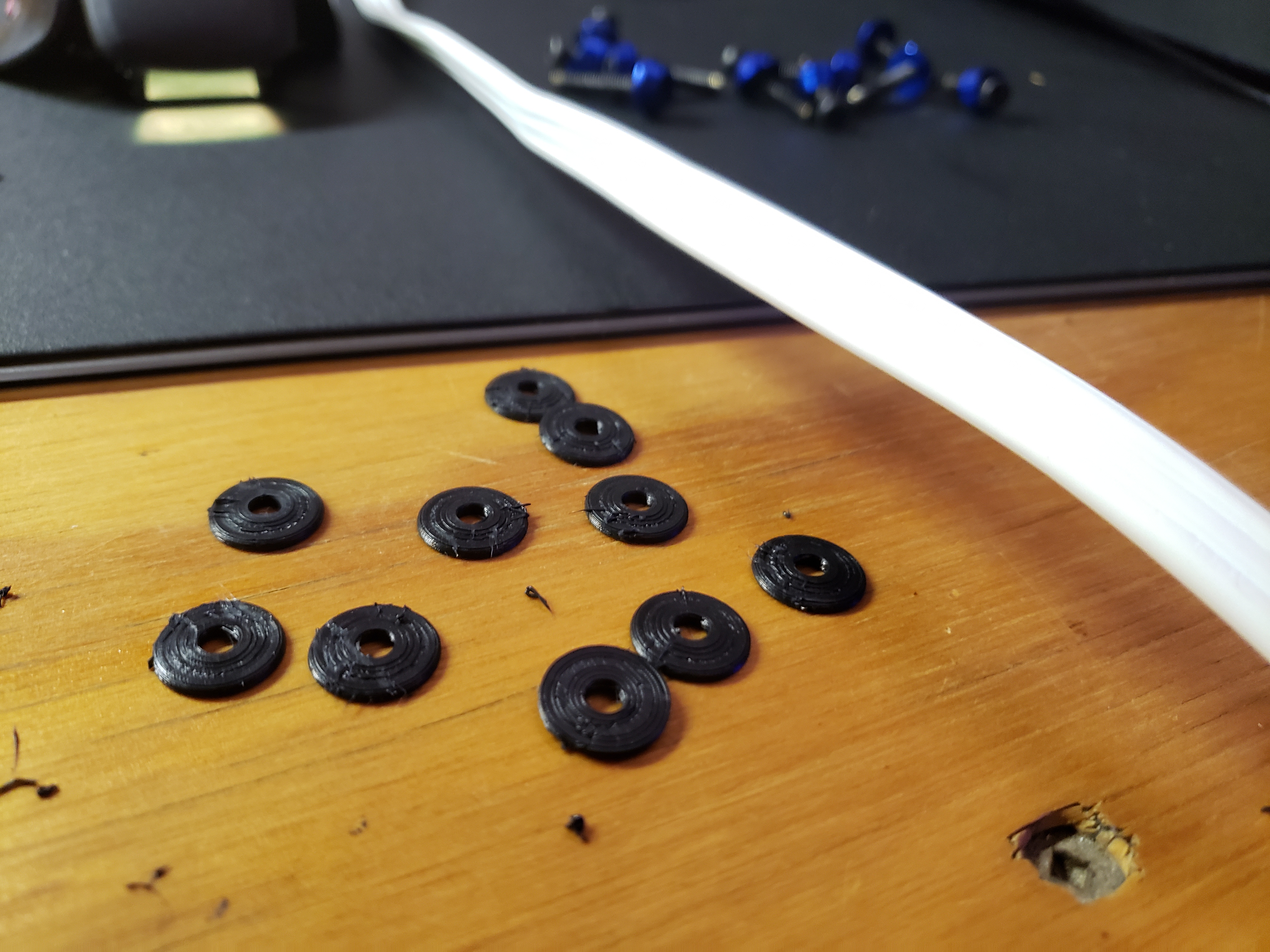

Spread evenly :rofl:
I’m getting overwhelmed here :crazy_face:
Wait there’s only 11 here, here’s your twelfth :kissing_heart::joy:

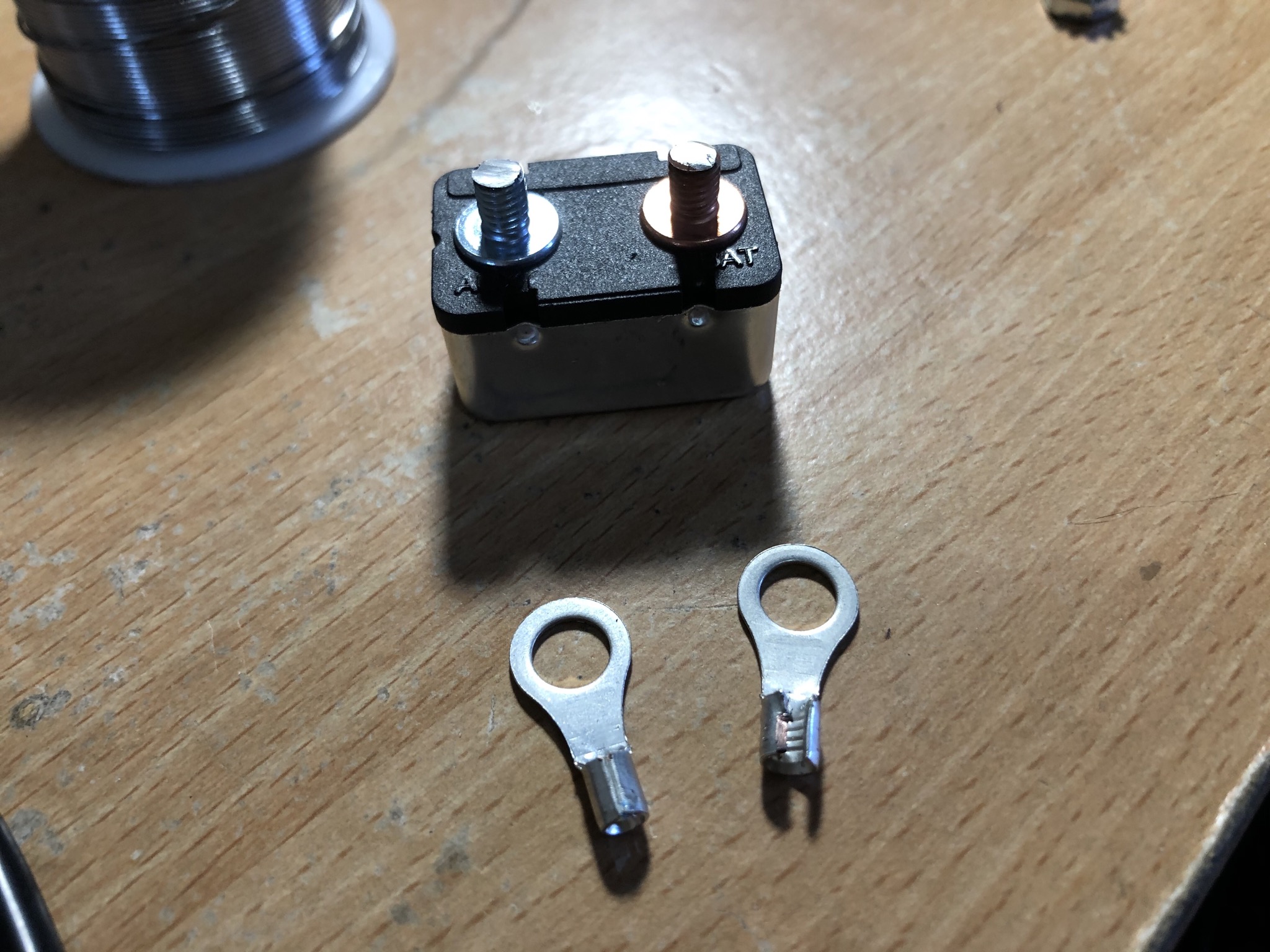

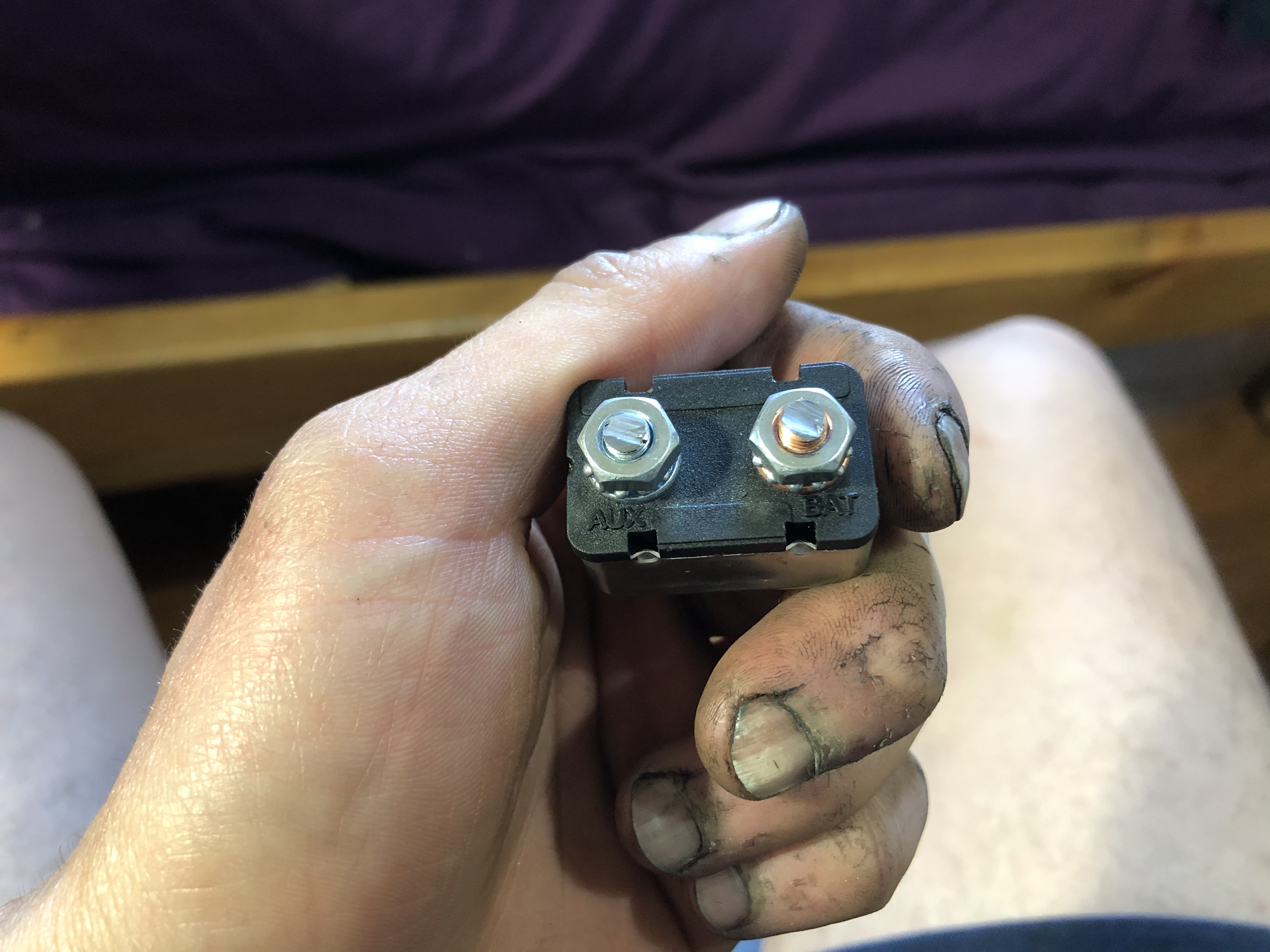

12/24v 50amp automotive circuit breaker.

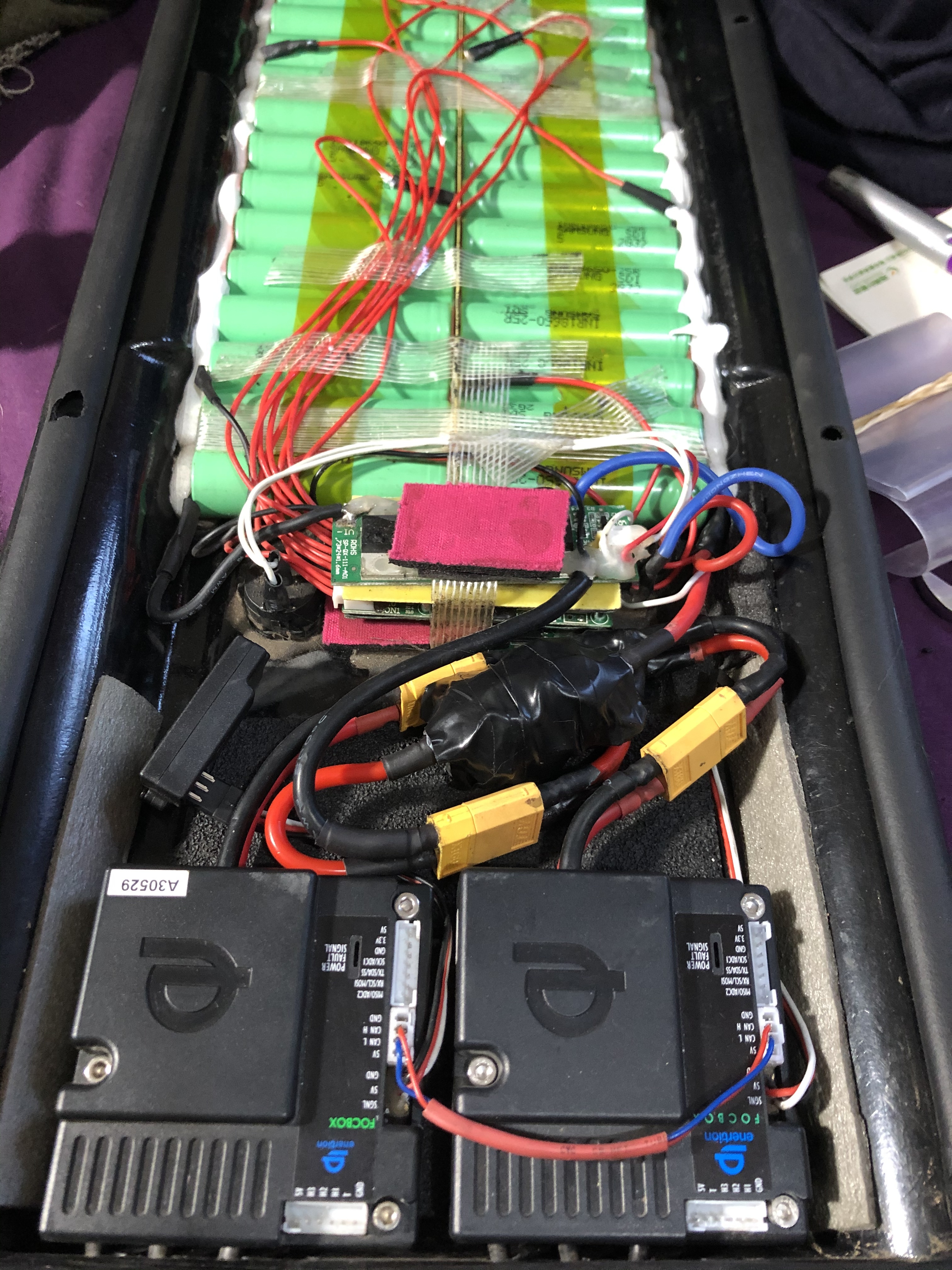

Same as the first china sourced evolve boards.

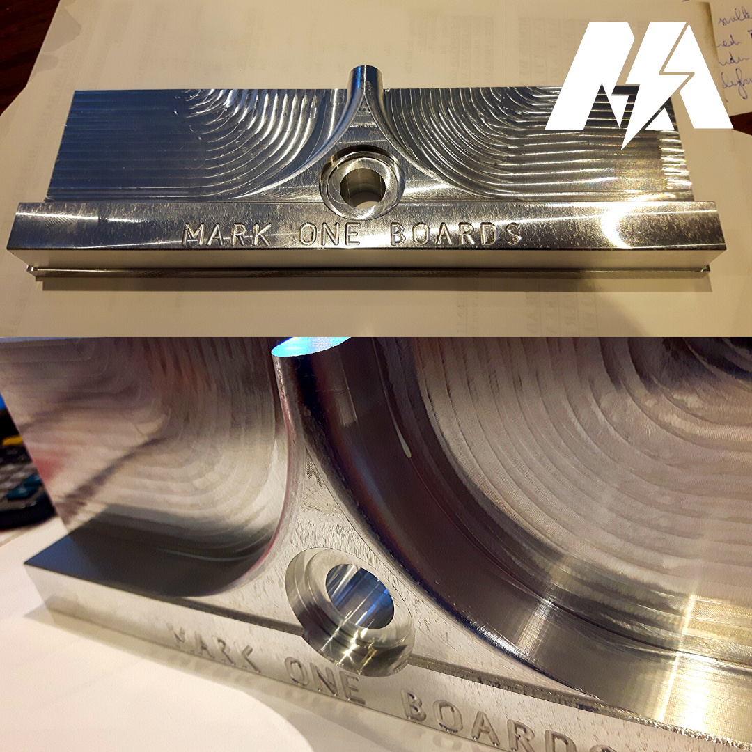

Work in progress:
  • Alu Alloy T6 6082
  • 240mm hangers
  • Compatible with Caliber & Paris baseplates
  • Software stresstests succesfull
  • Interchangeable axles (8mm and 10mm)
  • M12 secure threead
Still to do:
  • Real life stresstests (min 1000km)
  • rest of the CNC passes

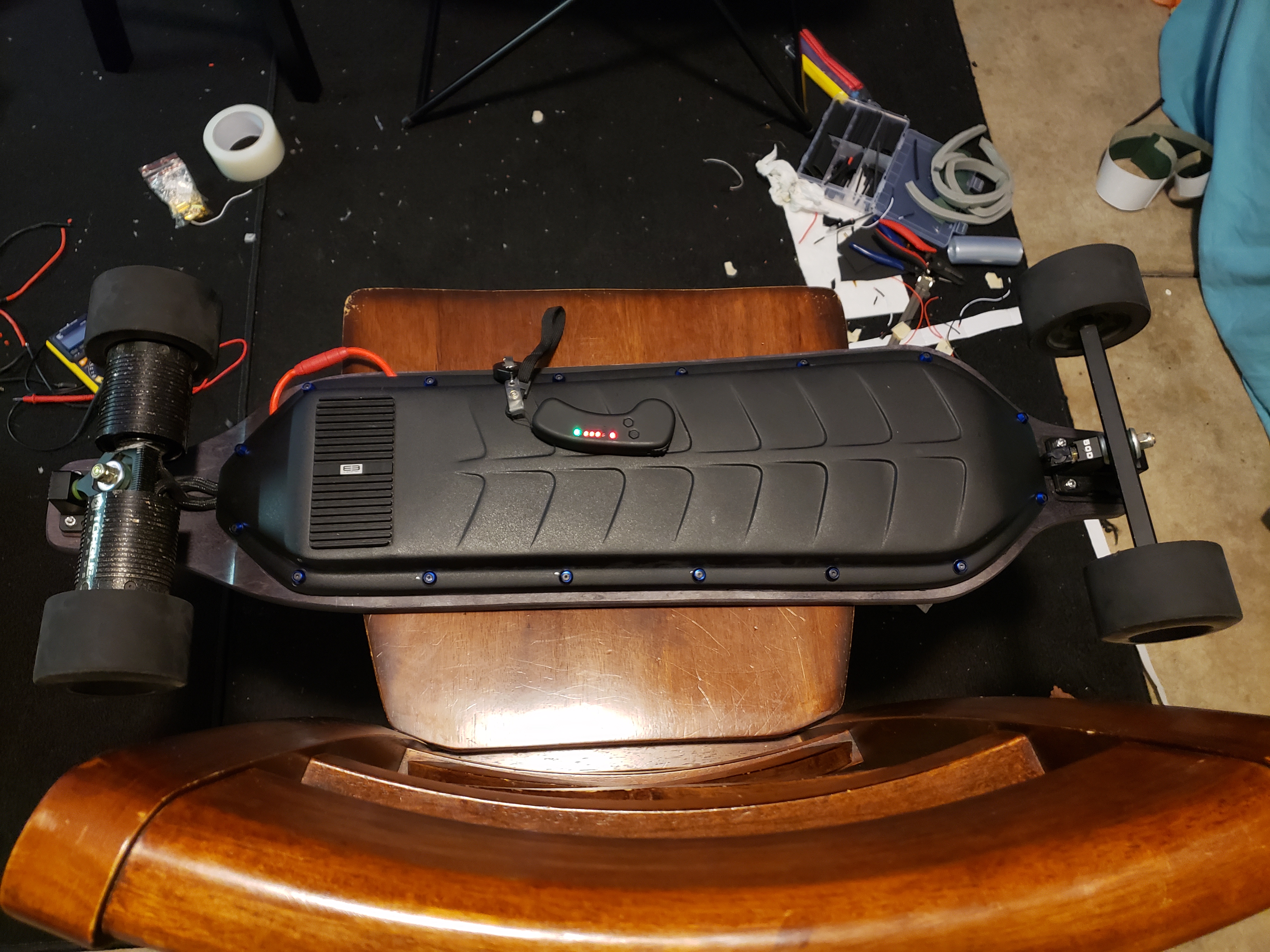

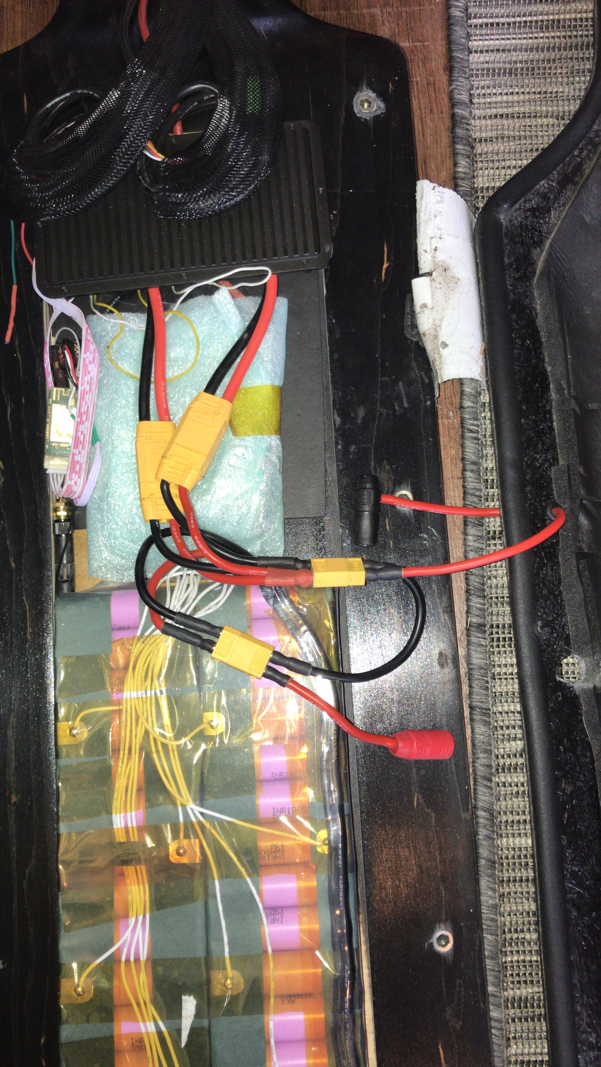

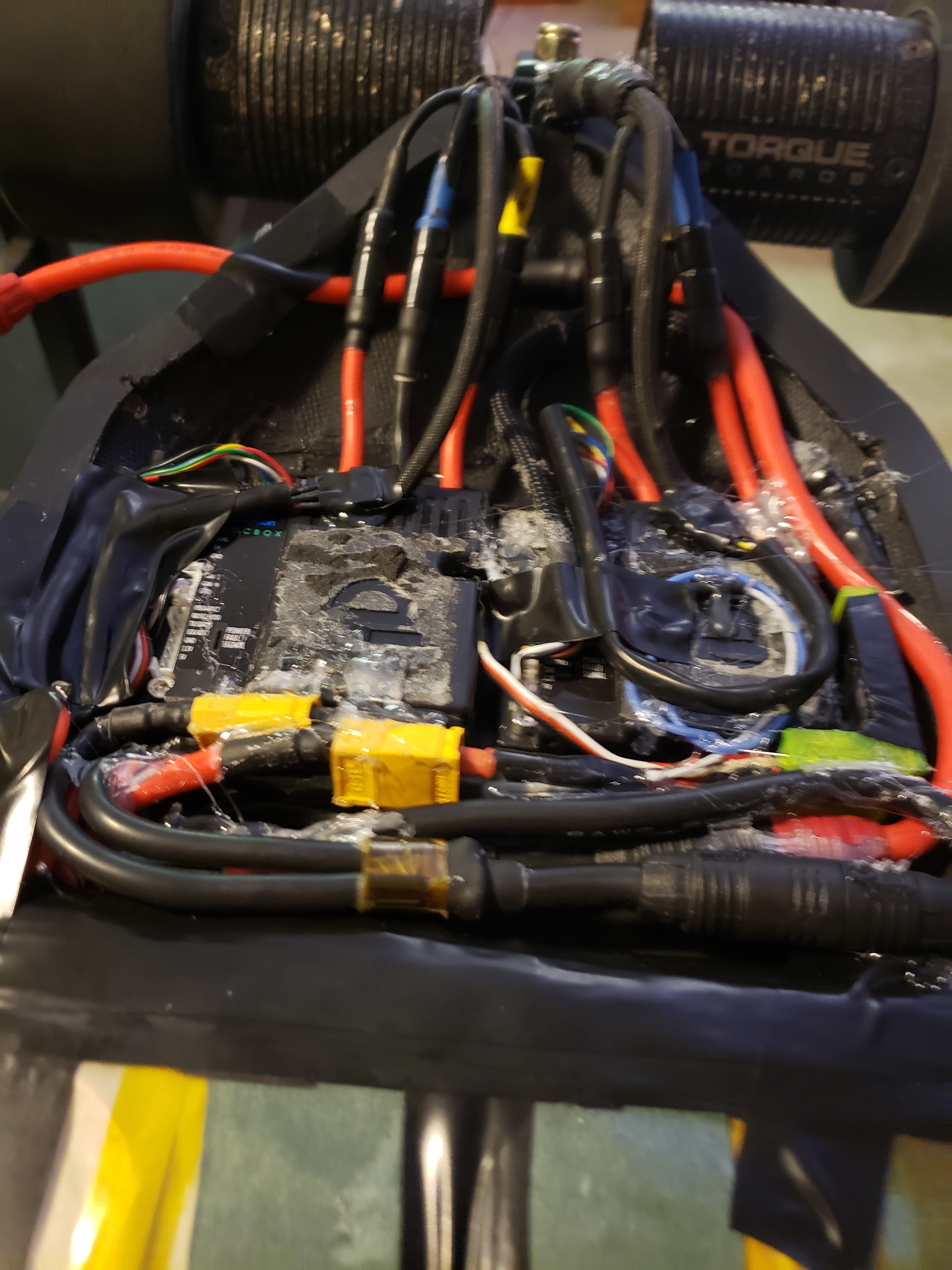

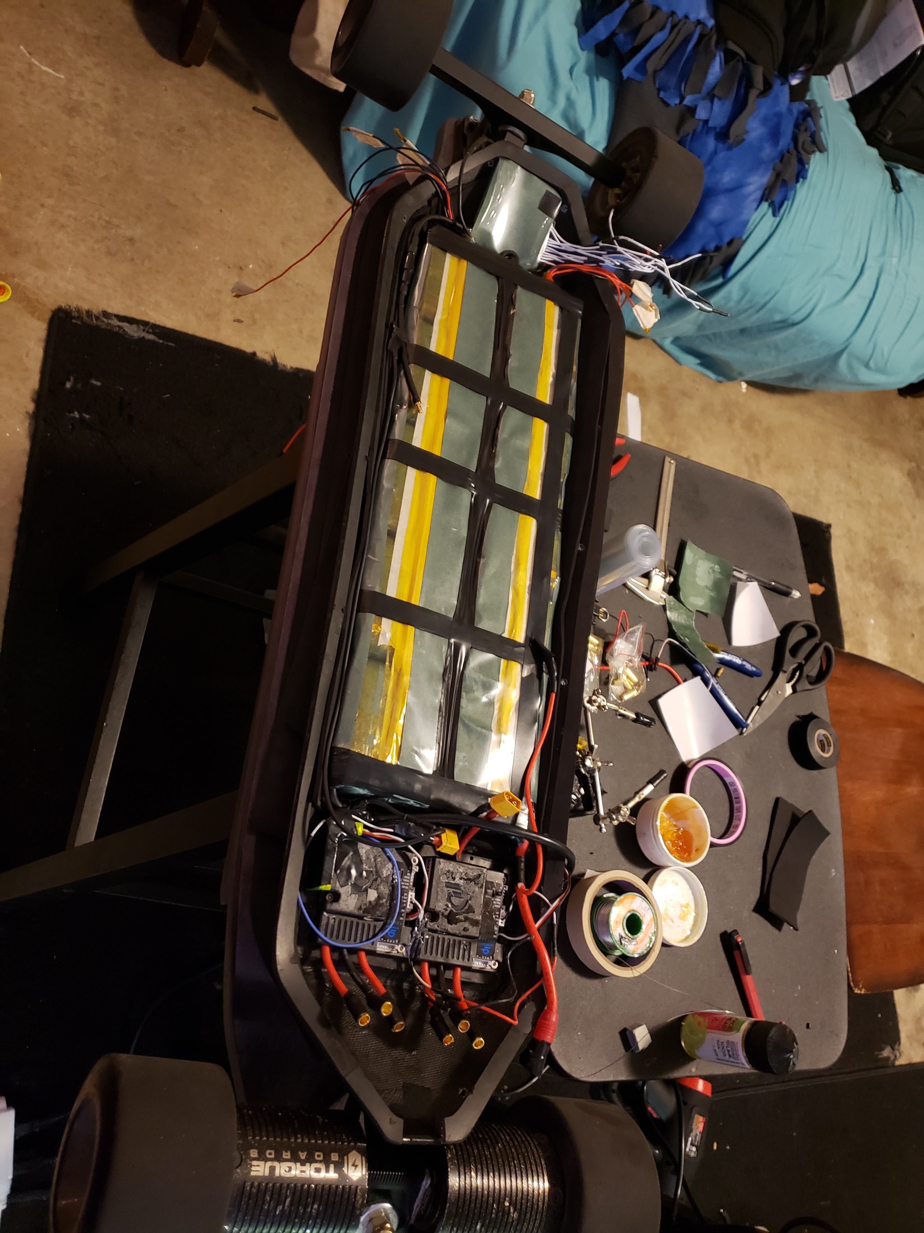

Why do you have both parts of the as150 on the outside? I notice there is enough space to have the male part fixed to the enclosure.
The two halves come together super snug, I didn’t want to hassle with making a right angle connection, don’t want more drill holes, time, I like it like this, don’t have sugru or the appropriate glue or epoxy, and I prefer a less permanent solution. That’s pretty much it.

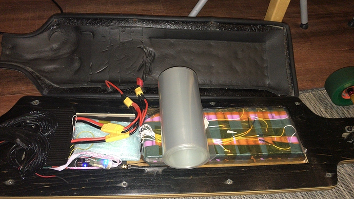

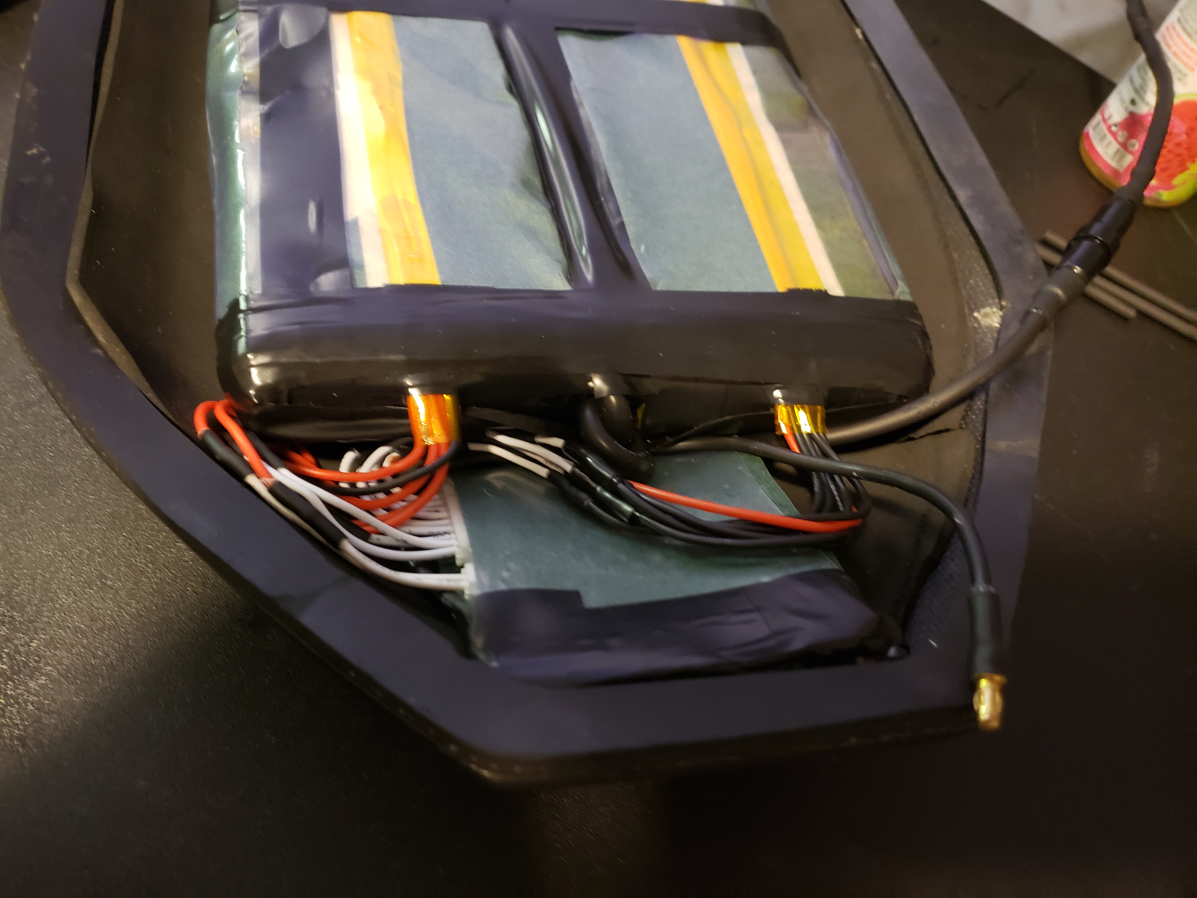

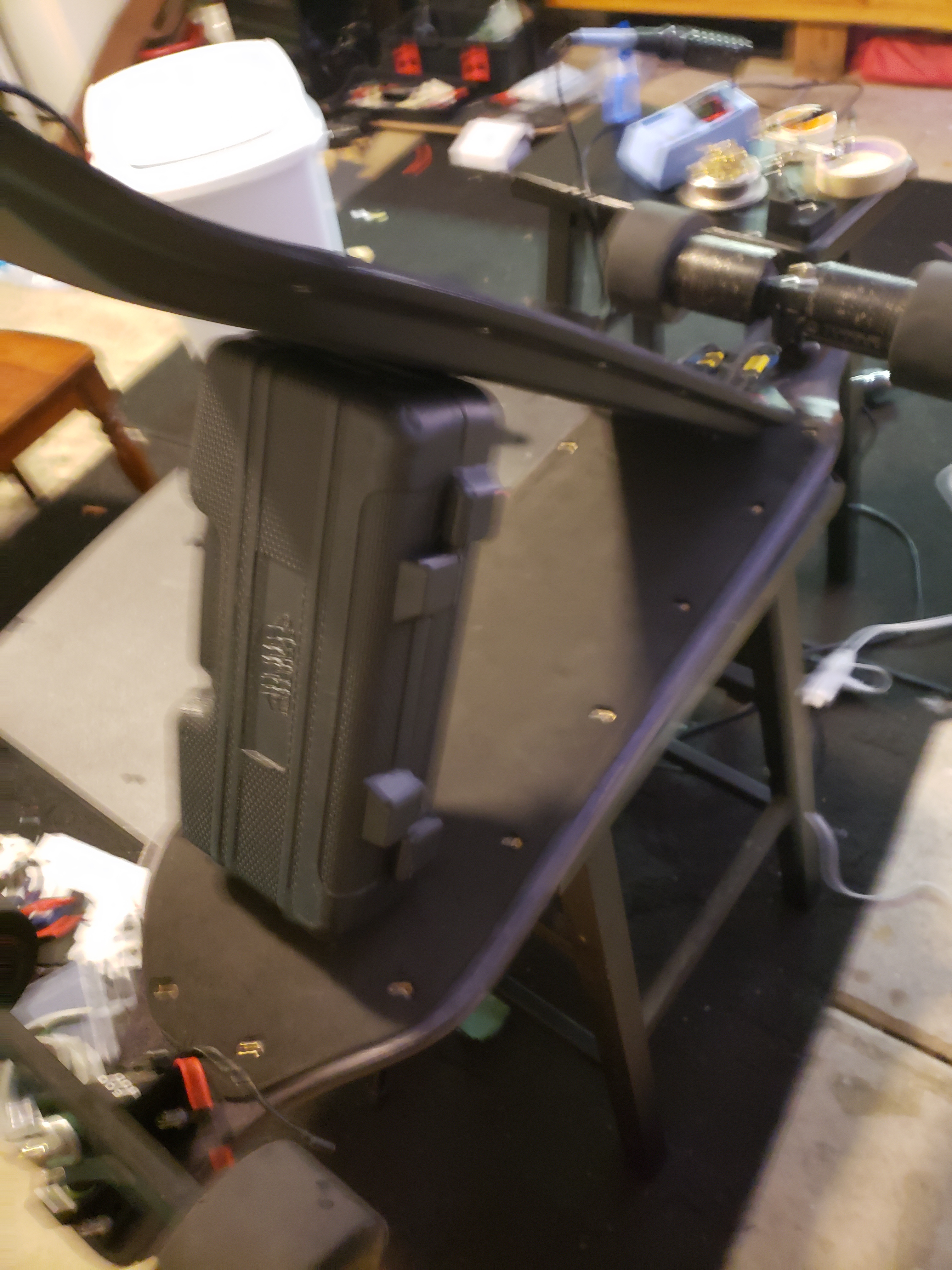

Ever find yourself mid build questioning yourself whether this is the right thing to do or if it’s even going to work?
Story of my life bro. Just keep swimming.images%20(42)
