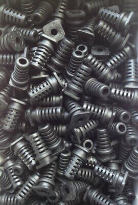

What are those water proof cable plugs called? And where to buy them?
@Winfly rubber wire sleeve grommet? Or something like that
