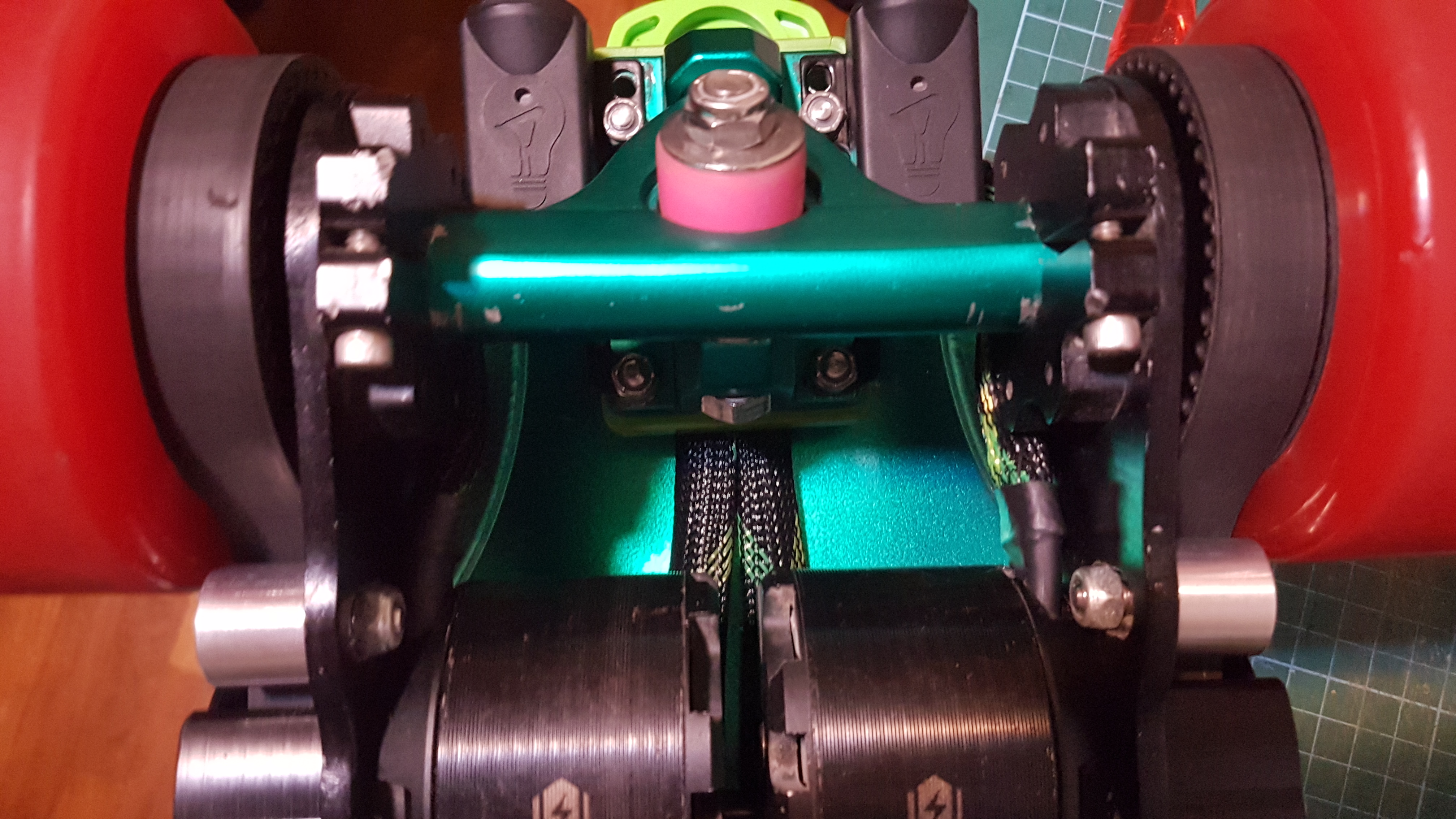

The tunnel riser i used is a 3d printed one, the riptide one will work great too. The braiding sleeve i used is around 10mm across if its flat. I believe these are the infamous diyeboards motors so the phase wires are really thin, like 16 AWG or so, hence it can fit my sleeving.
These are torqueboards motors which are 12 AWG with a sensor wire, fits just nicely on the riptide tunnel riser.
nice, yeah looks like I just need tighter braid - can you link me to what you use? I have maytechs and tunnel riser, seems maytech also uses 12AWG.
Here ya go, there’s a lot of options for green, red, and black ones. Choose the 12mm size. That’ll fit the 12 AWG wires with sensor just fine. Since they’re relatively cheap, you can get the 10 and 15mm one as well, which is nice to have around.
I like to use the really small ones to protect the smaller wires in the enclosure like the PPM cable and power switch wires.

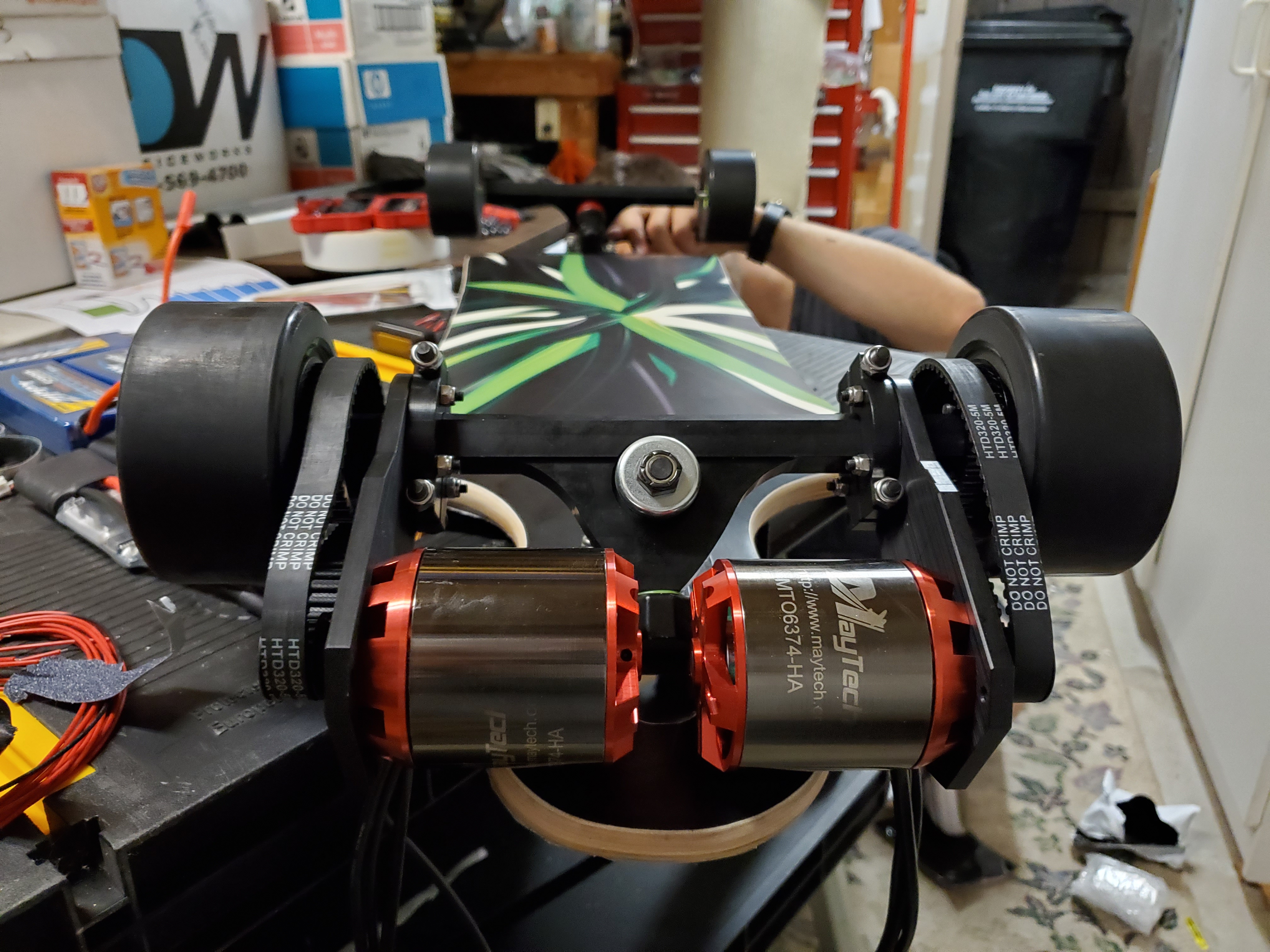

That right side belt looks a bit loose. Rides ok?

how does it ride?
I only put trucks on to test the flex. Way more flexy, wider drop for better pockets, wider deck for more comfort. This is going to be a great deck for wide trucks and Nummies.

Not completed yet, this is the board that I made the boardnamics mounts issue thread about
Awaiting shorter belts, and I agree haha there is no way it would ride like this
