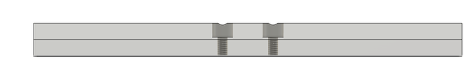

Welding aluminum is really hard.
And if you were it is the 2 holes drilled in the center causing the issue.
there the cross section is even less.
Yes, I would fuse the charge port on the skate.

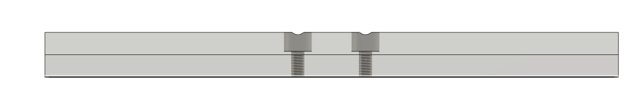

He has new trucks. They ressemble SR TKP but have a counterbore for 2 bolts probably around 5-7mm deep and around 10mm diameter
I guess it looks a little like this
Where SR’s look a little like this
Ill leave it to an engineer to explain all of this :v:
SR Hanger width 177mm
PT Hanger width 240-260mm
SR axles 10mm shoulder bolts - up to 110mm
PT axles standard 8mm

Was it his trucks that snapped or SR?
PT hangers snapped
Don’t forget the #1 cause of hanger breakage: cyclic fatigue
Basically you ride it a lot, it gets weaker
Needs to be over-engineered in the first place :wink:
