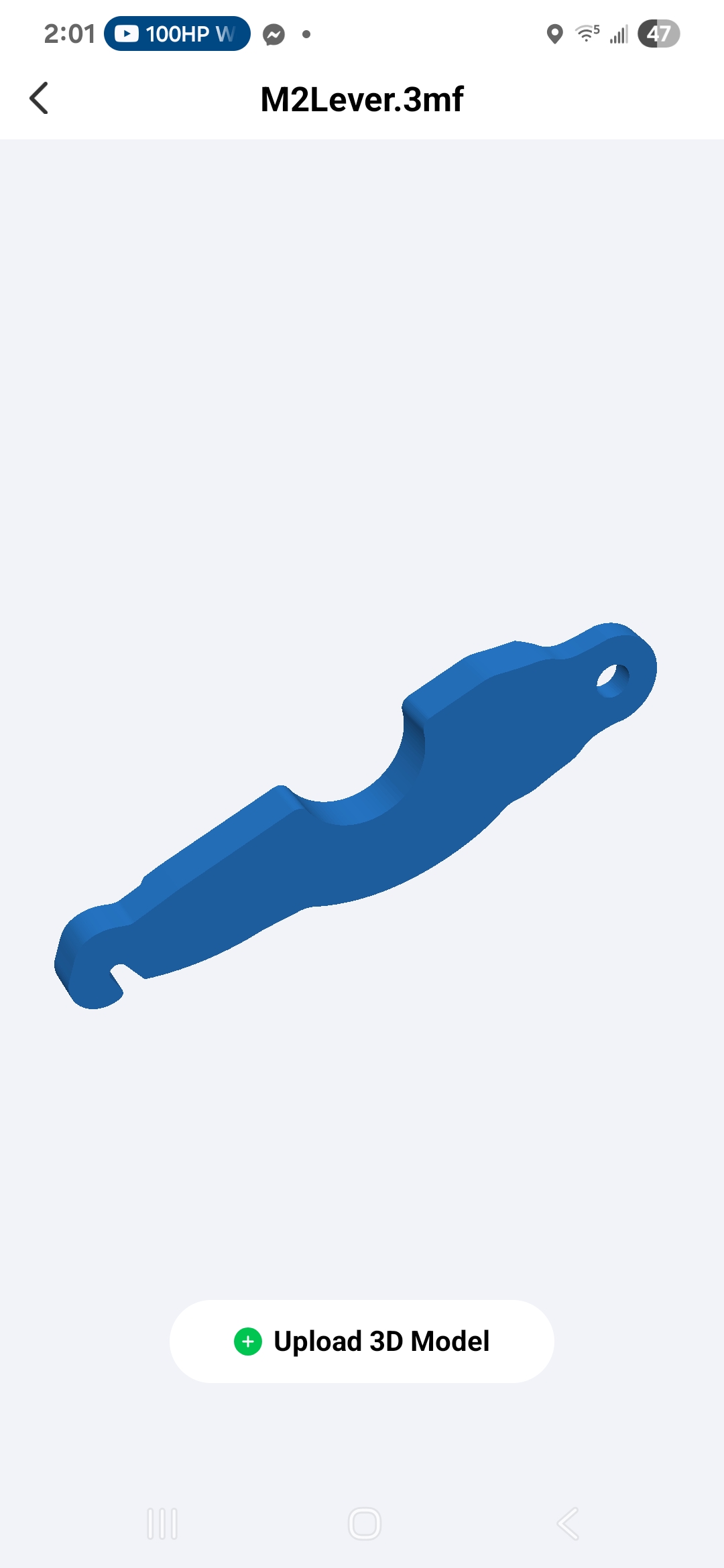

@rafaelinmissouri did your throttle position in vesc genuinely not match the throttle application or was it just a feeling you get when you lose the automatic return to center?
I was asking a question, or really making an observation based on what was written. I thought my interpretation of his words was reasonable.
Mine was just a physical problem with the Arm that brings it to center.
The trigger itself was true to the Vesc app.
Does that make sense?
The trigger worked.
It was doing weird stuff because the spring was loose…
Once I printed a new arm and shortened the spring the remote is working again.
I even rode it already.
Does the new arm also have a thin spot there?
I was letting you know that your observation was wrong. The puck 1 doesn’t seem to have issues with the return to center mechanism failing but does have issues with the physical throttle being at 0% while the vesc side reads 85% throttle. Like this:
(Potentiometer issues)
(This happened on my OG puck mid-ride after hopping off a curb with the puck in hand, it continued to apply choppy throttle until the remote was turned off)
The older z motes have an issue with the return to center mechanism but no issues with misunderstanding the physical throttle position like the OG puck.
Still having a precise control of throttle and brakes while losing the mechanical return to center has to be a safer failure mode than having a 75% margin of error for throttle position right?
