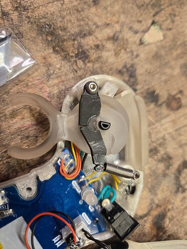

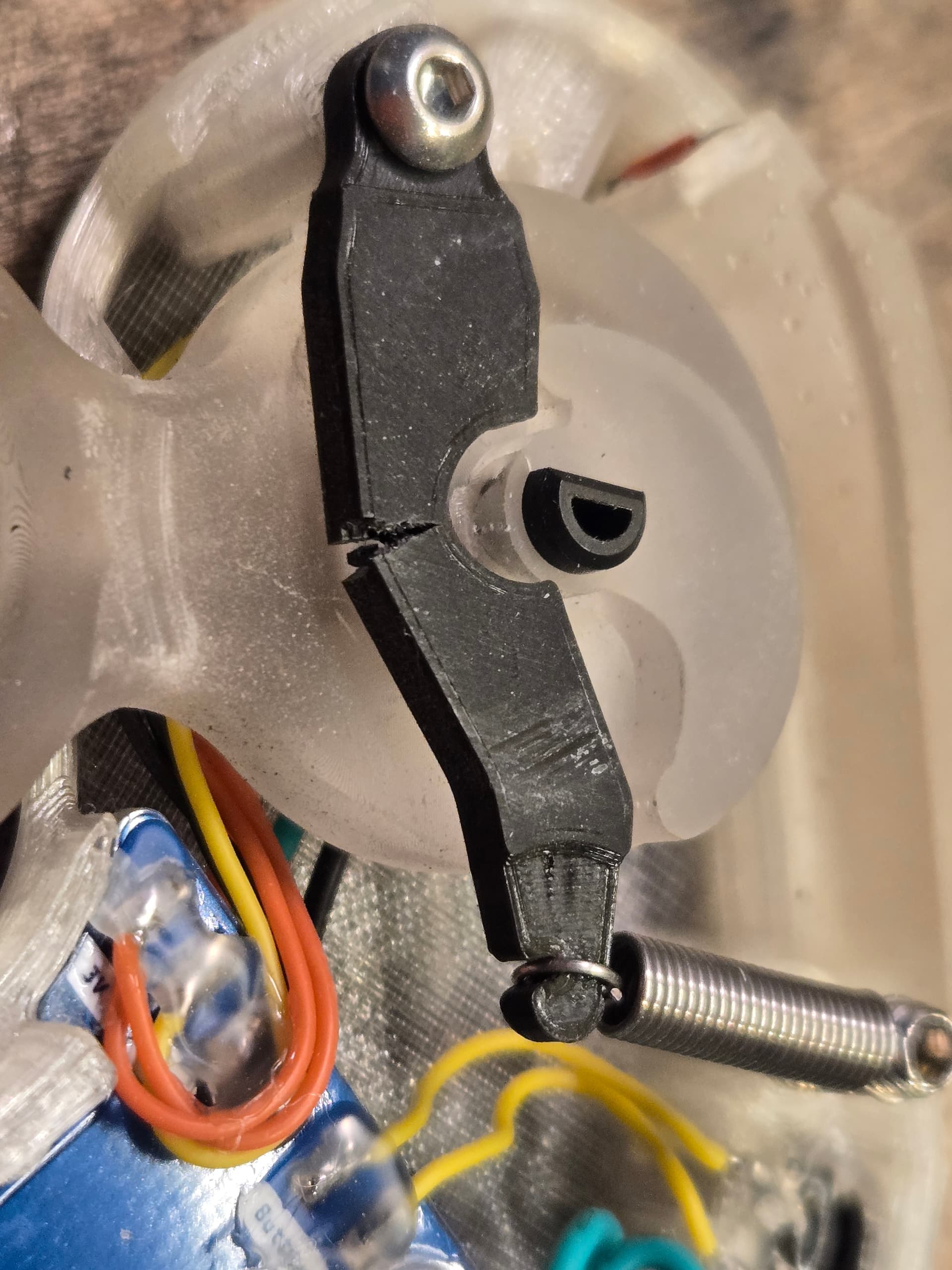

What’s the deal? Did the arm break or the pot? Glad you got a ride though. @Egtscs had the lever arm in his break but it was usable to get to a repair spot then we printed up some spares incase it happens again. Hmu if you need files or something
@rafaelinmissouri Make sure you show that to Kamen
I emailed him to get the file for the part.
Yes please
The arm.
DM’d
(Get ninja’d @Pecos)

To be fair… I have the split trigger and it doesn’t look like this on the inside
For what it’s worth, this lever design was changed almost 2 years ago and changed again more recently, additionally this isn’t a failure mode I would consider dangerous. When the lever breaks your trigger is still attached to the hall sensor and will continue to function for throttle and brakes without the return to center.
