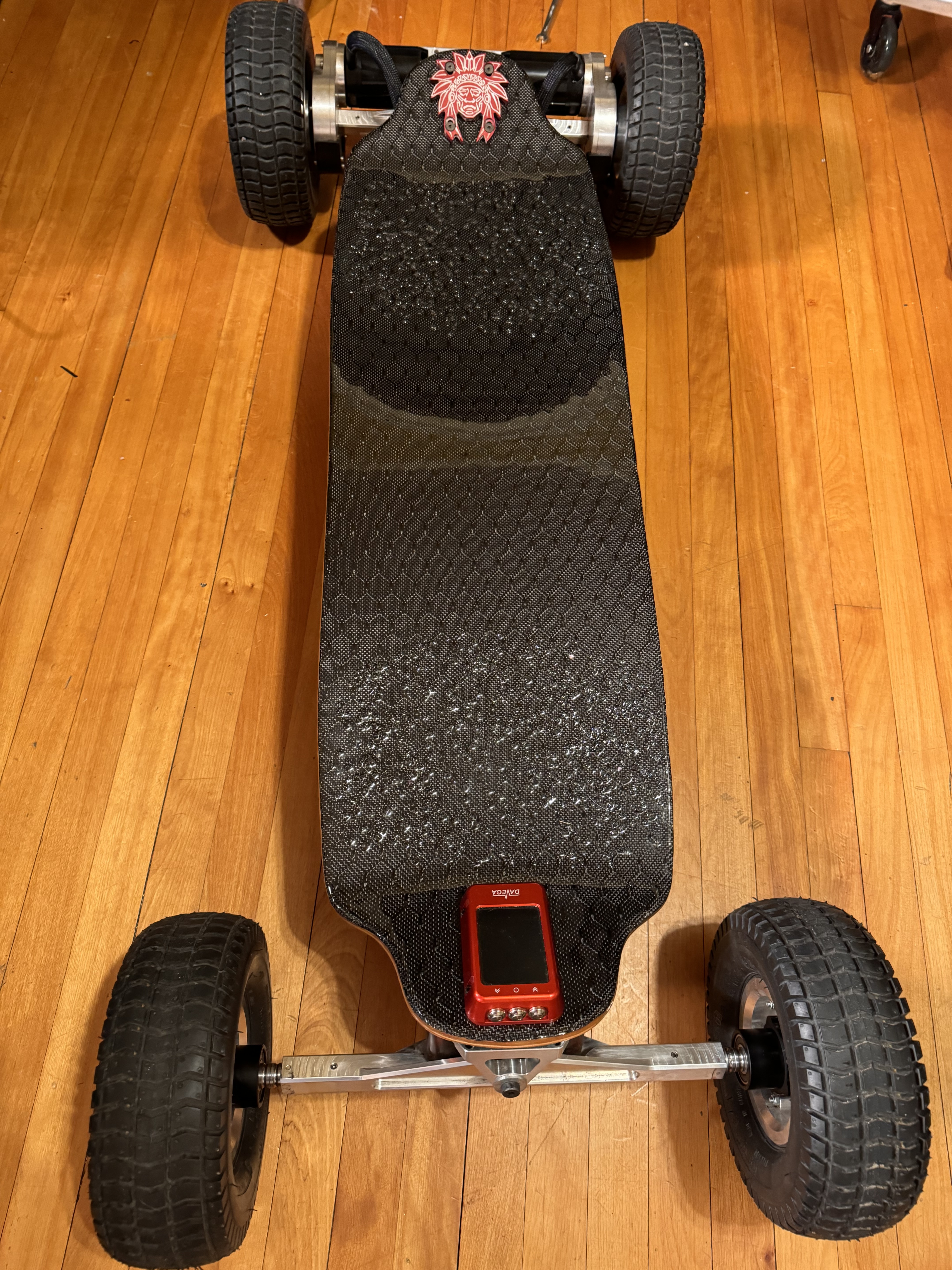

Seriously tho, it’s soooo heavy. It’s a basalt/CF deck. Those materials are light, but the bucket of epoxy used to do the lay-up weighs quite a bit.

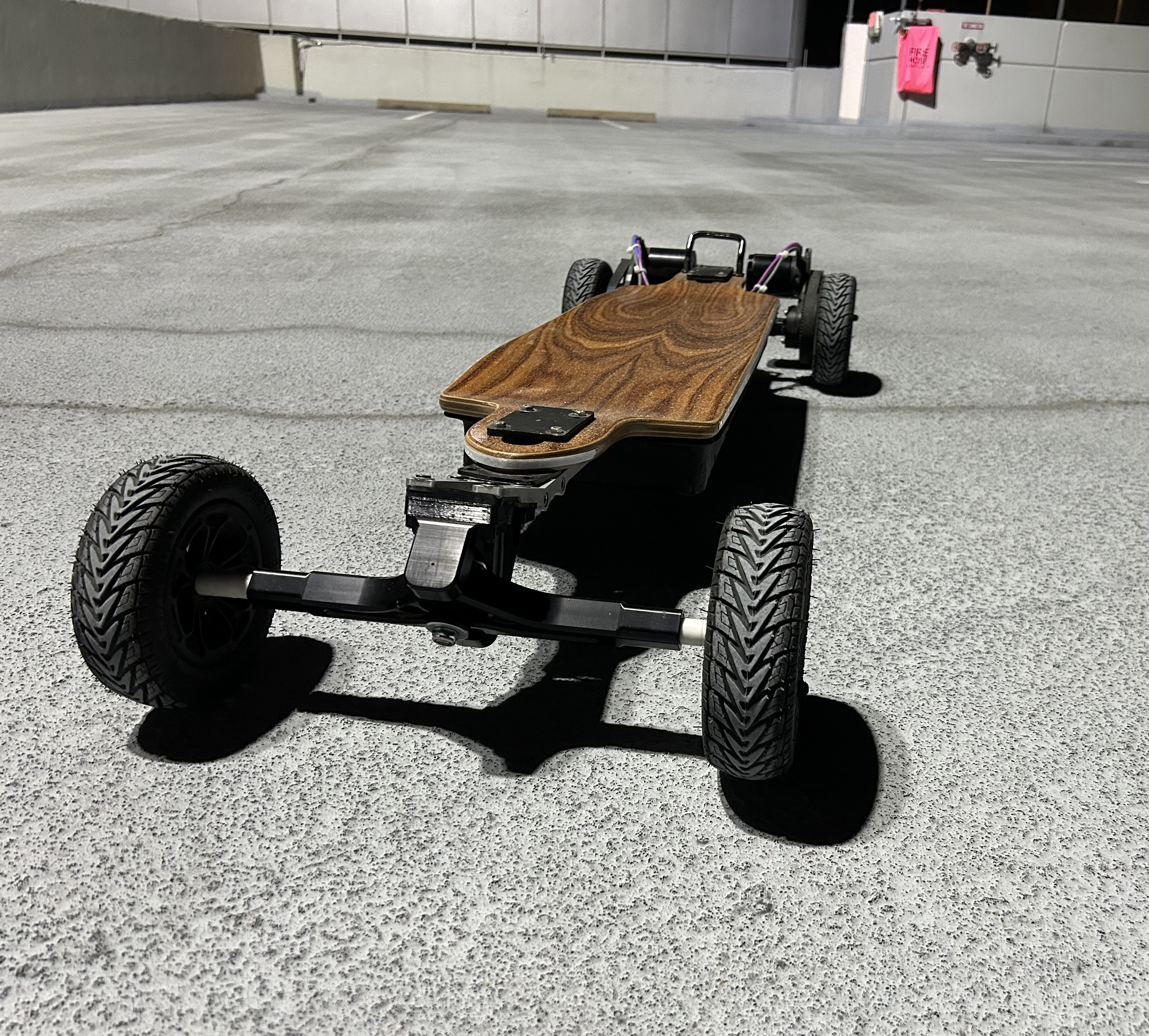

My left front toe kept contacting the right front tire on righthand turns. So I reversed the front hanger and bottom mounted that truck. Which lowered the deck and extended the wheel base. (These Duality trucks are so flippin configurable!)
I haven’t completed the rear install yet. Tito motor mounts are in route. I’ve been riding with the DKP back there. And this baby just whips & rips!
I know that once the 15° Duality is installed it will be more stable and if I need more turn back there I can just cut the supplied wedge mount and slide it under the rear drop through base plate.
BTW - does you front truck utilize the turn limiter?

Yes, but I never hit it (my enclosure scrapes before I do)
What’s size are those 9” or 200x75?
And what rims that’s setup looks good
Thanks, they are 9x3.50-4 Turf Tire (CST). Basically a 225x75. Trucks, drives and rims are AT Finality from 3dservisas.
I like the size. I might have to pick up a set.

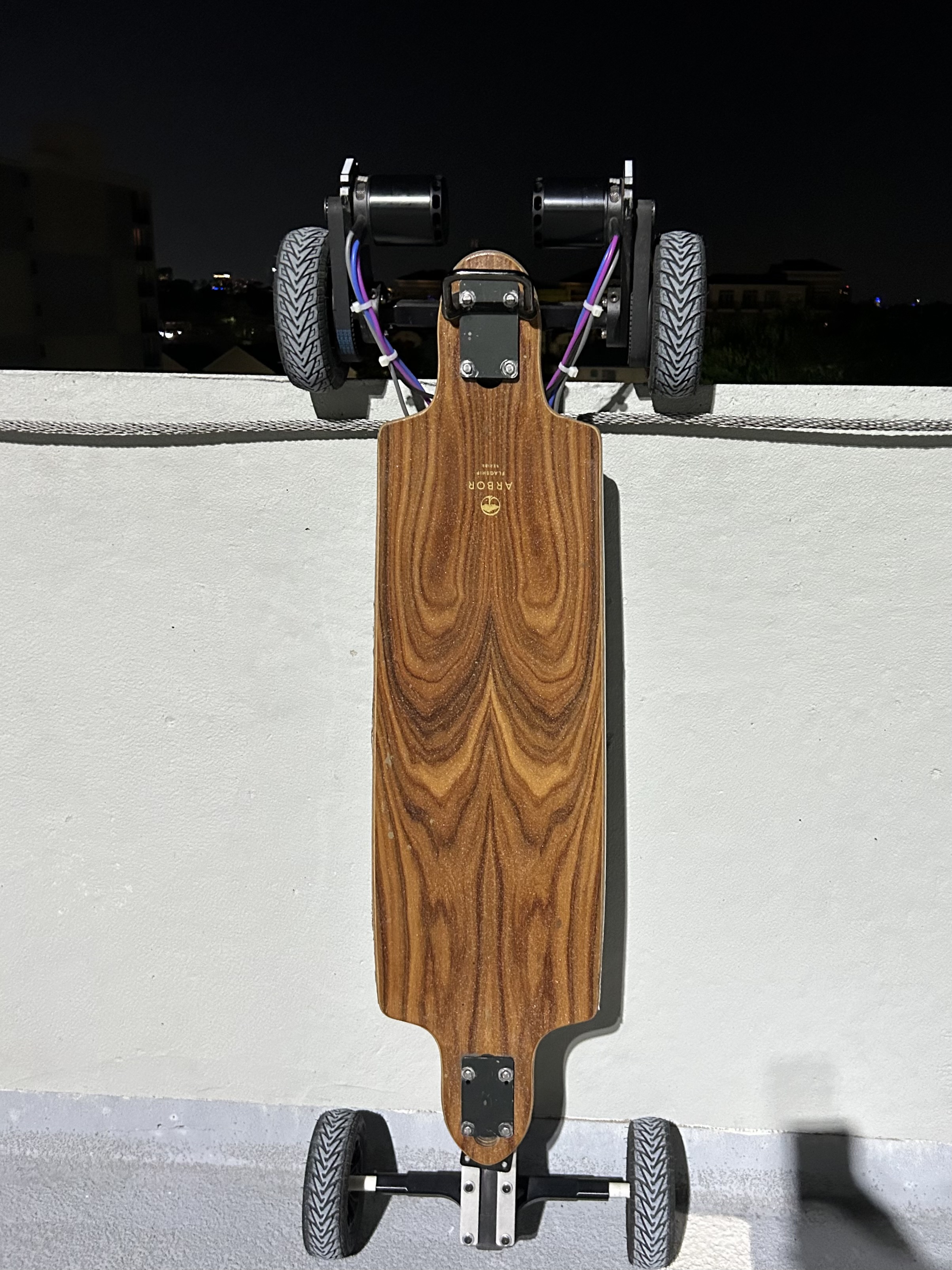

Thats a hell of an extension… did you reinforce the deck?
Yeah no I haven’t and its starting to become a problem as theres a permanent bend now lol.
Any suggestions? I just need some extension to avoid wheelbite.
A runner board along the bottom of the deck will reinforce it. You wouldn’t need more than a few mm thick at like 10cm wide

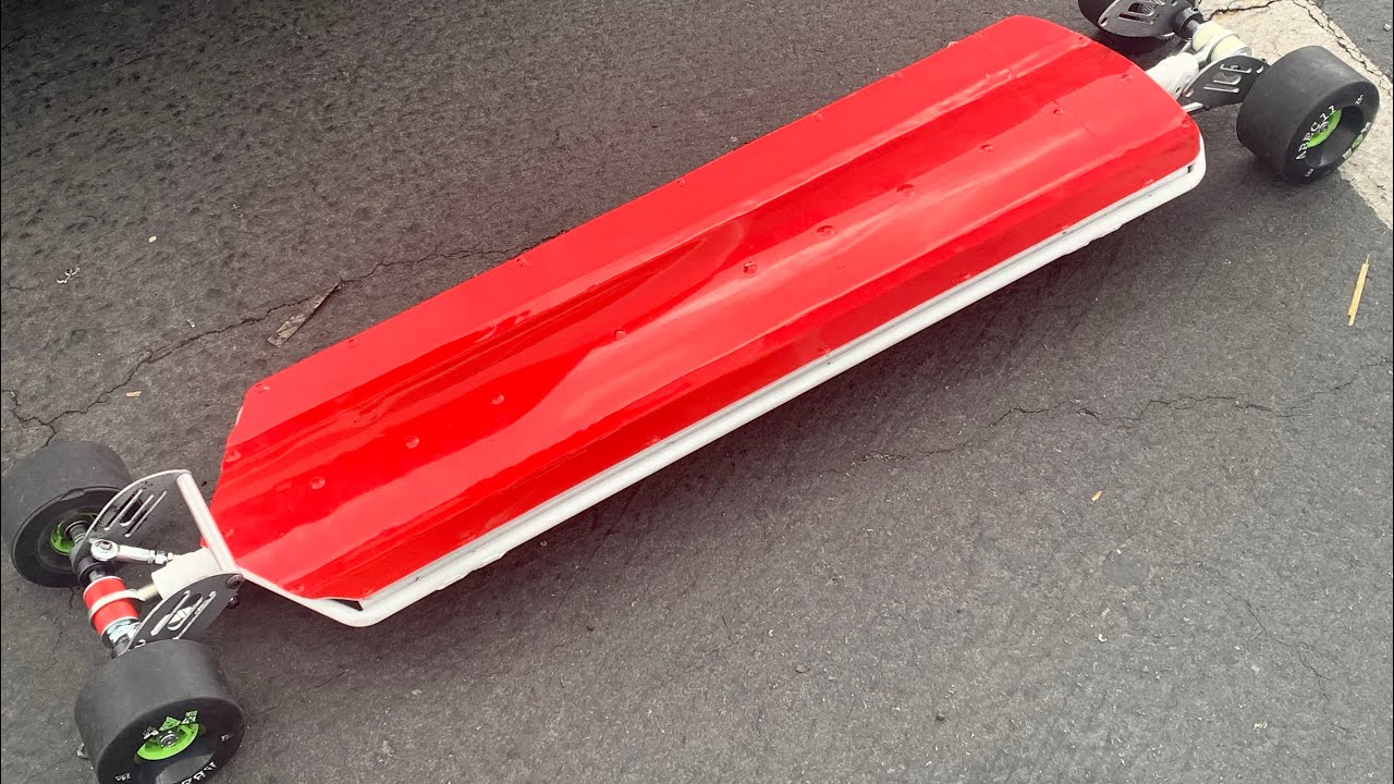

At one time this was SRB race board number 11. I modified it into this two years ago. The “single motor with extended shaft to make it two wheel drive was my idea” I was the first to do it even though I was told it could not be done. I did a lot of mods to this board. Right now it’s all wheel drive, I shortened the axles 4”, added offset heims, raised the underside frame, added W concave to the frame and top pan. Made a larger belly pan. and pissed some people off. ![]()
Just some inrunners. Nothing fancy. If I remember correctly, the black ones were made by a company called Rocket and are 540kv, The green ones are made by Castle and are 800kv.
Getting mad at someone for modding their own property is childish
