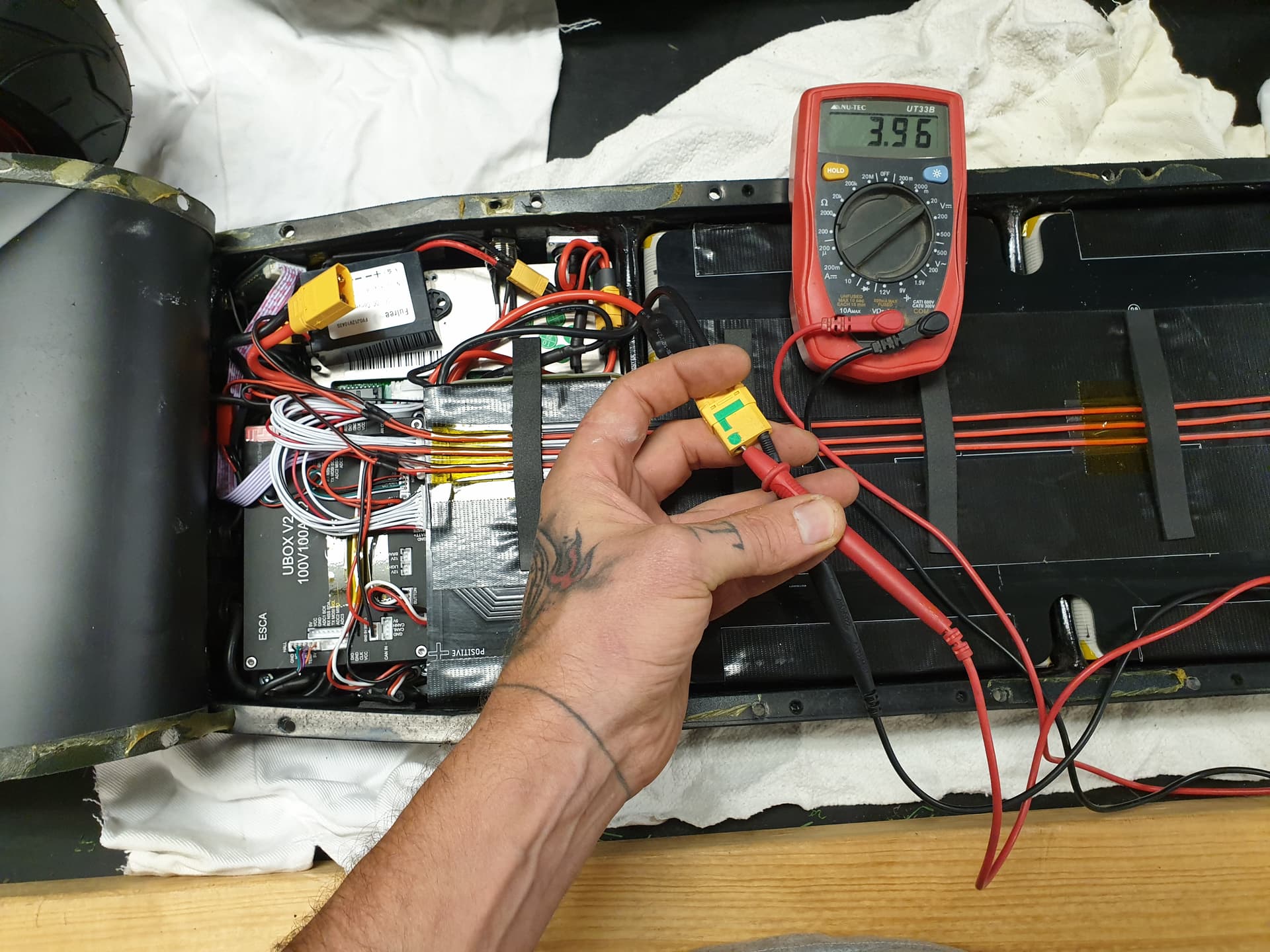

A local guy purchased a board from @Kaly that cost over 11,000 AUD to get here.
It didn’t work. Ernesto told him to charge it. The guy tried to charge it and the charger literally exploded because it was a 110V charger rather than a 240V charger.
The board sat for over a month before this guy found me thanks to @hoytkid
By the time the board got to me, the 20s battery was at 4v.
Obviously, the battery needed to be removed so that I can replace it, but in all his wisdom, Ernesto had decided to stick a completely uninsulated pack directly into a carbon enclosure.
Typically, battery packs get wrapped in heat shrink. This way, if it needs to be removed, you can just cut through the heat shrink and easily extract the battery because only the heat shrink is stuck into the enclosure.
But you don’t get heat shrink on the $11,000 XLR. I needed to use the angle grinder to chop all of the nickel connections to the pcb so that I could remove all of the groups one by one.
So if I had any comments regarding my work, I could sum it up into
This should never have happened. The construction and installation of this battery could be considered as gross negligence. The builder most definitely knows better and considering the price paid, should have delivered better.

Poor guy your friend. I think for that much AUD, he deserves just be happy and satisfied with the product. So in these days its better to have a meepo instead a kaly :wink:
But I guess he is happy to have you on his side as technician for this thing…
I just cant believe that battery design of kaly. how should anyone maintain this battery?
Looks like its made with the iphone philosophy.
