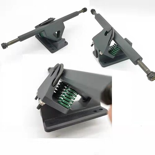

Do you have a link for these?
See @Boardnamics , I told you you could create a channel truck that used standard skateboard pivot cups! :crazy_face:

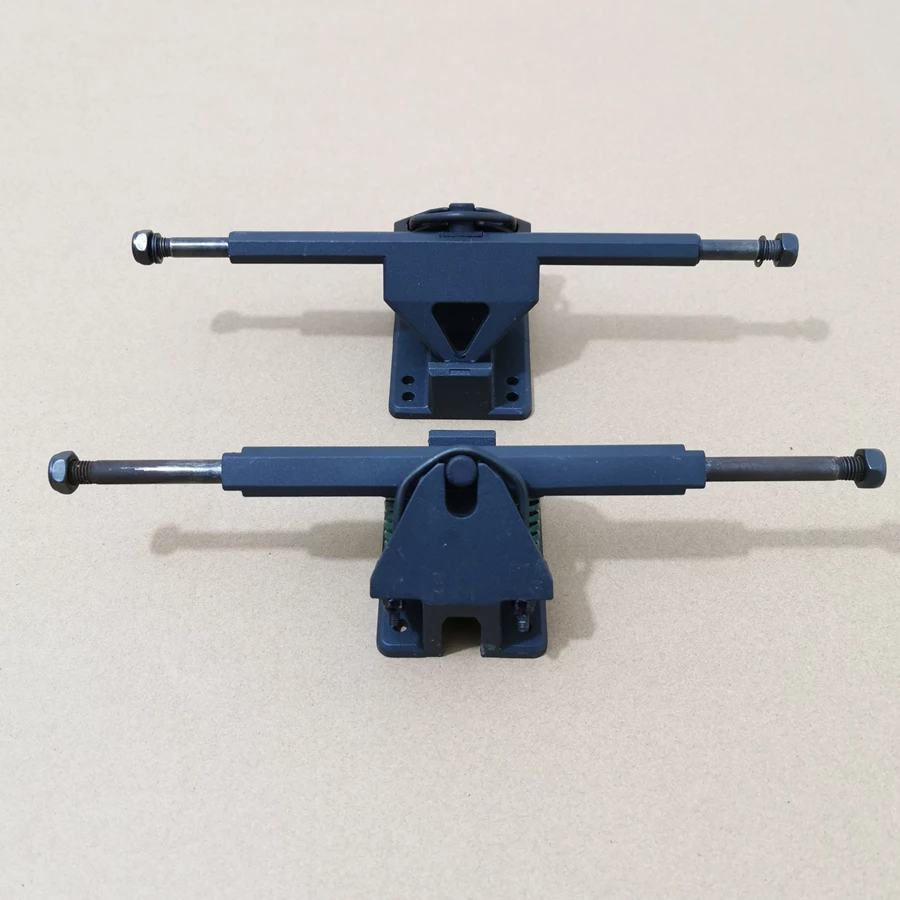

But oh my god why did they just leave the other end metal on metal like that
US $45.69 | 25cm/26cm electric aluminum alloy dual springs cushion skateboard trucks light flexible stable
Interesting how one truck has 35mm axles and the other one has 54mm axles. Smells like it was designed for DIY esk8 building. Or maybe hub motors
The board is not CF
Man when I saw a picture of these I was like SWEET, can put a couple of these under the sur ron and make the middle glow and shit. Then saw the damn price :rofl:
I can buy enough LED strips with $50 to make my bike look like Times Square during Christmas and have it be connected to bikes batt.
The square shape at the end of the hanger is most likely design for the typical chinese hub motor. :man_shrugging:t2:
