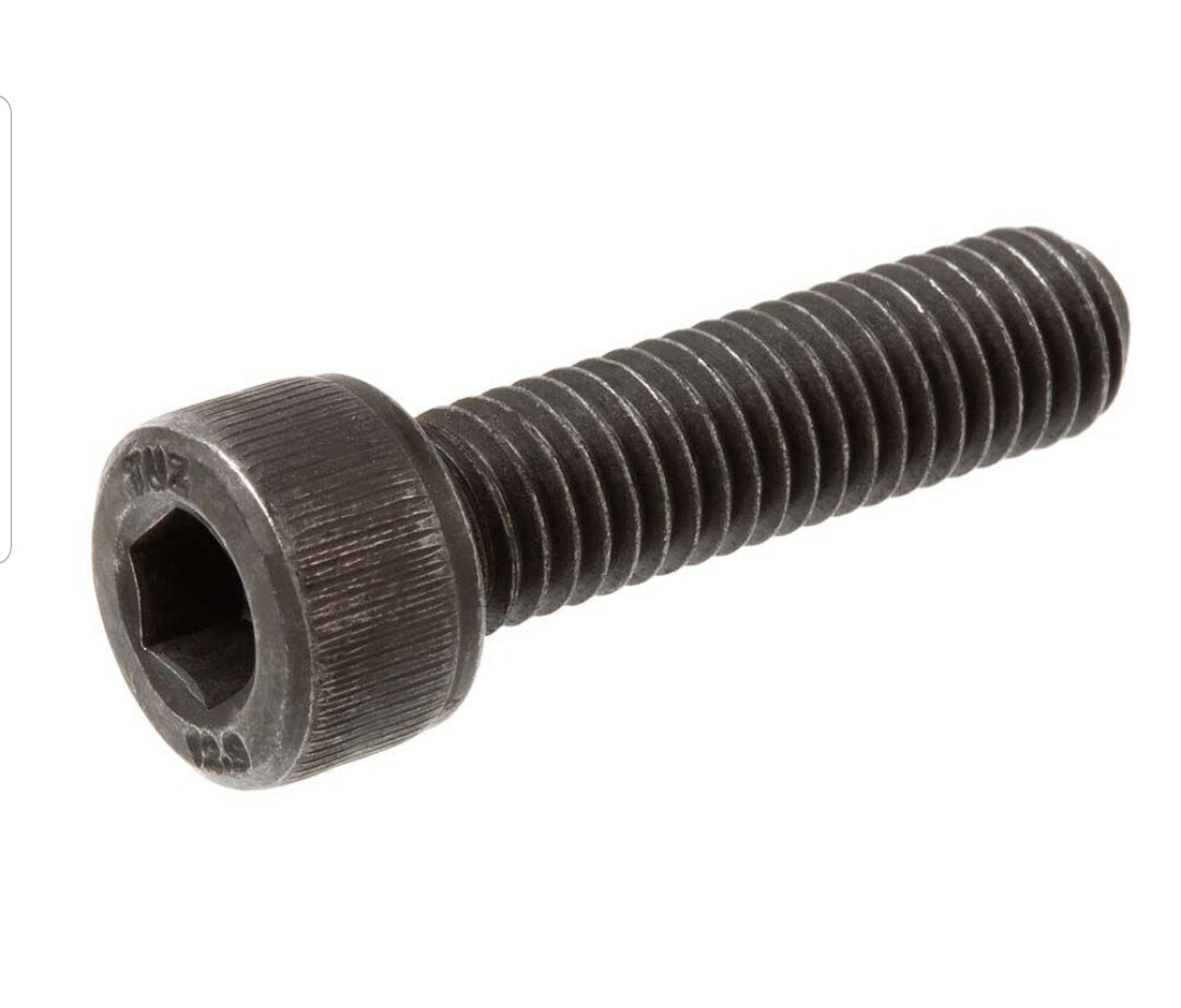

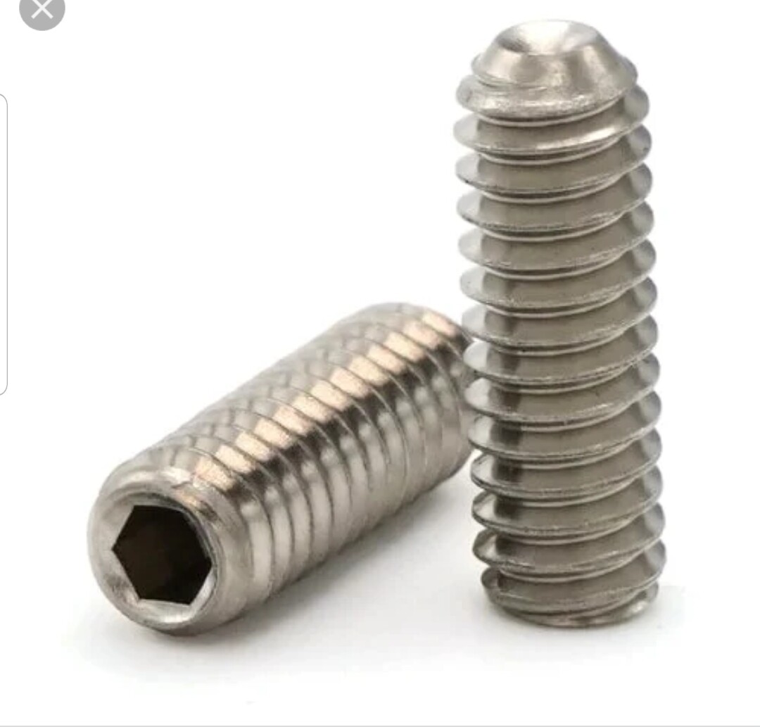

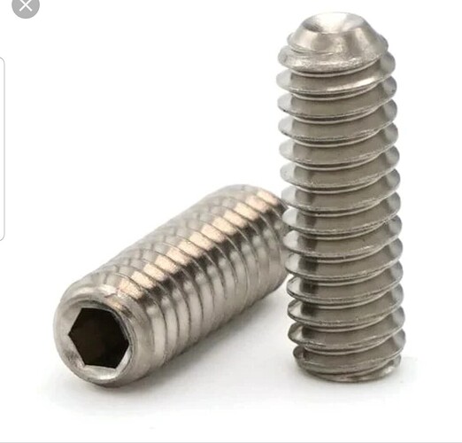

To be pedantic (and educational) those are not set screws. Those are regular ol socket head screws.
Socket head screw
Set screw

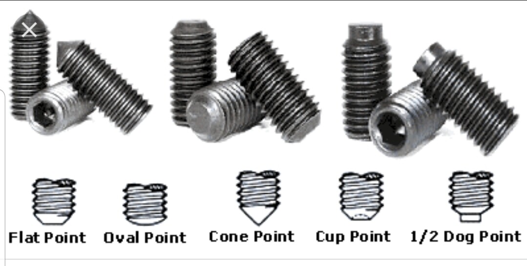

Many set screw types
Socket head screws can be used in a pinch, but they are not designed to do the job of a set screw and are inferior at doing it.

Ohh, I knew they were socket screws but I thought them being on the pulley the way they are made them also referred to as set screws lol I just meant socket screws then
