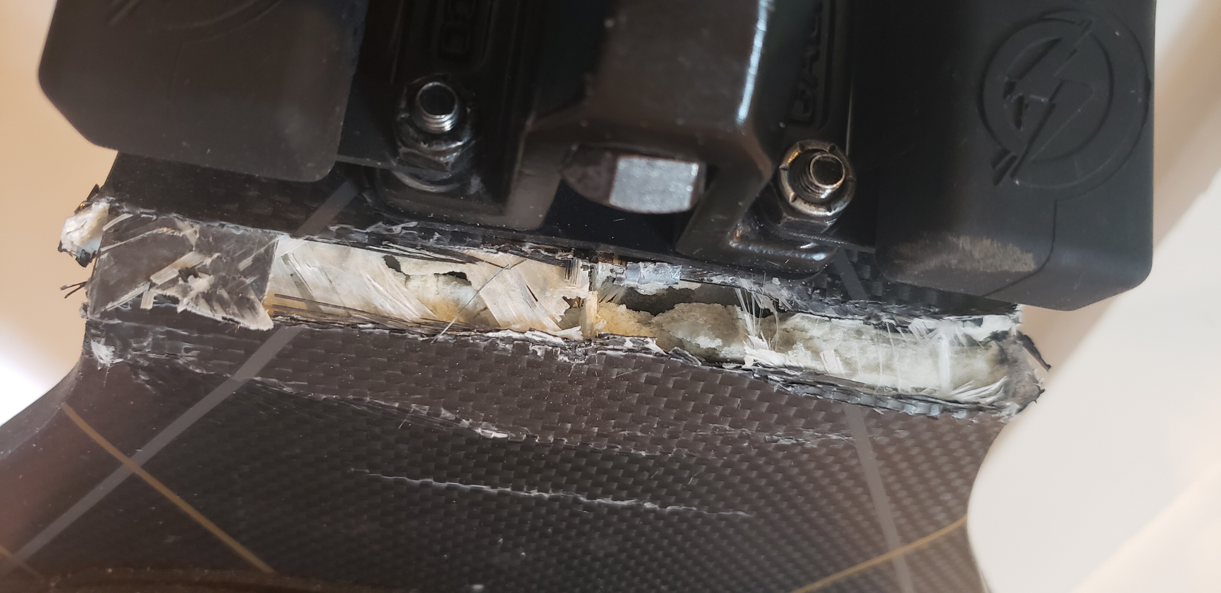

Hardly even need to crack open. They don’t even fully layer CF on the top side.

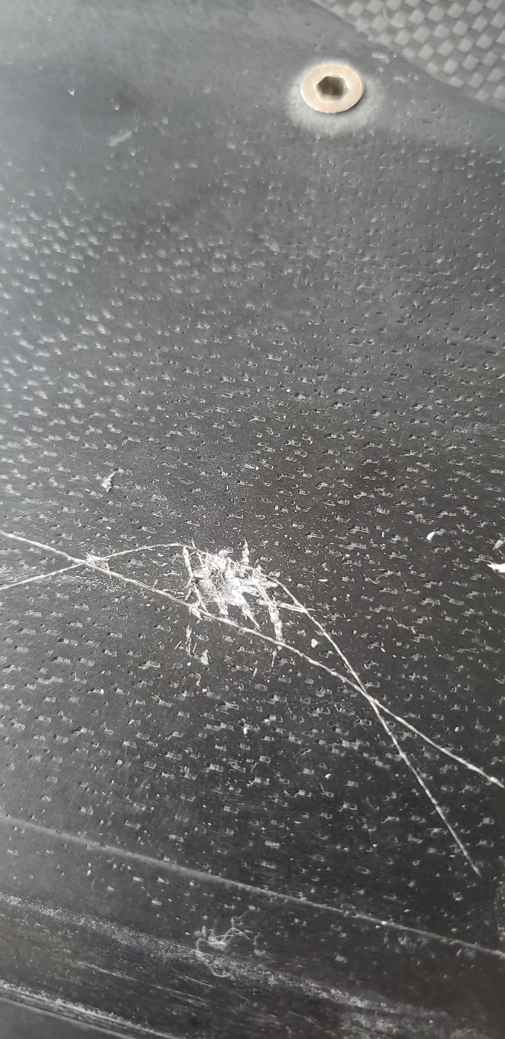

if u can, try to scratch the ā€œnon CFā€ part and see what’s under the black paint?
I’m guessing it’s GF
Definitely some BS right here.
Definitely disappointing. I really love this deck and it is decently strong. I’m close to 250 lbs when I’m geared up and it has performed well. I can’t put weight on my heel today, so it was serious forces going through that board, but they shouldn’t market it as pure carbon fiber.

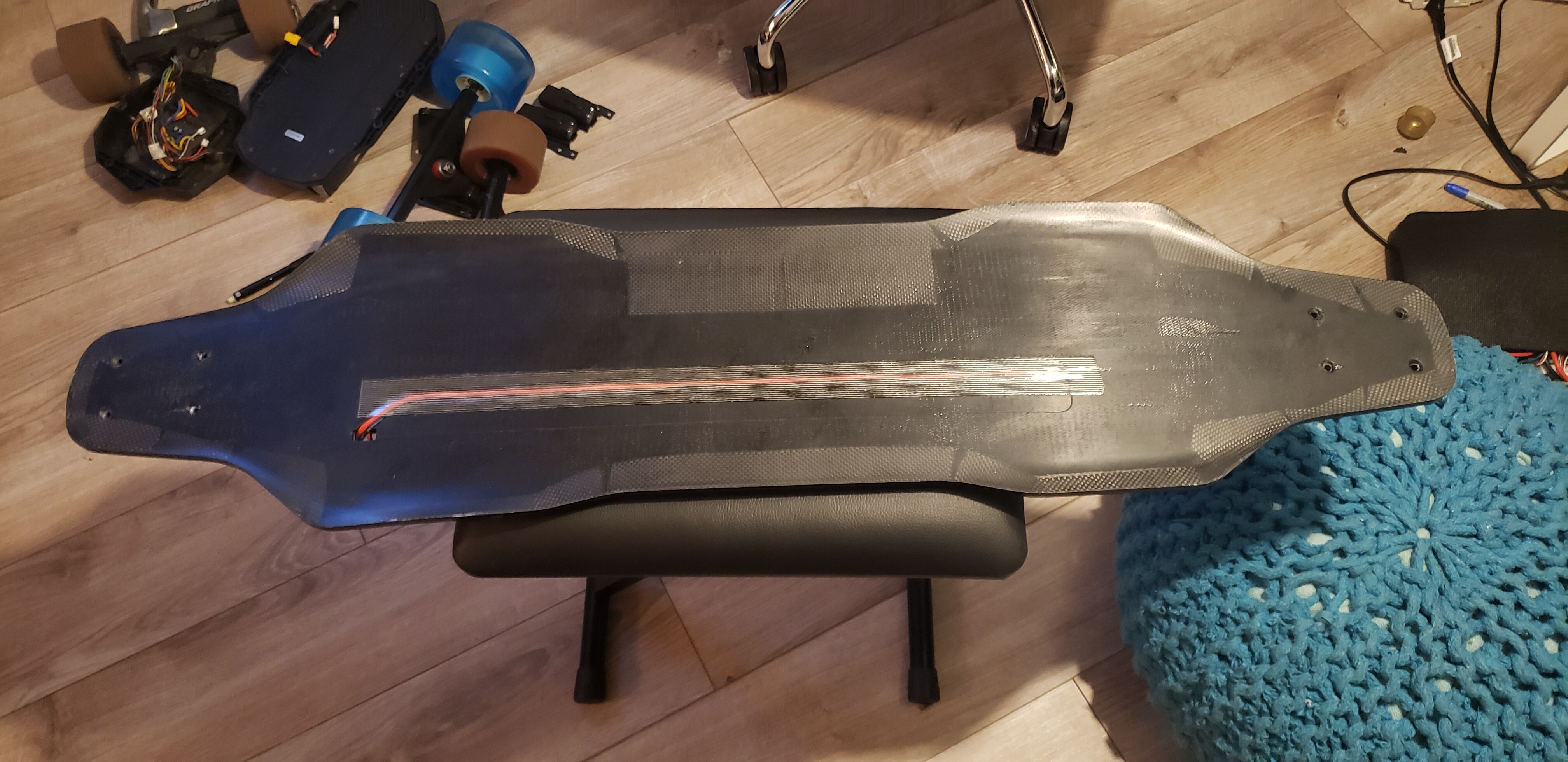

Might take me a bit to reveal whats under the black paint @frame. That pick with the grip removed was from when I was building. Taking this thing apart today to measure for new deck and enclosure options.
Acetone easily took off the purple paint on the zealot deck, I assume the black is just paint.
Hope your heel heals up well! That shit sucks
It is some kind of fiber. I’ve put acetone on the deck before and the epoxy protects it, so I don’t think it would reveal anything.
What wheels are those?
They look like momentum boards new adjustable rubber wheels
My money is on Boosted Boards 105’s. EX
Dude that thing looks so sick!
Yup, that’s them.
I really want to know how they feel.
Good, quite soft. But they don’t feel like $150-250 to me… lol
That’s just crazy for solid rubber with holes :exploding_head:
@Lee_Wright just post the damn things for sale! You’re killing me slowly here man.
:star_struck: what is that deck?
redember 44 :slight_smile: still too small :smiley:
Your a fucking beast can’t wait to see it done
Those are not HD60 are they?
I think Jerry (backfire owner?) is probably a marketing genius (scam artist). The carbon fiber that’s used is pure. They did not advertise it as full carbon fiber deck. I really like that deck and the flex but will never trust it after seeing the few that snapped it.
I knew something wasn’t right when I felt that flex
