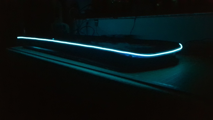

El wire isn’t very bright in daylight like LED strips are.
If daytime use is on the agenda, I’d skip the el wire.
I have some I’ve experimented with a lot but it’s never made it into a finished product because it’s too dim.

I’ve been trying to decide whether I want daytime ā€œrunning lightsā€ around the edge of the board or just a subtle night-only effect.
I went with addressable leds for my underglow
Here’s what it looked like while I was installing it

You can get RGBW and pixel tape in neon flex as well if you want the best of both worlds but it costs more

I’ve got an enclosure project on the go that uses a flexible optic strip, lit by 2x leds at each end. It looks pretty good on the bench but I’ve not fitted it properly yet. Lights and colours controllable via an app on phone.
I tried an EL light strip which is looks good too, but doesn’t feel very durable.
