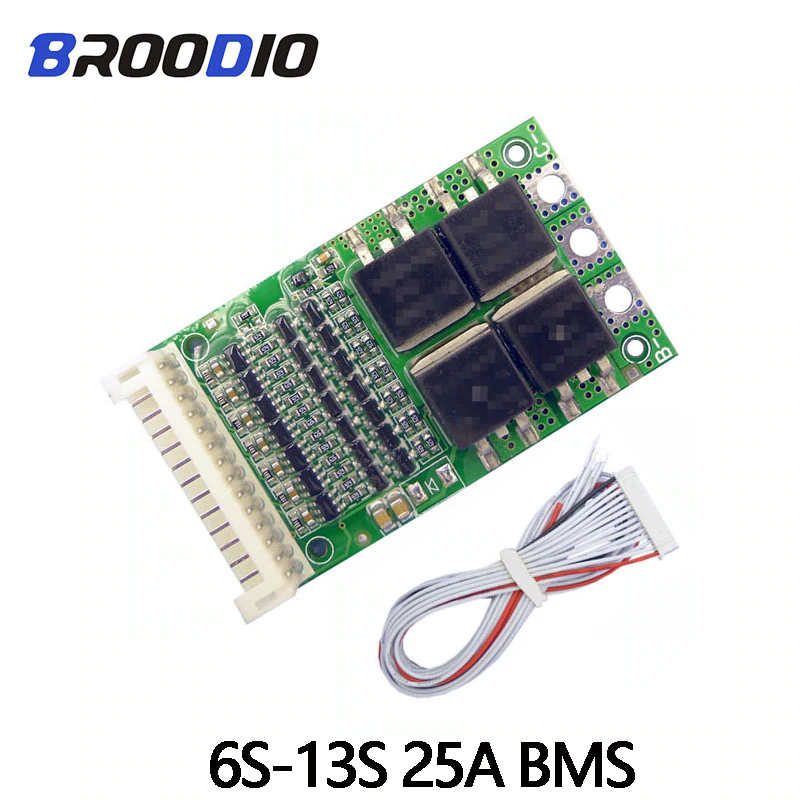

I count 14 wires, so 13S?? I could use some 12S and that size.
Kind of looks like a Daly without the case? Daly 10s and 13s are roughly that size. The 12s is bigger for some dumb reason.
According to @kevingraehl (and also winfly) 13S daly doesn’t have the balancing circuit. But yeah that one does resemble the daly albeit naked.
It’s a dirty cheap 6-13s BMS without balancing, need to check cell voltages from time to time.
Unfortunately there is no small 12s BMS with balancing available so I try this one for science (no space). According to the diagram B12+ and B13+ of the BMS are connected to B12+ of the battery (for 12s). But if this BMS works or not I don’t know yet :man_shrugging:
I think it’s best to balance charge the battery first before using this BMS.
Yeah I mean imma guess it’s totally useless if it doesn’t balance, but have at it and do report you findings always interested to know
