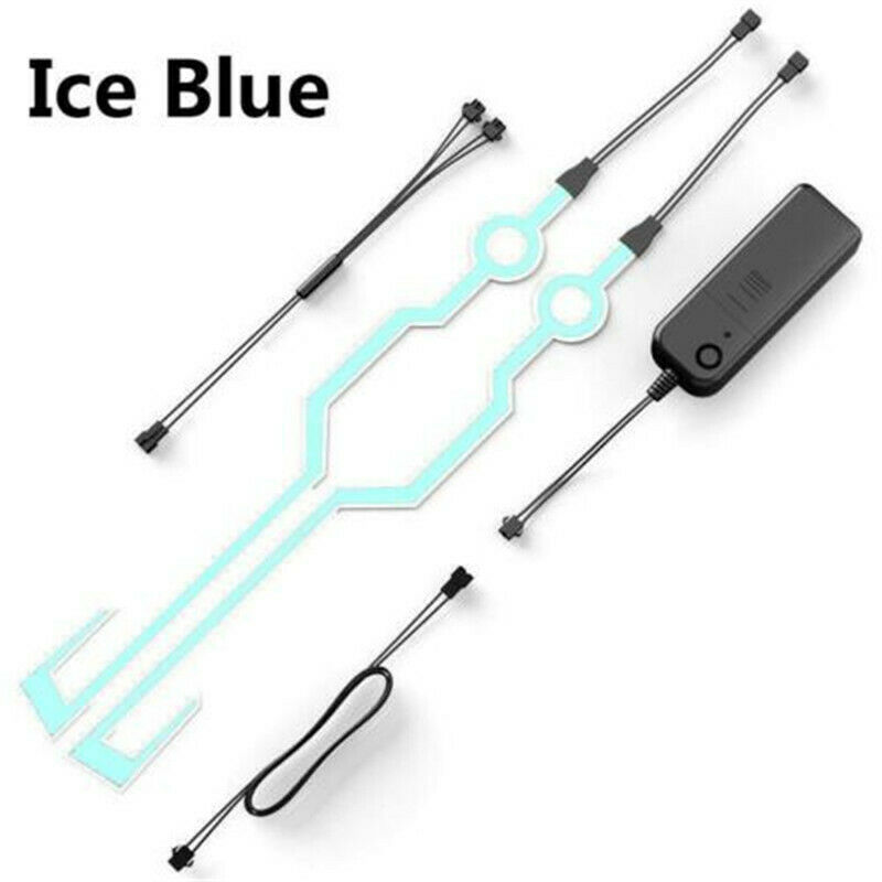

What extra parts? I opened mine today for the wiring. These nothing in there :joy: one small pcb and the battery compartment

El wire and tape are capacitive devices that run on AC voltage and can be driven with 50V RMS to ~ 200V RMS.
The driver converts battery DC Voltage, 1.5, 3, 12, what have you, to typically 100V AC.
The brightness is proportional to the voltage that comes out of the driver, not the battery.
Brightness is also proportional to the frequency of the AC voltage from the driver. 60 - 2000 Hz is the usual range. Most drivers run 2KHz.
You should try and find a new driver that runs high voltage and high frequencies to boost brightness.
Also, connect your tape strips in series. They are capacitors after all and running them in parallel increases impedance. Opposite of resistors

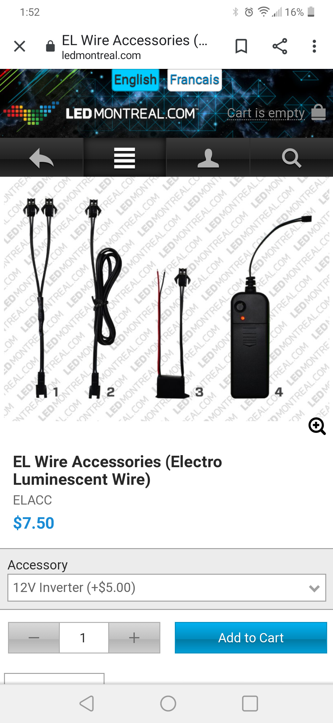

I’m gonna make a run to my local led shop tmrw. Just saw he has a 12v inverter (third item in pic)
That could make it interesting.
it looks like the same part.
hmm. I think ours is already running at 2k hz. because that’s the sound it makes. and I just naively measured AC voltage from it and I’m getting 140v. so… if it’s linear to voltage perhaps another inverter can get to 200v and do 42% brighter?? again guessing.
