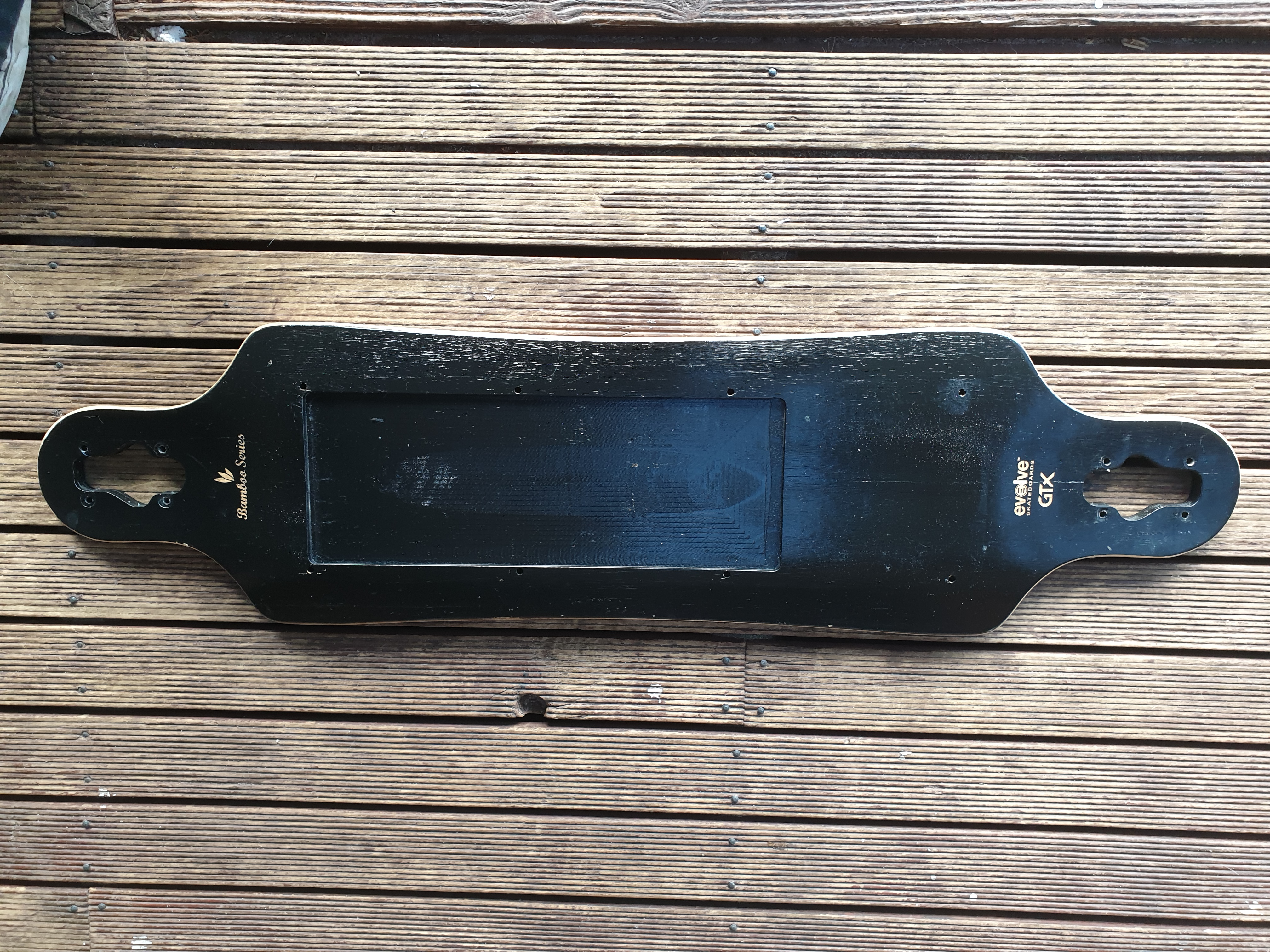

Right, so after an afternoon of sweating and swearing I finally managed to remove all of the goo from the deck. And I was really surprised with what turned out to be the best way.
So firstly, I should have used a heat gun or hair dryer to heat up the grip tape before peeling it off. But I didn’t. The result of that was the tape coming off but leaving ALL of the adhesive on the board.
Firstly I tried acetone and a rag. Didn’t do much for the goo, but took the paint off pretty easily!
Second I tried methylated spirits and a rag. This worked, but took a LOT of elbow grease. A sharp flat blade helped here to remove as much as I could before rubbing the rest off.
Finally, after a quick Google, I tried WD40 and a towel. This worked like a charm. Seriously so much easier than any other method. Still takes a bit of patience and effort but definitely the way forward!

I used goo gone which kinda helped let me scrape the crap off. But still left some residue. I ended up sanding the rest off the deck. It was a pain. Why does the adhesive separate from the grip? Does this happen from cheap grip tape? I bought a roll of some cheap stuff and this was the result. Maybe I’ve just been lucky. I now know to heat it as you remove it.

Had same problem! WD40 + towel gets it off real nicely. Real oily after so I used dish soap to get it off.
Reason why wd40 worked is because it is actually a solvent where most people think it is like grease it actually pushing grease and stuff that is ceased and stuck. Next time do the heat gun as you are peeling. You could probably use a hair dryer and scrape off the goo.

you probably didnt heat the grip tape enough I let go back and forth slowly for several minutes with the heat gun and then use a razor blade to lift the edge and then slowly peel up as you hit the top with the heat gun.
