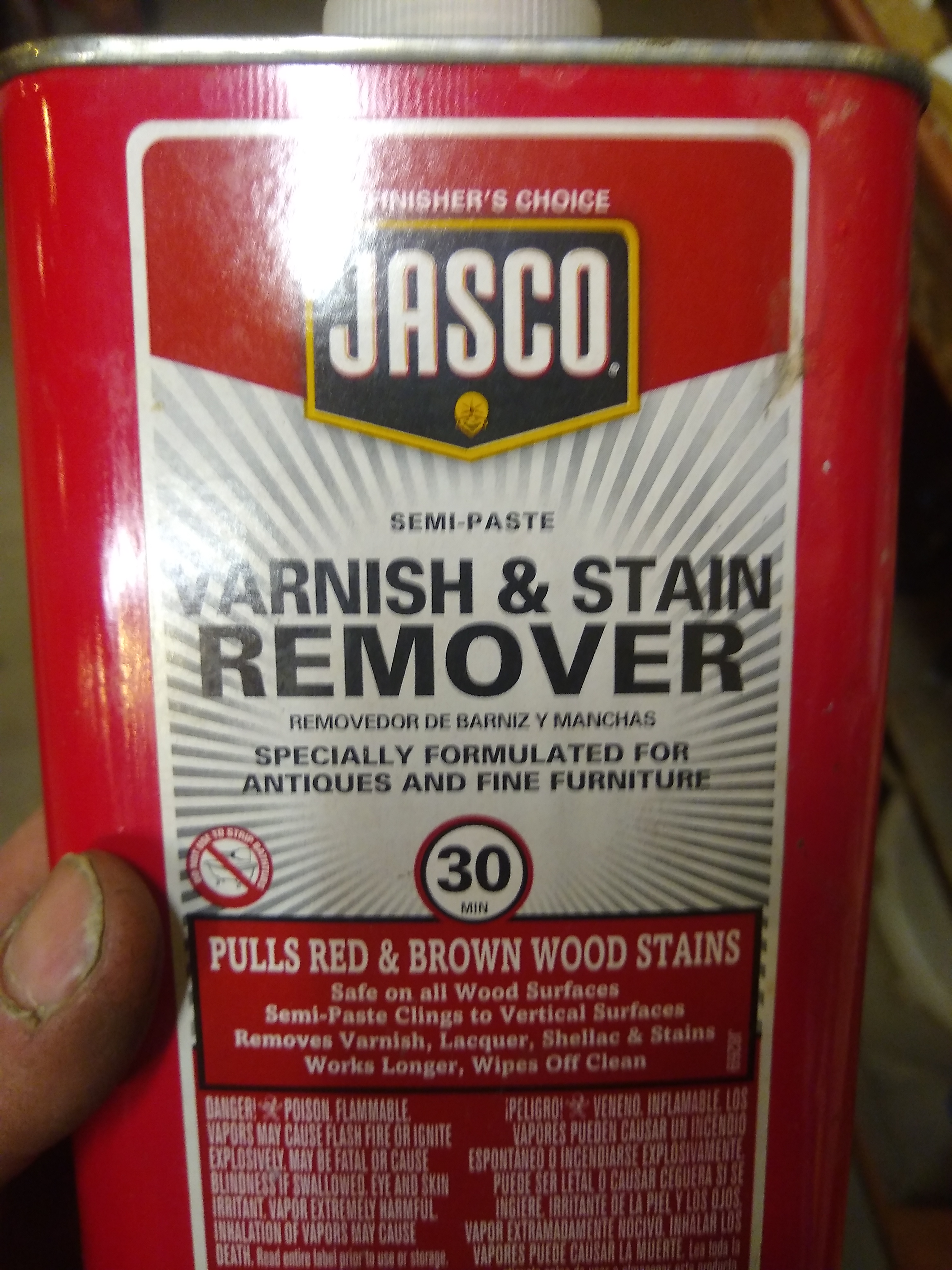

Has anyone tried paint stripper? I dunno if it theoritically(is this even a real word?) work u never know till you try :man_shrugging:

Strippers are real, don’t listen to your mom.

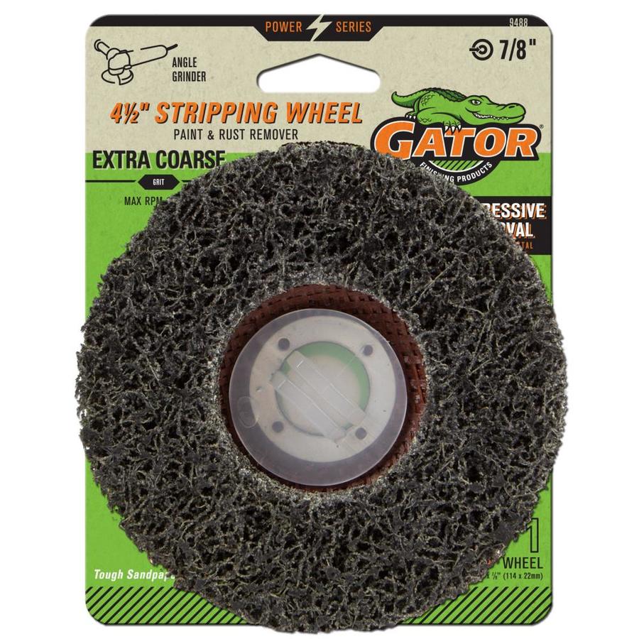

images (3)
I’d try those if I needed to remove some frit
I meant like some Like this and yes strippers are real , how old do you think I am🤔?

Flapdisk +1.
Those things will remove a shit load of material (Mild steel, ar200, ar500, aluminum, titanium, they dont give a fuck). Just be very careful otherwise you’ll chew into your board at the same time.

I use an angle grinder fitted with a flap disk. It looks like a sand paper pin-wheel. It’s pretty aggressive so I only do a rough job with it and then switch over to a regular orbital sander to finish the job. This will strip it all the way down to the bare deck. If you’re trying to preserve the finish at all, I wouldn’t go this route.

Right right. Well homeslice is prepping for regular grip tape. I say dump the chemicals and let science do the the things.
I assume you have to sand smooth and apply a clear coat after using this product
