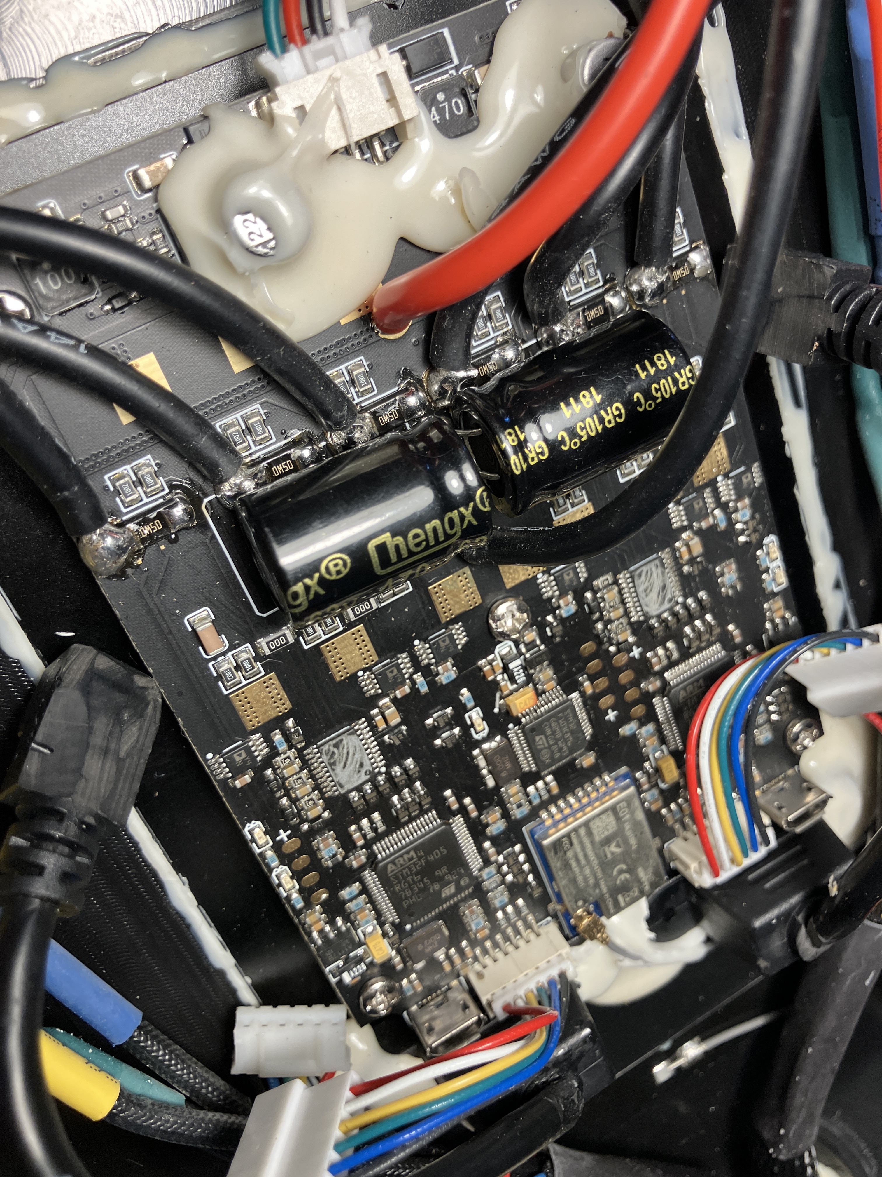

Hello,
I have something simular, I don’t have the remote (the previous owner lost it) so now I need to find a way to order the correct remote and pair it to this “vesc”
Did you find a solution?
Thank you!
17434395187533599729586973122402
I don’t know the exact process for this but isn’t there a little button on the remote pcb that needs pressed? Also a jumper or button on the vesc to enter pairing mode for the receiver?
Take some picks of what you have clearly showing as much detail as you can - im sure we can figure out something
Hello Pecos, I have made some close pictures of the print:
Im struggling to find any reference material on this thing, can you link where you found it as the old link is long dead? More pics showing the full layout top and bottom please.
Was this part of an old prebuilt or a diy? Any more references would be helpful here especially any marking on the pcb showing model or version number too.
Link the remote and some pics of it too. There just isn’t much i can find so far
That’s an odd ESC, never seen one like it.

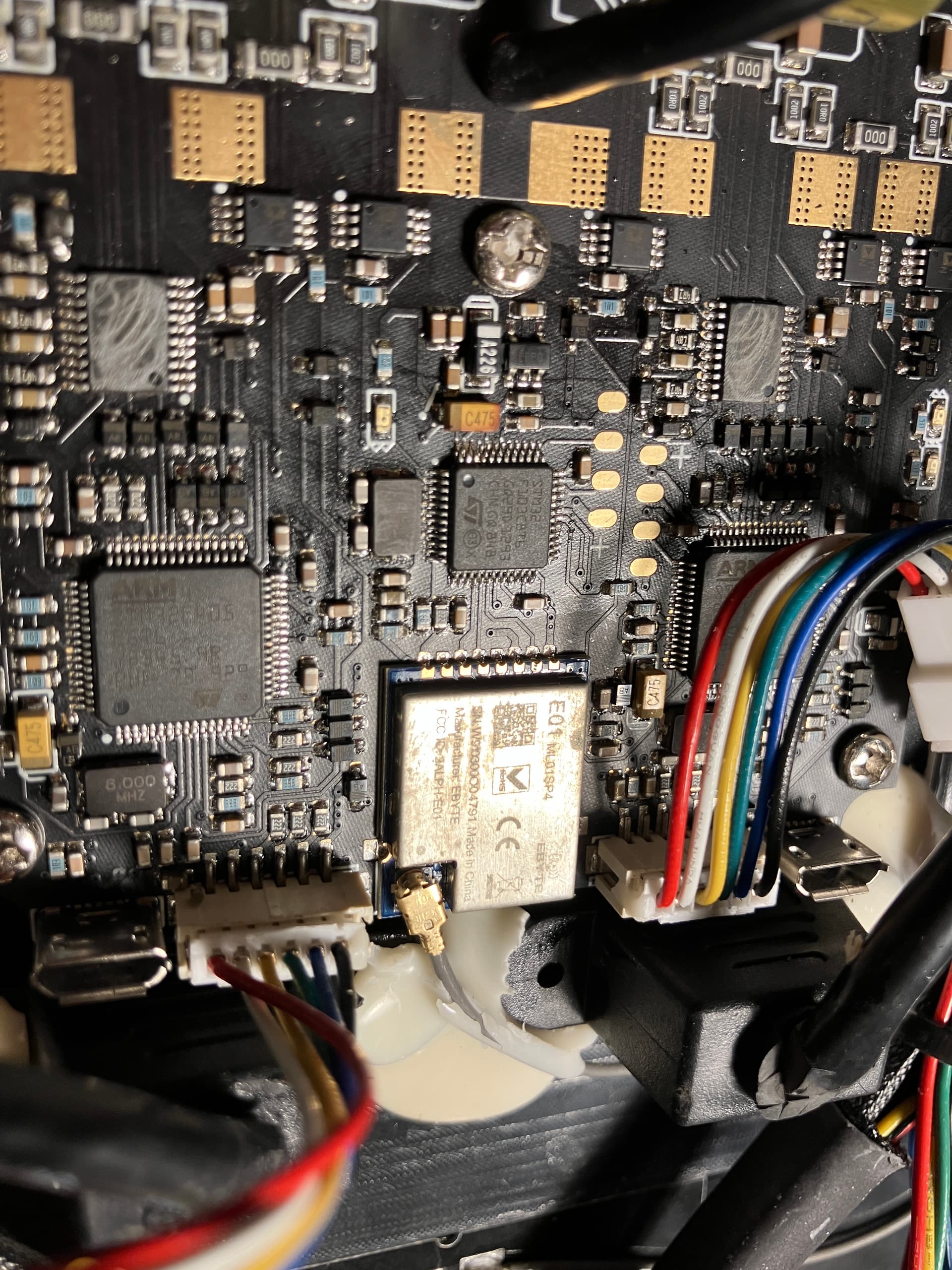

Hello,
Today I received the remote Flipsky vx1 just to test (if it won’t work I can send it back)
Put the remote in pairing mode, turned on the board, but it won’t pair.
I think I can try to pair it with different settings in the vesc tool, but I have not enough experience with the vesc tool at the moment.
