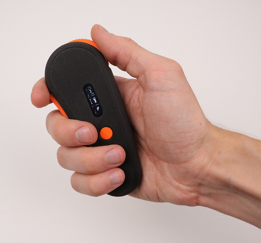

How much side to side play is in the wheel and how smooth intuitive is the movement that’s

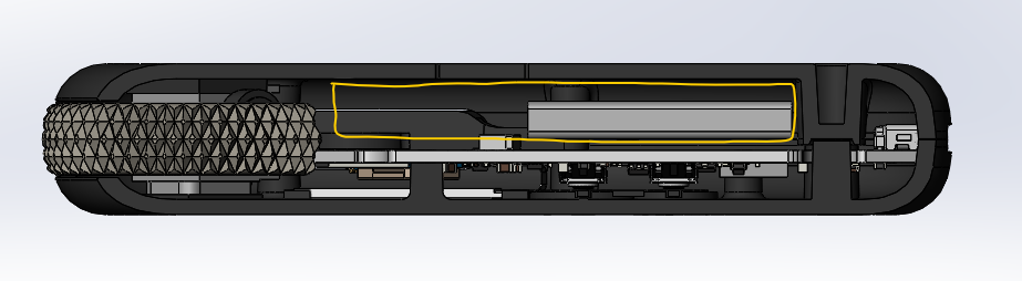

The side buttons position look slapped on the side because there’s were thay ended up on the PCB lay out not Ergonomically positioned same with the battry must be a lot of wasted space inside of you use a flat PCB board and just stick a battry on the side.
Rember you asked for feed back and thay are my initial conserns with out having one in hand I could be completely wrong. there is a lot of development in remotes happening that will soon be a highly competitive market.

That’s not entirely true. We positioned the display so that it would be always visible when using the remote. There was a limit to how far up we can push it due to the joystick / throttle. We positioned the buttons right below the display because they wouldn’t make sense to be above the display. Additionally, the buttons are positioned in a way, that if you would need to switch the dashboard to a different view while riding, you can do that with the middle finger. See this image:
Right now the battery you saw in the picture was just one that we had around. There’s lot’s of empty space right now in the battery side and we are planning to cram it with the largest battery we can fit there. The only component that’s slightly in the way is the OLED connector:
Hopefully I addressed most of them. It’s totally fair to be skeptical on a brand new project like this ;).
